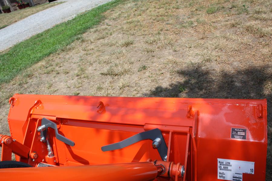

This works well for me, I only use the outside hooks to lift really light loads or string a chain between them and hook to the chain in the middle, I actually prefer this method for most lifts whether using the outside hooks or two inside ones.
I took the idea from others, so I can't claim any credit for it.

Thank you all for your helpful advise after seeing what has worked I think I have a pretty good plan at this point. TripleR I really appriciated the photo of your loader you went above a beyond the call. You guys on this forum are a great bunch I'm sure I'll be back as I customize my new tractor more too fit my needs .. Jef

You might want to look at Kens bolt on hooks (http://www.google.com/url?sa=t&rct=...=oTumaSrvxYzbfds3beHUYA&bvm=bv.51156542,d.dmg). I have read lots of great reviews for his products, and then you don't have to worry about messing up the paint on your new bucket, or getting it repainted after grinding and welding.
He also handles weld on hooks of good quality.

Snapdealer - not sure you caught my post in the attachment section, but this is what I ended up with and these are both Ken's Bolt on Clevis and Ken's Weld on Hooks.
