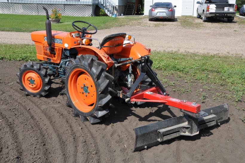

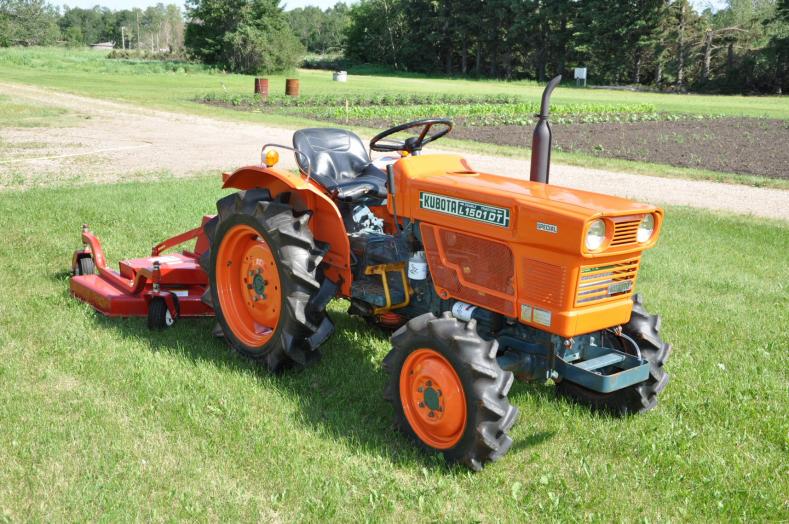

DSC_3415sml.jpg Hey Everyone!
New to the forum. I just got a new to me L1501DT with just barely 800hrs on it for $3995cdn. Hell of a deal and looks brand new. Nothing has been broken/damaged or tampered with or modified. Runs like a top but everything is in japanese, but i figured it out. Only one problem(hardly) with it, both brake, locked together or not, stick, and its not the pivot points or the mounting shaft, everything is free there, it is some where internal inside thouse housings just on the sides of the transmission case. I can push down either brake pedal and the brakes work great but i have to manually pull the brake pedal back. again i have disconnected the linkages right to point where they go inside the housings and everything is free. Its internal that they are sticking. I have no manuals yet. Any ideas? Thanks! Eric
