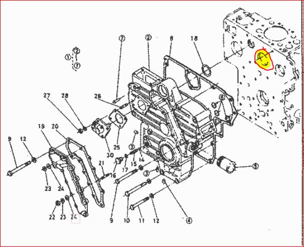

Another update, stuck the HF inspection camera in for a look, then a wire, to see if there was any resistance, when pressing against the freeze plug, the FP appears to be MIA. Can the FP be replaced by removing just the cover, that descends at a 45` angle towards the generator side of the motor? Looks like that cover is about at the right spot, to get to it...
32,912
8,376
Your going to have to pull the gear case cover to get to the freeze plug hole.
Here is the cover, freeze plug hole is marked in yellow.
