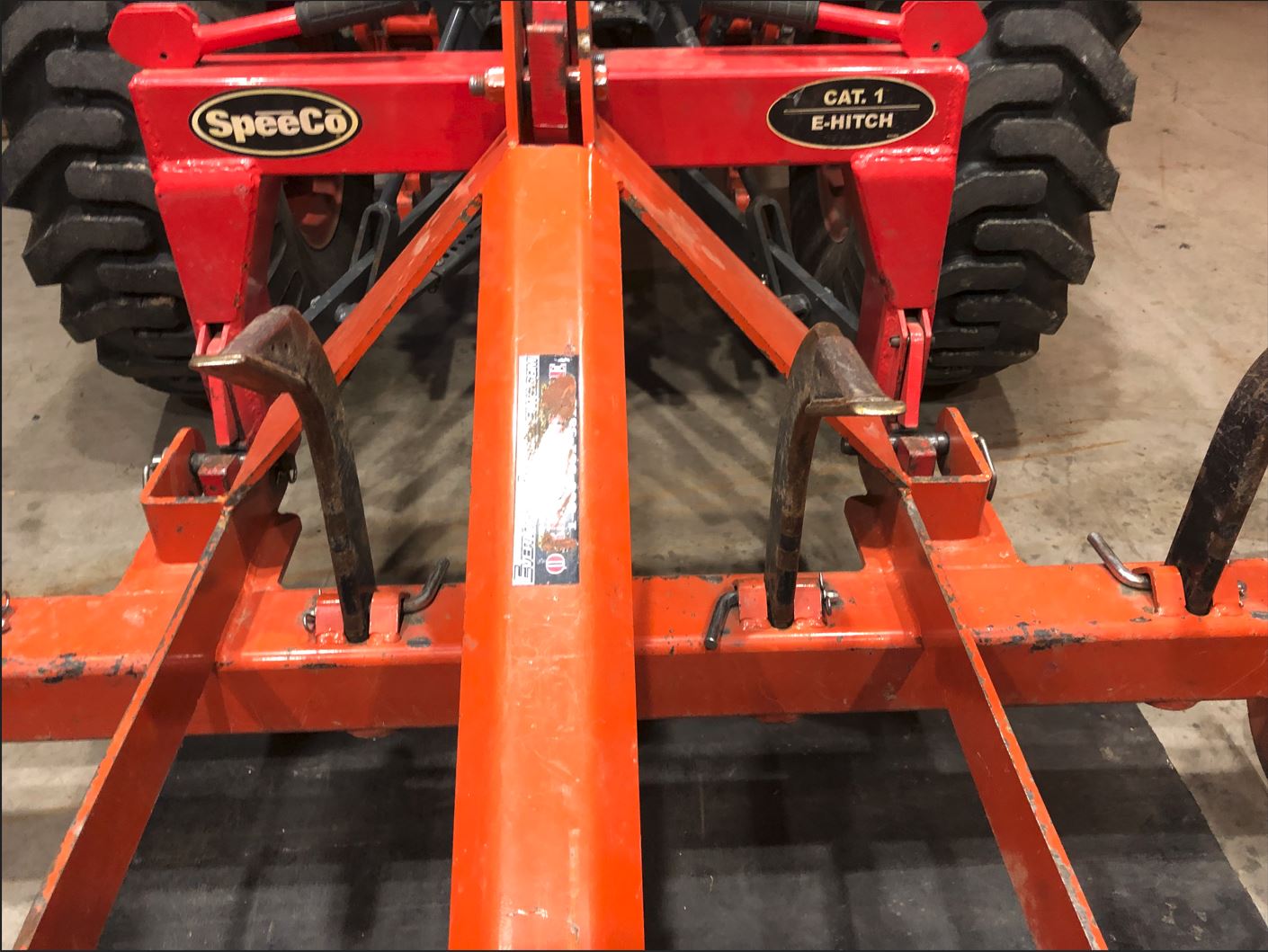

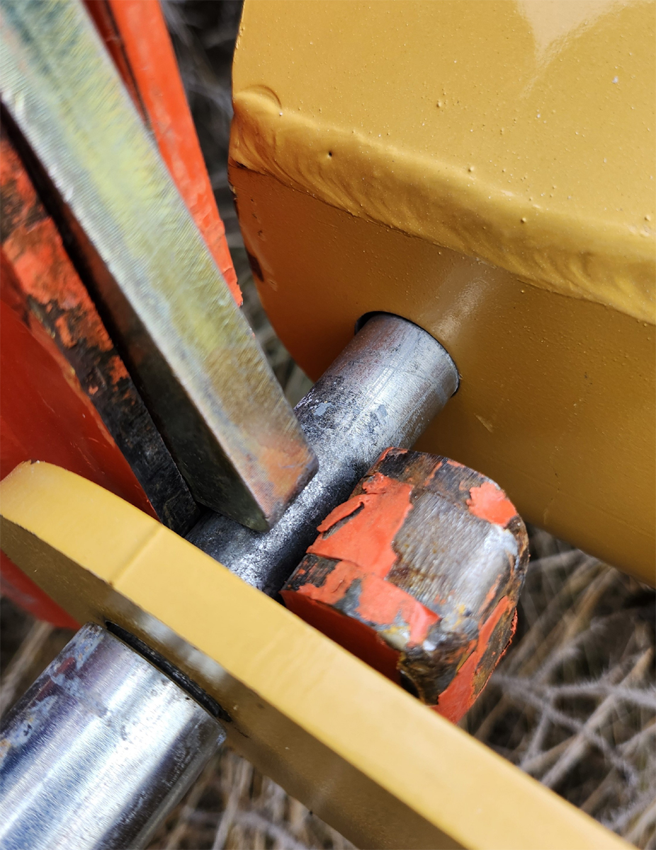

I have the speeco E hitch. Looks to be about 1/2" gap between the top of the pin and the lock. There's only about an 1/8" gap in the cradle. It's never given me a bit of trouble. 🤷‍♂️
That's not a huge gap compared to the GWTC variant, but there's no gap with the QH10 or QH15. It takes more design and manufacturing effort to have no gap, which equates to higher cost, and it's easier to not care about it and build in excessive clearance.
I think we can all agree that the idea of the locks is to prevent the implement from bouncing out of the quick hitch, and also to prevent excessive movement of the implement relative to the QH. If the SpeeCo works for you then that's great, but I prefer a lock that allows minimal bouncing of the implement during use.
How an implement is used, and under what conditions is different for everyone. I think that Land Pride/Kubota designs their implements in a way that makes them perform for the widest possible group of users. Other companies not so much.

It really wouldn't have cost them to design it properly. You just 'reverse engineer' or copy someone else's hitch. Fab one out of wood(easy to mod ) then 1 out of steel, confirm then tell computer to make a run of 10, OK ? make a run of 1,000.
In #43, you can see the SPEECO 'lock arm' has to 'arc' ,so the pivot point needs to be precisely placed.Any 'CAD' program in the past 4 decades could show the 'perfect point'....
Anything over 1/8" gap is too much.

Notice that I said design and manufacturing. In order to have a good fit between the lock and pin as the Land Pride QH does, the following features need to be controlled:
  1. The outer dimensions of the lock
  2. The location and size of the pivot pin hole in the lock
  3. The location and size of the pivot pin hole in the QH frame
  4. The size of the pivot pin
  5. The location of the implement pin in the QH
  6. Deformation due to welding
There's a lot going on with a significant tolerance stack up. The pin diameters whether CAT 1, 2 or 3 are well controlled based on the numerous pins I've measured, but it's much easier to not worry about a good fit between the lock and pin. This is one of the reasons why the QHs from GWTC and SpeeCo (to a lesser extent) are much cheaper. A monkey with a MIG welder could build the GWTC and SpeeCo QHs.
For example, if you send out a drawing to a vendor for the lock, the tolerances that you provide will directly impact the cost of the part. Extra QC, more scrap, slower cut or drill times etc., all add up to more cost.
