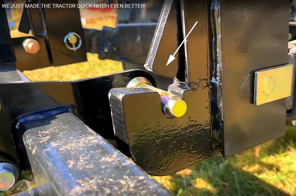

I watched Courtney's latest video yesterday featuring their updated Quick Hitch. I was surprised to see how much clearance there is between the pin and the locking catch. Courtney has repeatedly made the point that their QH doesn't require bushings and is made for CAT 1 pins (7/8") on the implement side. I just don't see this design controlling upward movement of the implement.
I've made some less than positive posts about Land Pride's QH15 which I have and which I consider to be a screw up on Land Pride and/or Kubota's part. I also have a QH10 which works very well, and the new QH16 is what the QH15 should have been. All that said, look at the fit between the CAT 3 pin (represented by a bushing) and the locking catch on the QH15. This is how it should be where the catch limits upward movement of the pin and therefore implement. I don't think that GWTC thought this through, but perhaps I'm missing something here.

Yea, I wouldn't want that much slop on the three point.

If that's a production model, that seems like a bad design.

At a glance in that pic it looks like that pin might be able to bounce/wiggle out…I’m not saying that it would but at a glance it looks like it would not take much.
After it smacks it a few times anything is possible!

That IS a lot of gap there! Wow.
Imagine that with the added weight holding brackets he sells that puts down pressure on the hitch itself vs the implement directly.
Not sure I agree with the "no top link bushings needed" theory either.

If ( IF ) the top link IS CAT1, then no bushing should be needed to attach a CAT1 implement to the CAT1 hitch...... that is a big 'IF' of course.
Agree a LOT of 'gap' ! Maybe someone used a Metric tape measure when they cut out the Imperial pieces ??
before buying, I hope someone calls and ask about the gap. No way it'd be safe to use as shown.

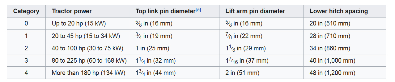

You're absolutely right about the QH16 but your observation can be extended to the QH10 and QH15. The width of those QHs where they connect to the implement (lower hitch spacing) is centered around 28" which is CAT 1, whereas CAT 2 uses a 34" spacing. So I connect to all of the QH compatible implements using the CAT 1 interface/spacing on the implement. I hope that makes sense.

I don’t have a quick hitch so please pardon my possibly blatant ignorance of this question I’ve had for some time.
Cat 0, 1, 2, etc. are differentiated by both spacing of attachment points and pin size (as detailed in @mcmxi post above). There seems to be a significant volume of demand for quick hitches for Cat 1 and Cat 2 tractors. So why is it most of the quick hitches I’ve ever seen or considered buying have Cat 1 spacing (which matches my tractor’s Cat 1 hitch and my Cat 1 implements), yet they use Cat 2 pin sizing and require spacers plus many require modifications of the top link hook?
Is there a reason that it isn’t industry standard to have a Cat 1 quick hitch that is Cat 1 in every spec, Cat 2 quick hitch that is Cat 2 in every spec, etc.?
Excellent questions for sure. I have implements that have pins that are both CAT 1 and CAT2, but as you point out, most QHs from Kubota/Land Pride or similar use CAT 1 spacing. So if I want to connect to the implement using the CAT 2 pins I would have to remove the QH.
Like many industries, folks didn't sit around a table and get it all figured out at the beginning, so what we end up with is a mess of mismatched products, and often, little thought is put in to how a broad spectrum of people actually use things.

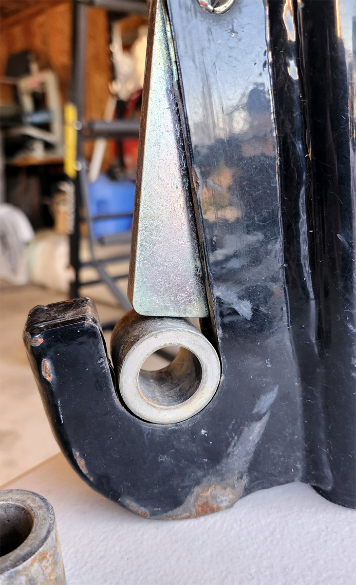

So here's a photo of my QH10 with a 7/8" pin held in place by the lock. I like Courtney and GWTC but I sure as heck wouldn't buy their latest and greatest QH. :cautious: I sent Courtney an email and included the three photos from this forum, and hopefully he gets this corrected.
yes, 'profit margin'. If you look at most CAT1 quick hitches, the mfrs use the same 'lower end' casting for their QH versions cat1, cat 2 and cat 3 . If (IF ) you're lucky ,they'll supply the NEEDED reducing bushings to make it FIT Cat1. Then there's the 'width' issue . As pointed out Cat2 spacing is wider than Cat1, so mfrs need MORE design/mfg/inventory.
I think Speeco (?) is the only one that makes a true CAT1 QH , IE: Cat1 on tractor side AND Cat1 on implement side
The not-so-simple answer is that the ASAE ASAE Category 1 Standard S278.6 for quick-attach hitches calls for CAT3 sized hooks on the upper and lower hooks.
ASAE Standard Quick Hitch
The American Society of Agricultural Engineers has developed a series of standards for U-shaped quick hitches (Figure 1). There are ASAE standard quick hitches for compact utility tractors (Category 1) as well as farm tractors (Categories 2-4). ASAE standard quick hitches are designed to mate up with the three existing hitch pins on the implement, thus you have to buy only the tractor portion of the hitch; no additional parts are needed on the implement. This system works great as long as the implements conform to the ASAE standard.
Unfortunately, most implements for compact utility tractors are made by short-line implement manufacturers that completely ignore the ASAE hitch standards. This means that an ASAE standard quick hitch will not work with most small implements. You can sometimes remedy the problem with a welder and cutting torch, but most folks don’t want to rebuild their implements.
Showed up in my queue so I watched and thought the exact same thing.

figures... it took a committee to wreck a well known system, the 3 point hitch, into THEIR idea of what it should be. Obviously not one real farmer on the committee.
There is no good reason for CAT3 ends on a CAT1 hitch.
