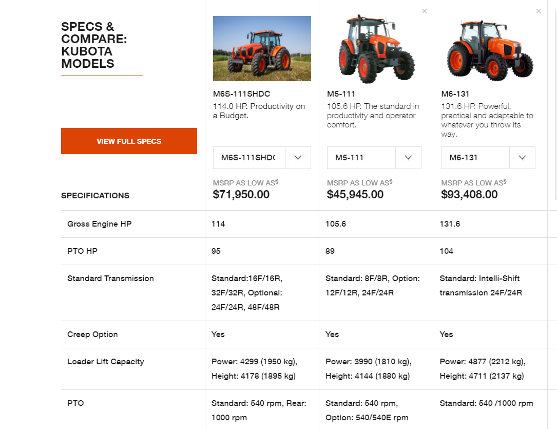

According to the Kubota spec sheet, the M5-111 is 89 PTO HP. I don’t have any experience with either models you are looking at, however I do have a lot of experience with a John Deere 6410 which is basically the same tractor as a 6405. That 6410 was an underperforming tractor. Running out of power when working hard, running hot unless you were careful. I think that you would have more tractor with the Kubota of the same size. It’s too bad that Kubota doesn’t make an economy version of the M6 without some of the bells and whistles, keeping the price down.

What about the M6S-111
The M6S-111 are value-minded, economy utility tractors built with the small farmer/rancher, property maintenance professional and municipalities in mind. Packed with Kubota quality horsepower and deluxe tractor features, the M6S-111 adds productivity and efficiency to any operation on a budget.

M5-111 looks like much better buying than the M6S-111. Giving up 8HP to save 35% looks like a good deal to me.
