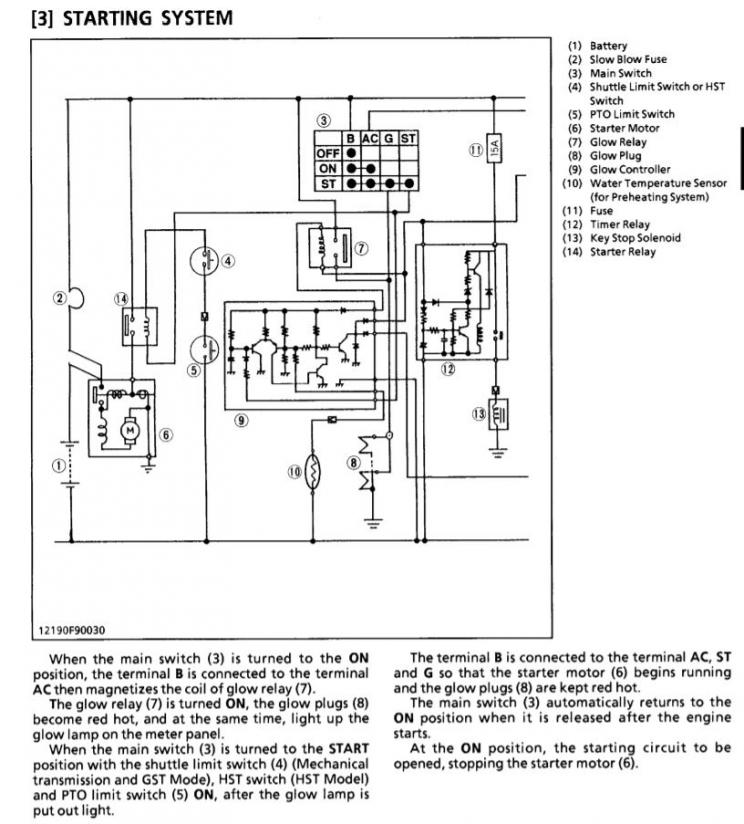

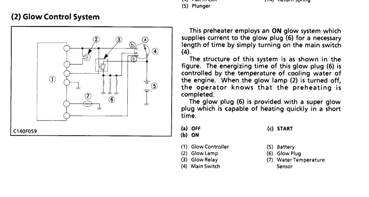

Here is a wiring diagram - see if this helps:
