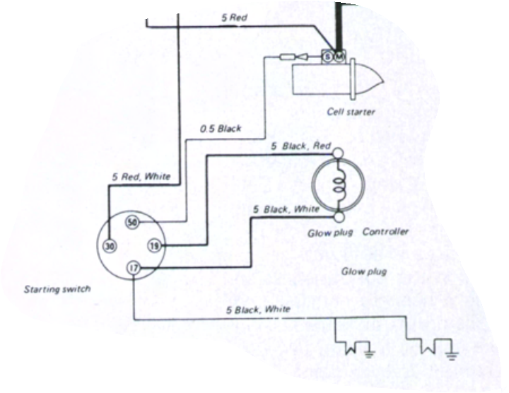

here is the diagram from the switch to the controller and plugs

Thank you. I have that, already, in the service manual. The service manual doesn't say what the circuitry is INSIDE the switch. I'm going to be replacing the one switch with two momentary on switches. Of course, I COULD test the present circuit, but the switch has become unreliable. Age.

The coil serves as a voltage dropping resistor as well as an indicator. It is wired in series with the plugs and the plugs themselves are wired in parallel with each other. The idea is to drop the twelve volt supply to the 10.5 volts the flow plugs want to see. On my Mitsubishi D2350 I used one fifty amp momentary contact toggle switch to power the glow plugs. As I recall you want to figure ten amps per glow plug. I did have some problem with corrosion on the coil. That will prevent any current flow and of course the resultant open circuit prevents the glow plugs from heating.

I know I have seen a "logic diagram" for that keyswitch somewhere. (it may be on the schematic somewhere)
As I recall, there are two 'modes' of operation.
  1. The 'glow indicator' is in series with the glowplugs
    • +12 is connected to #19 on diagram above
    • #30 jumpers to #19
  2. The glowplugs receive full battery power.
    • +12 is connected to #17 on diagram above
    • #30 jumpers to #17
Ask yourself this question:
"Would #17 even exist if there was no need for the switch to send full +12 to the GPs?"
I work on all manor of equipment several times a week and often have to make my own schematic diagram using ohmmeter.
I have been known to REMOVE keyswitches and use ohmmeter to make my own logic-diagram for them so I can understand operation.
Perhaps, you might consider doing the same. There are only 4 pins on the keyswitch... how complicated can it be?

I would reccomend the glow coil be replaced with an indicator lamp, and a heavy duty relay be installed,
in these older Kubota, it is NOT a good idea to feed full 12v to the GPs for very long. That indicator (see ckt above) is INTENDED to drop the voltage to the GPs as it heats up and begins to glow. (more heat = higher resistance)
The voltage to the GPs may start around 11v. Then, the nichrome wire in the indicator begins to heat up and glow...this drops the voltage to the GPs down below 8v.

No problem... perhaps I did not explain well enough.
Firstly: You need to understand the physical principal that resistance goes UP with heat.
The GP indicator is a loop of nichrome wire (same metal used as filament in light-bulbs).
With that said, when you initially hit the power to GPs thru that nichrome wire indicator, the GPs see FULL battery voltage for a moment.
Then, as the GP indicator (nichrome wire) begins to heat, its resistance slowly climbs. As this resistance goes up, the voltage at the GPs goes DOWN.
This is a self-regulating circuit which allows the GPs to heat quickly... but at the same time protect the GPs from burning up. The longer you hold the GPs "on".... the lower their voltage gets until the nichrome wire equalizes its resistance.
Keep in mind this is how things were done LONG before there were computer-controlled components. Using basic, physicial properties of nichrome wire, a self-regulating, robust circuit is used.
