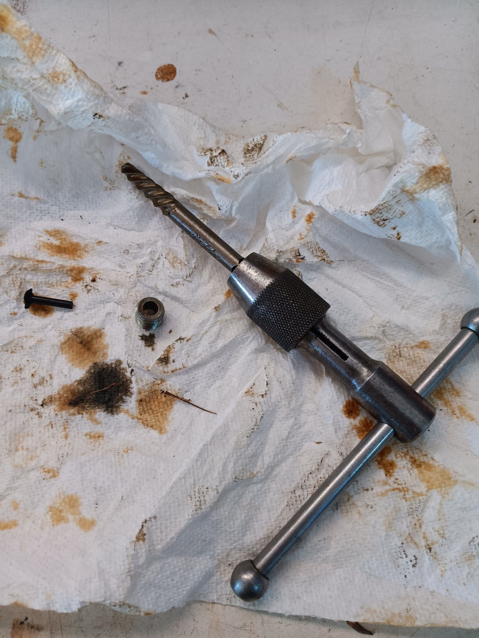

My son was changing the oil in his BMW X3 today and as he was removing the drain plug the shank snapped off just below the head. When I went to help I noticed the shank was hollow and there was a pronounced undercut just below the head. I thought that was really bizarrre until after I removed the broken off stub and gave it some thought. Its actually very clever. engineering. Anybody else see why?

I presume the undercut allowed the head to separate to reveal the hollow threaded portion, and that allowed you to use an EZ Out without any drilling.

I’m having trouble visualizing from the two pieces sitting on the white paper what actually broke from what. It’s obvious that the threaded plug accepted the easy out to get it out. But the other piece doesn’t look like it offers much for something to grab onto it.
The hex head is not pictured and the plastic pin has nothing to do with the plug.
Give it some more thought.
HINT - There have been two recent threads on OTT dealing with oil pan plug failures on the highly regarded Kubota engineered tractors.

My son said there was almost no resistance when he loosened it.
My guess is the plug was overtightened to the verge of breaking during the last oil change.

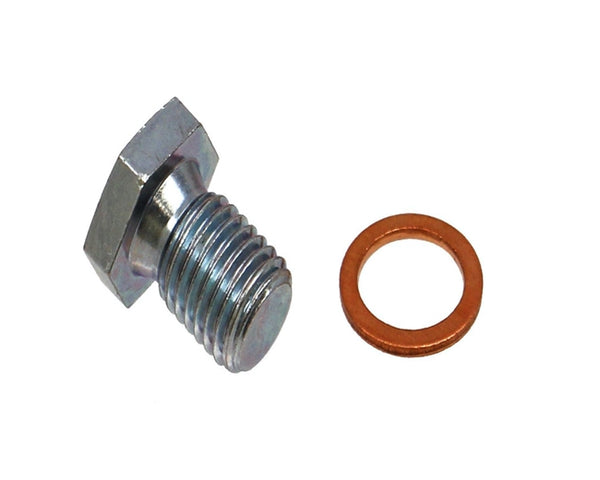

I hate to burst all of the happy bubbles, but the hole is designed for a magnet, not stress relief.

depending on the year BMW and many others like my range rover use single use / disposable and torque limiting oil drain pan plugs.

Well I still can’t visualize the initial situation, but you used the easy out to remove the plug. How is that different than just removing the plug if it didn’t have that undercut and nothing broke to begin with?
I guess you could be feeling that the design is such that the plug should break off if it is over torqued before the threads in the oil pan are damaged, but that obviously didn’t happen in this case… And possibly set up a catastrophic event if the plug head had fallen off after the fact, unless the electronics is smart enough to shut the engine down if the operator doesn’t notice what’s going on.
Perhaps your son turned the plug the wrong way and broke it off and doesn’t want to admit it…LOL In that case I totally see how your evaluation makes sense. IF I am envisioning the situation correctly without seeing all the broken parts.
I am not sure what the question is.
I believe the plug was compromised (partially fractured) by overtightening it on the previous oil change. The male and female threads were not damaged or seized and the remnant was easily removed with an EZ out and tap handle. Not even finger tight. Why is it also hollow?? Who knows.

I'll agree the undercut is possibly a stress relief or just a place for the sealing washer to expand into???
But the hole is for a magnet that they have left out because it's of little use, it's a left over design from years past.
