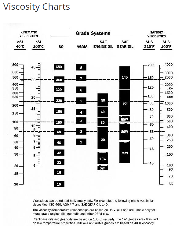

I know very little about oils but everything that I can find on the internet indicate that AGMA 5 and ISO 220 refer to a 90W gear oil.
Look closely at that chsrt. It says based on a VI of 100. It does not apply to synthetics or multigrades. A synthetic multigrade has a VI around 150. Throw that chart in the trash can and ask Google for the data sheet for ANY synthetic SAE 80W90. Use the KV40 value in that datasheet for determoning the correct ISO or AGMA equivalence.

Well clearly your eyes are better than mine. I finally realized you were typing 5EP not SEP. So my apologies - an AGMA 5 gear oil is equivalent to a ISO 220 viscosity.
But its also nowhere close to a multigrade SAE 80W90 which is a ISO 120 grade oil.
Those two specifications are very substantially at odds with each other.
I did look at the datasheets for some of the name brand AGMA 5 industrial oils and they have a VI in the 170 range and KV100 in the low to mid 30s. That makes them an SAE xxW140 or in some cases SAE xxW190 multigrade oil.
You can chase the AGMA 5 rabbit down its hole if you want but personally I would never put a heavy oil like that in a snowblower. All its going to do is suck up HP and empty your wallet
