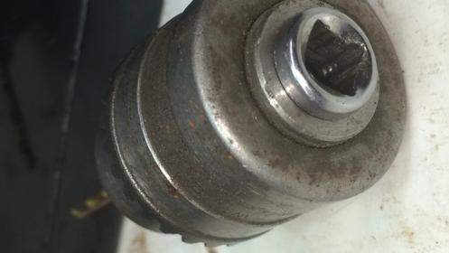

I modified a chuck to fit my 1/4" air ratchet. image.jpg its shorter than most angle drills. Was a 1/4 " extension i threaded in my lathe. Super slick.
