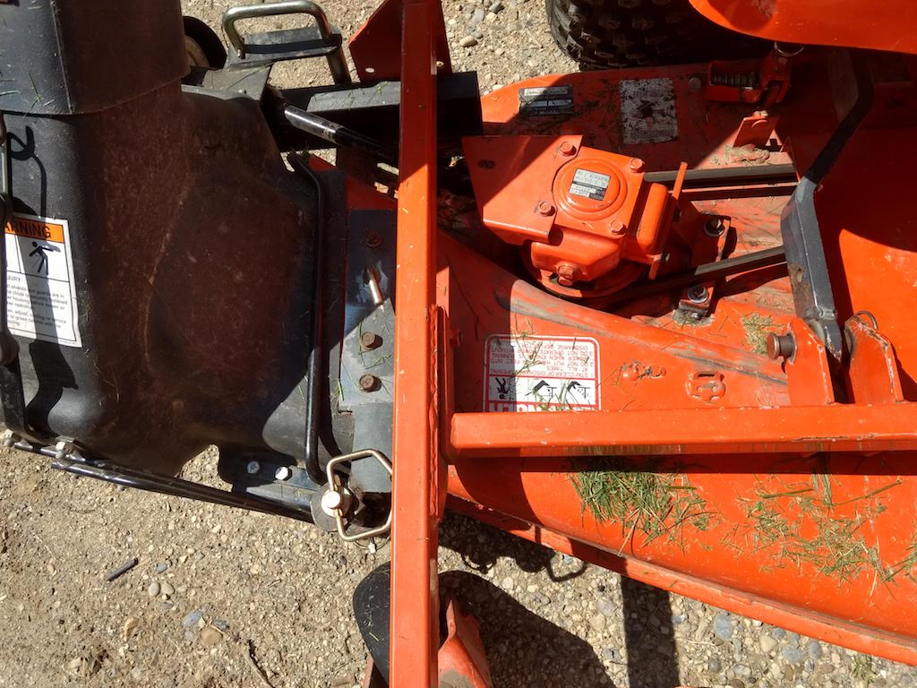

Anyway, on the local buy&sell, I found a GC54-24B grass catcher from a belly-mount mower on a B2320. The guy only wanted $250 for it so I went for it.
First problem I encountered is that, because the GC54 has a driveshaft that connects to a gearbox on the far right spindle of the deck, I needed the gearbox. Fortunately, the seller was happy to include the gearbox in the deal since he didn't need it anymore. That was good news because Kubota wants $1400 for the gearbox alone. Have I mentioned how predatory Kubota is?
My mower is a GF1800 with a front-mount deck so I had to fab some bracketry out of scrap that I had laying around in order to mount the blower unit. An afternoon of noise-making and I had some basic bracketry that held the blower. It went surprisingly well.
For the bags I had already previously made a mount for my older double-bag setup so I decided to just use that for the time being. The 3pt hitch mount of the triple bag setup that came with the GC54 was going to take some more thinking so I went with what I already had mocked up. I just need to extend the chute because it's not quite long enough to reach.
Hope this helps someone. I'm pleased with how well it works to be honest. Though the double-bags sure do fill up fast.
