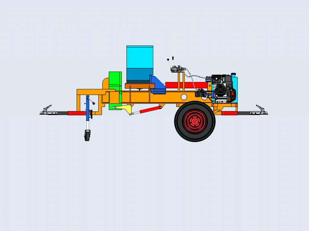

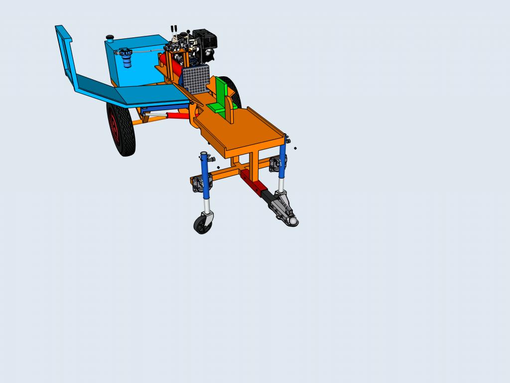

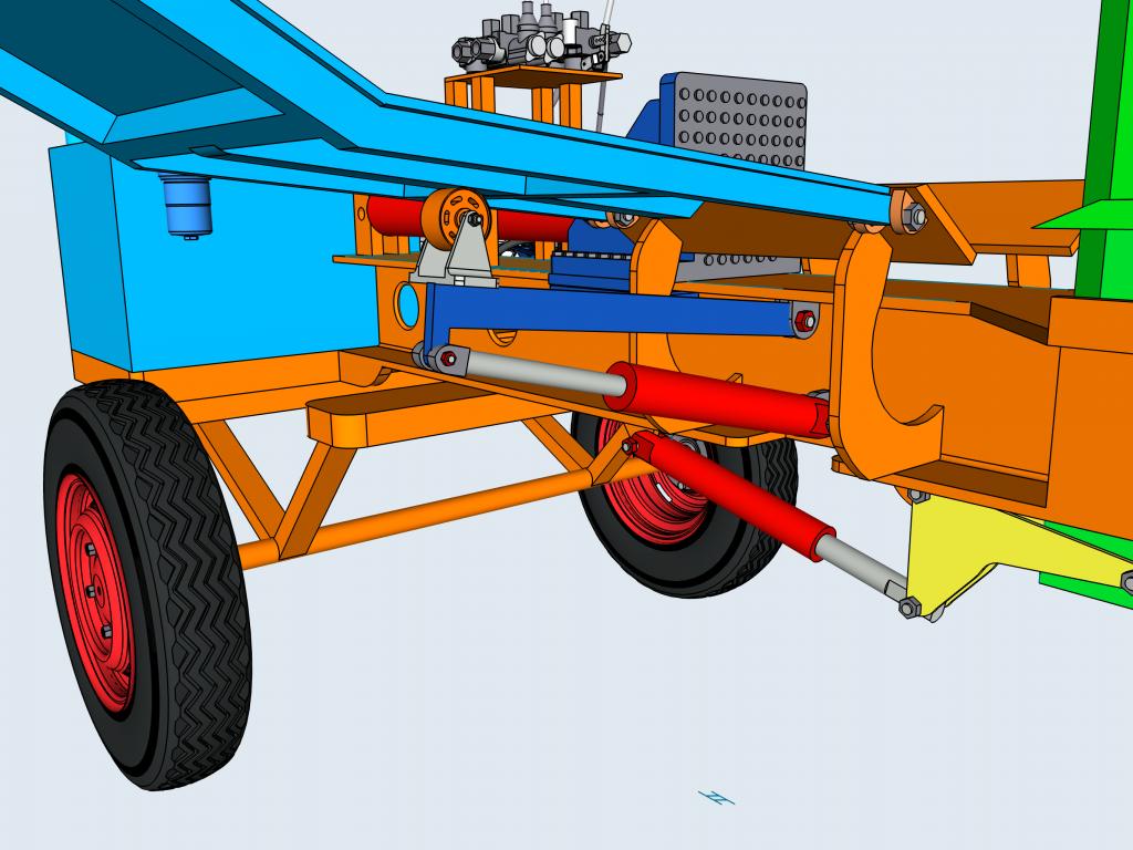

Well
After reading and shopping for a long time I decided to build my own, I have designed it, see attached pics. Inputs are welcome.
I am wondering what you used to draw the splitter?
With the engine and oil tank behind the axle will there be enough weight on the tongue to tow it at hwy speed. If it is for tractor towing only it looks good.
Fluke631
B2650
Oct 29, 2019
70
I use Shapr3D on ipad pro with ipad pencil. I've used it on a bunch of projects, saves me time and metal. It's all built to scale and for the motor I imported CAD drawing that I found online. Neat little program.
For the axle, I have looked at it but with all the metal up from I figured it wouldnt be a problem.... I'll calculate it, does anyone know the percentage of the weight I need ratio for fwd and aft of axle to be highway towable?

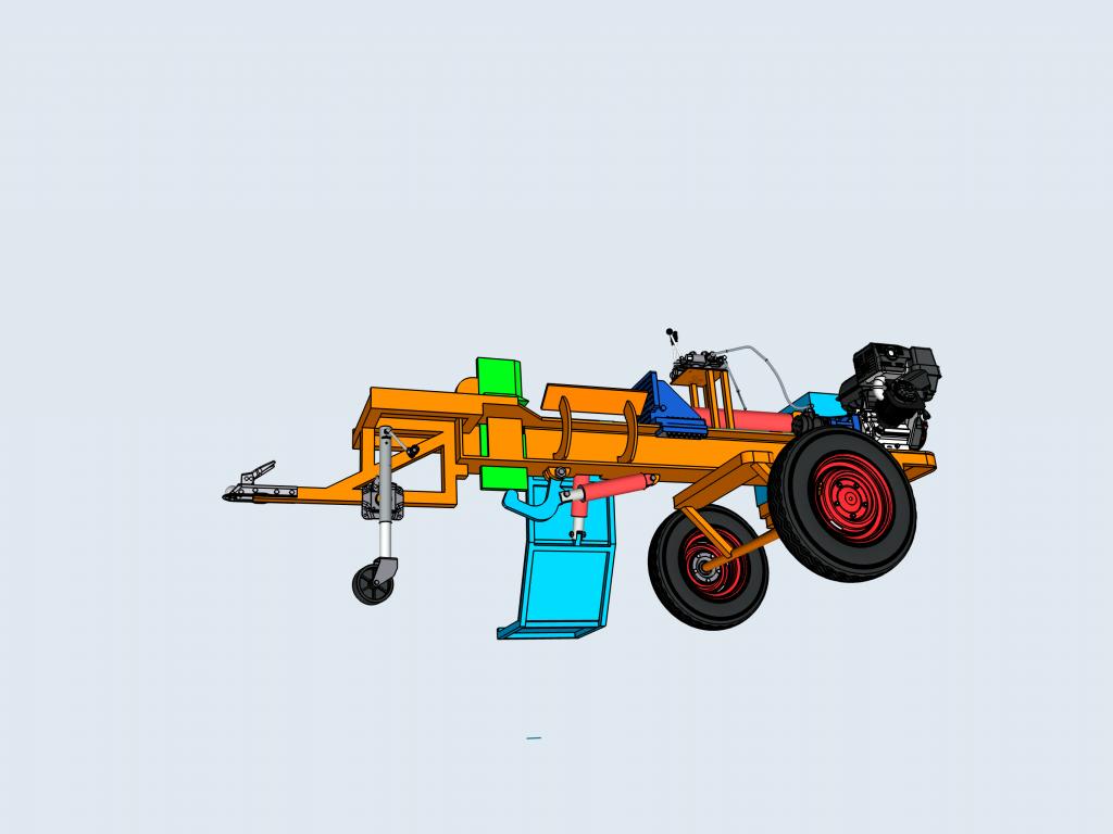

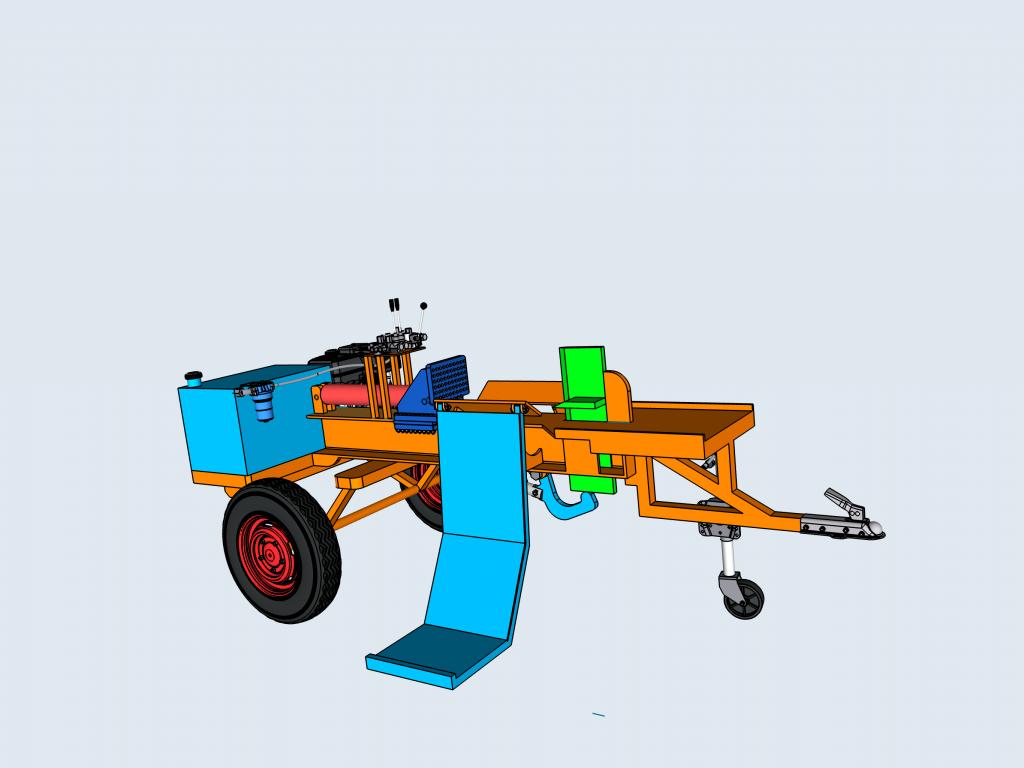

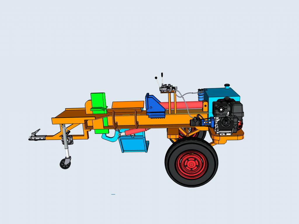

Well
Make sure you have an adequate "work table-Table grate" its a must or you pick stuff up off the ground all day long. I won't run my TW6 without it. Negates almost all the efficiencies of the design. Also see if you can design the 4way to go "Flush" with I beam. there are plenty of times I get real large knotty crap that needs to be split with just the 2 way. I have to physically remove a 50lb 4 way and its awkward at best. Pretty neat design. also Prince valves are pricey but worth it from https://www.surpluscenter.com/Hydra...g-Splitter-Valve-w-Power-Beyond-9-6587-PB.axd
I like the auto return feature. I split about 80cords a year and its worth the $
Fluke631
B2650
Oct 29, 2019
70
Thanks, I modified the design a bit as you can see in the pic attach the wedge 4 way will go against the H beam so shouldn't be a problem, thank for the input, I also added a floating log lifter, and a removable towing bar that I can put in the rear as well.
