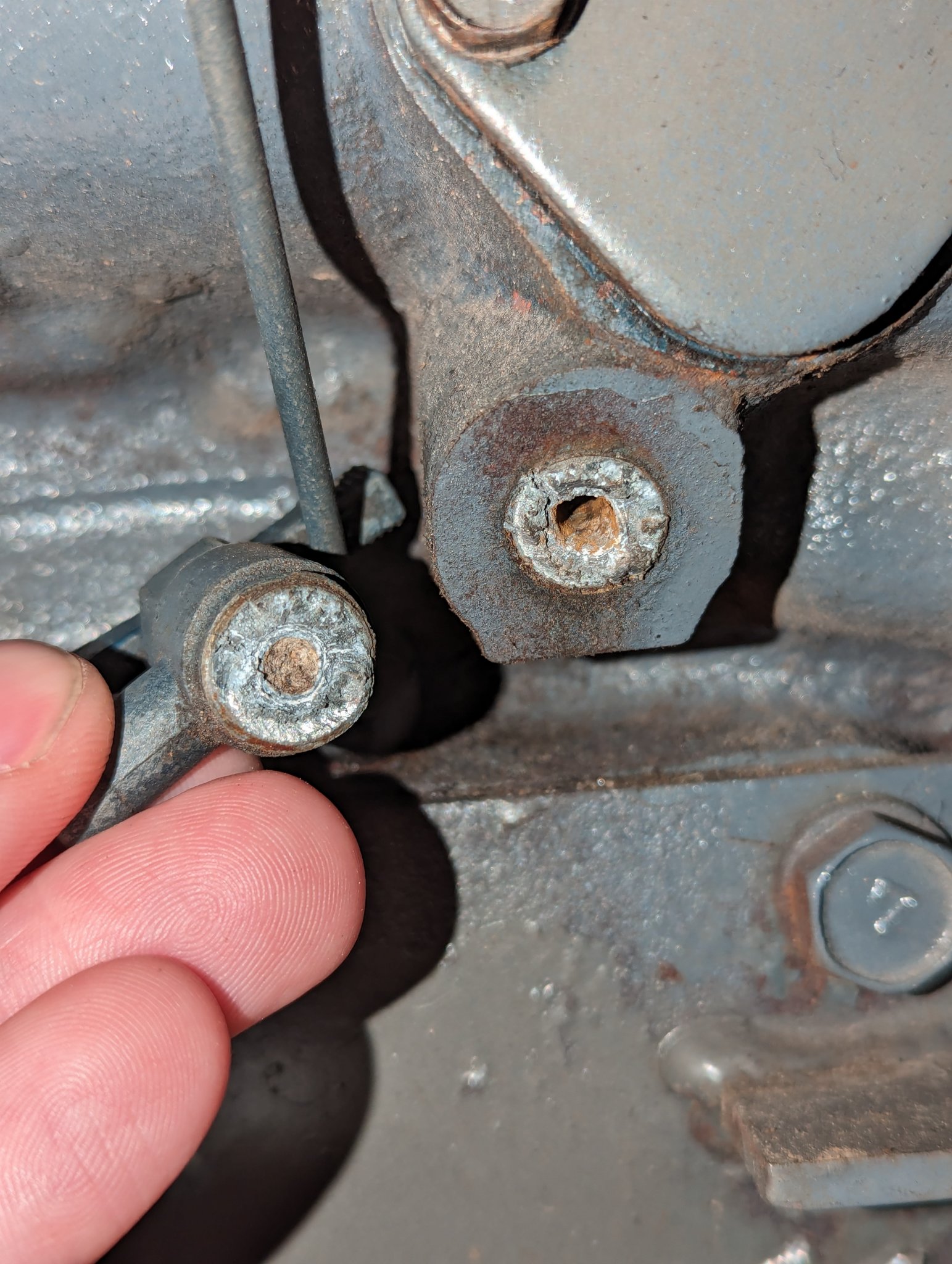

Hi Everyone,
Largely thanks to this forum I bought an early 90s G5200 that was supposedly restored. Unfortunately she overheats and as I started digging into the laundry list of potential causes, I've found that the coolant stop cock on the block is completely clogged with scale/gunk (I know because I tried to remove the 'bolt' and it immediately broke off). Tried slowly drilling out the hole with a small drillbit but didn't want to go too deep in fear of drilling into something I shouldn't be. No coolant came out.
So my question is, how can I clear out the flow channels (if that's what they're called) to at least flush the block? I am pretty sure the water pump is leaking so I was going to remove that next but I don't know what the coolant channels look like inside the block and whether I'll have any hope of unclogging them?

Very unlikely that the block is clogged up, it very likely that the drain valve was clogged.
you going to have to get the broken valve out of the block, and replace it
Do not drill it it's hollow and it's just sediment, if you drill into the cylinder wall behind it the motor will be junk.

Thanks for responding. Any tips on getting the valve out of the block? I'll get a photo in the morning if that helps.

Too bad you did not ask BEFORE breaking it off....we could have talked you through the procedure.

It is VERY common for the block-drain to be clogged like that.
  1. Use small drill-bit BETWEEN YOUR FINGERS to gently ream out the drain.
  2. Then, move to larger drill-bit BETWEEN YOUR FINGERS to gently ream out the drain.
  3. If, at any point anything comes out besides crud. (like metal shavings) STOP
At some point, the coolant in the block will drain out.
...now you have the problem of plugging the hole now.

Broke mine as well. The drain is made if really soft metal that eventually seems to rot away from the inside out. Small drill bits twisting by hand to clean or a small bore brush in a drill. Take it easy. There was enough material left from the old drain to tap some threads in it and install a bolt to plug the hole.

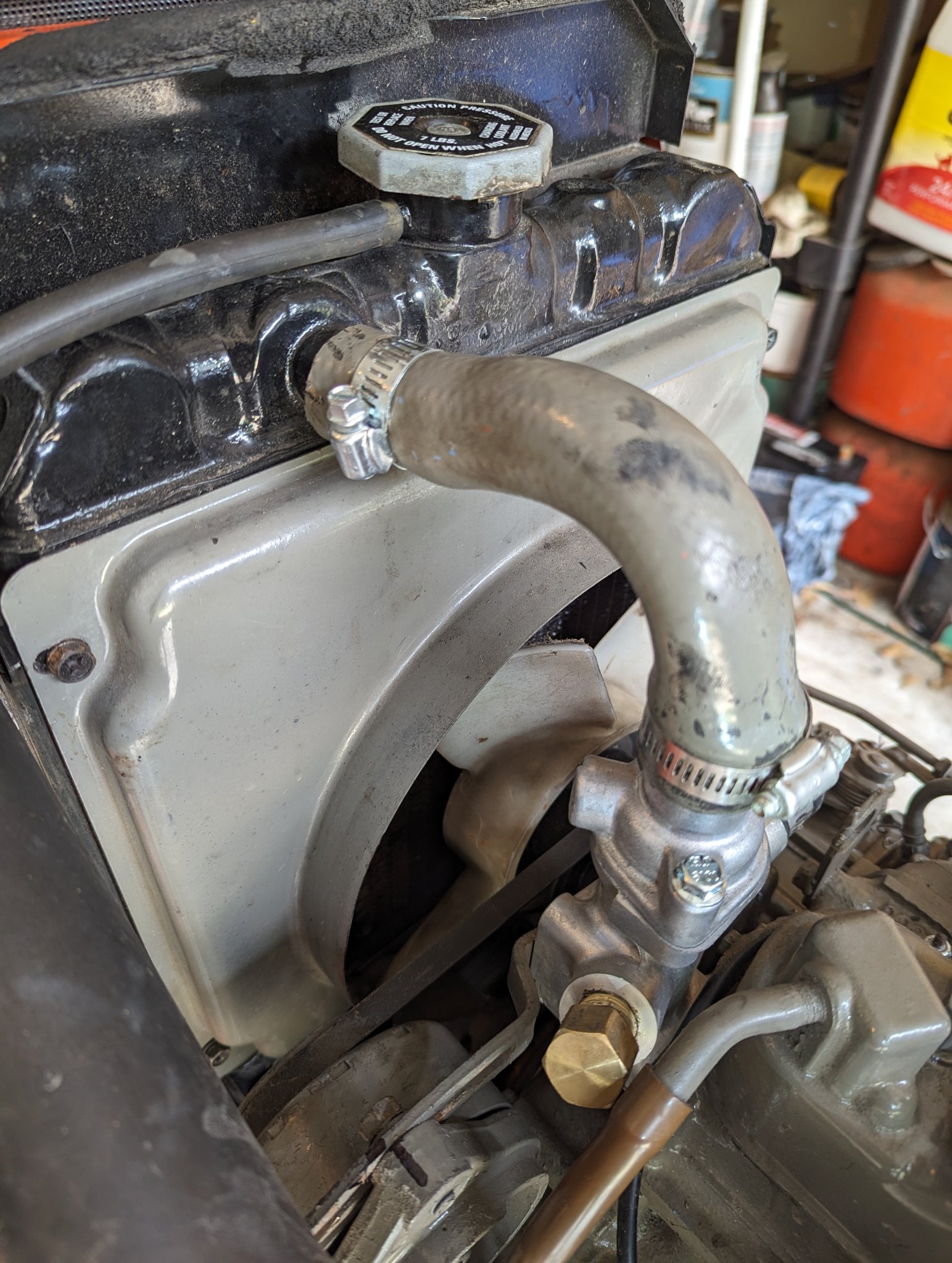

Ran at low rpm for 10 min. w/distilled water. Upper radiator hose 140F, lower hose 118F.
My radiator cap says 7psi. Is that correct?
Attaching some photos. PO put what appears to be a non-oem thermostat housing on there.
All screens are clean and airflow coming into the "air box" near battery is 100F (hot day in Texas). Is the battery too big/too close to the radiator? It's probably at least 1-2" away.
When it cools down enough I'll drain the distilled water and maybe flush radiator with the hose, then do some more distilled water flushes.
Drain on block still clogged. I'd really like to flush out the block if I can.

Battery is way to close. Tie that thing back centered to the steering column. Overheat central right there!
Fix that drain before it magically opens itself up. Hey, things happen!
Those temp. readings suggest the radiator is dumping some heat into the air.
The ENTIRE machine is metric.... I would not expect PSI to be on the factory cap.
Factory cap says 0.9 Bar on it which converts to 13.0534 PSI
Kubota P/N for radiator cap = 15272-72020
That battery is WAYYY larger than mine.... and blocking a large portion of the radiator-intake
I would not mess with it.... popping the lower hose does the same thing.

Thanks everyone for the feedback. I ordered the correct radiator cap and plan to do some flushing of the radiator and block tonight.
Re: the Battery. What smaller battery do y'all use? The one in there seems to fit the bottom bracket and I have read about folks re-locating the battery to the front or back of the tractor.

UPDATE: to see if the water pump had failed, I temporarily replaced the upper radiator hose with a clear one and removed the thermostat. The coolant was NOT flowing. Does this mean the water pump is bad OR will coolant not flow right away after start up? I left it idling a minute or two and NO flow...
34,352
9,586
Dead water pump!
