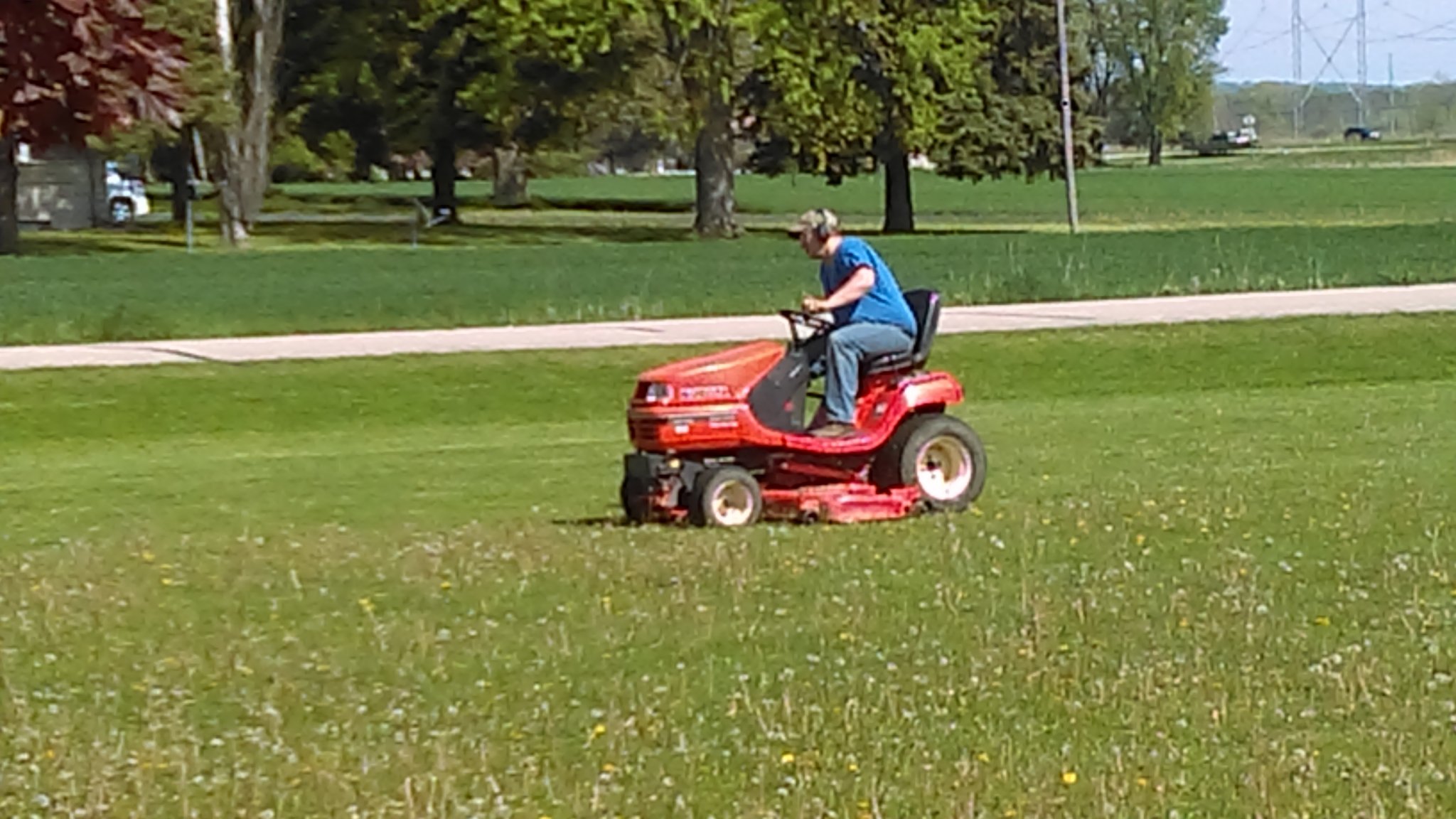

set of needle thrust washer bearing under the spindles at the axle, new wheel bearings, steers like a dream. just enough room for the snap ring on the right hand side and get the new steer arm on top on the left.
