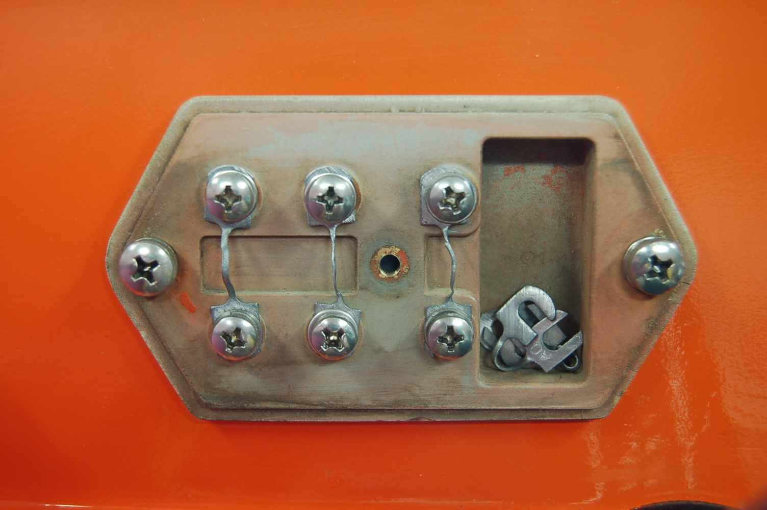

These are the correct fuses for a L1500/L1500DT
AKA, L175, L225, L225DT
I only show a P/N for the 5A;
34150-33620 FUSE 5A
The larger is a 10A fuse

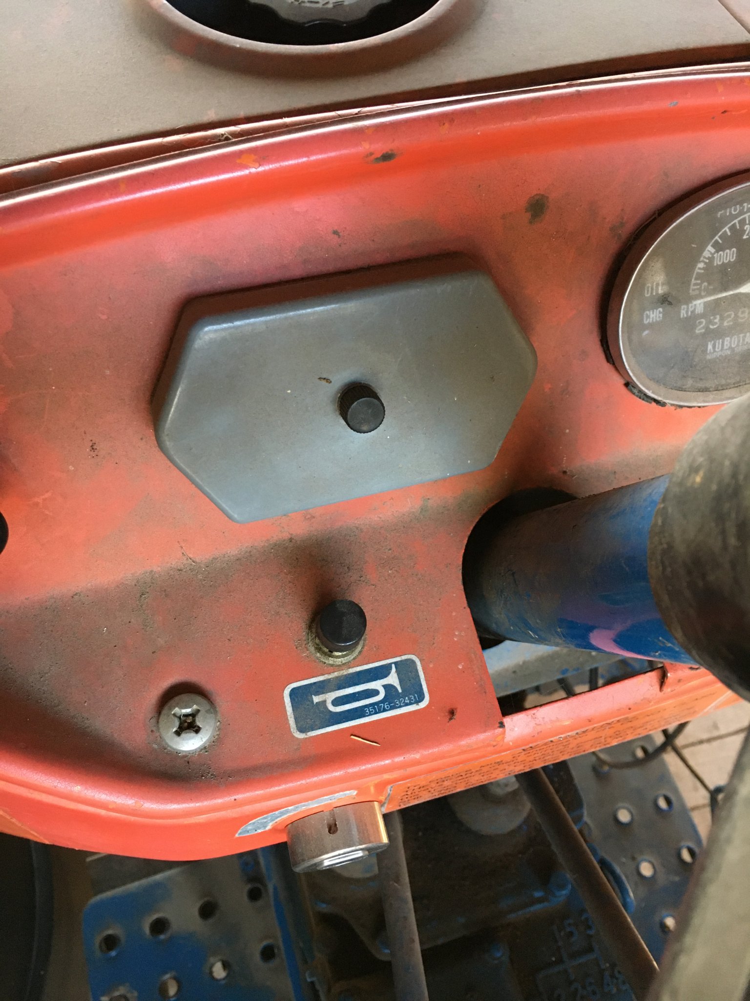

This is the correct cover,

Here is the one on my L185 that has the newer style fuses
part number 37150-33600 about $50 for the cover and fuse holder both
