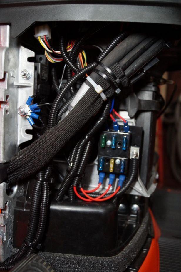

If my region ever thaws out, I'm going to be putting some auxiliary lights on my Grand L.
I've seen various threads about lighting, and at least skimmed all of them. I snagged various links to the lights, etc. I've sorted through them, and think I've narrowed down the lights for me (mmmmm, 2000 lumens).
Anyway, people generically talk about fuse blocks but rarely (if ever?) link to specific ones. I'd like to find a block with an input relay, and obviously fused outputs. I won't pay $80+, like I see some of them. That's just nuts. My amazon searches just aren't showing me anything that I really like.
Honestly, I'm planning on running 4 27W LED lights, which converts to 9A. There is the auxiliary power tap under the fender that would handle it. But, I have been made aware that this is the one and only tractor I ever get, so I plan to 'do it up'. Midas well add a cigarette lighter plug, or two. Maybe an under-chassis light while I'm at it, etc. Thus exceeding the 10A aux wire.
Any thoughts on fuse blocks?

Go to your local autoparts place, NAPA, Autozone, Orileys ......
I got mine from AdvanceAuto, it was 10-15 bucks, here a picture from that Paul (Wildfire) sent me, I got the same fuse junction block, Run you a nice fat wire to the battery and then you can branch off several ways if need be!:D
Wildfire
And IF you really want to get fancy you can add a relay like I did and that fuse panel will only have power when the ignition is on and or the machine is running. ;)

I guess I had hoped for one with a built in relay, etc.
So yeah, I have quite the amazon "wishlist" going. Relays and fuse panels and switches, oh my.

Not sure where on my dash I can add 3-ish switches. Might change to your style fuse block too. Also not sure how to mount my lights, since my ROPS needs to be down to get in the garage. My dad's L3710 fits just fine, so that one surprised me. Was planning on a light bar forward and a couple round lights back. Had to change to rounds forward and back for symmetry on ROPs. Perhaps 1 underneath somehow for wheel placement vision and one in the 3-pt. area for attachment/trailering at night. I have a bad-ass 200 lumen LED flashlight that is crazy bright. The 2000 lumens of these lights will be wildly cool. Pretty economical too, as long as they hold up.
