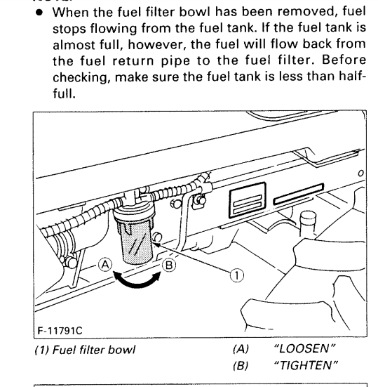

Is there a petcock for shutting off fuel on a B7800? Got a leaky sediment bowl and CANNOT find a way to shut off the fuel!🤷‍♀️

This is what I could find quickly :

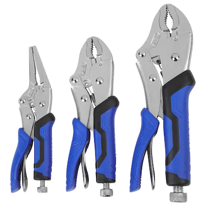

You can also take a "vice grip" plier and put something like a piece of cardboard around the rubber fuel line and pinch it to shut off fuel.

I find that putting rubber hose over a long nose vicegrip Pliers is the best fuel line pincher.
