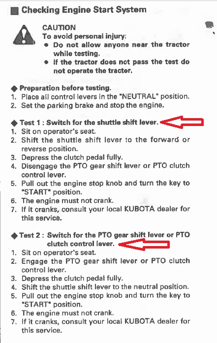

The Operators manual available from Kubotabooks.com contains valuable insight into the safety systems that could prevent starting.
At the very least you must have safety switches not working properly.

Thanks for the checklist Dave. I'll work through that 1st.

As it turns out the neutral safety switch was the problem.
Unscrewed it from the shifting lever bracket for a closer look
and it looked all tarnished so ran some 400 grit sandpaper between
the contact points , reinstalled and started right up and shut down properly by key.
Refreshing the safety switch contact points or replacing the switches if worn badly will now be part the annual maintenance . I will probably replace this one. FWIW.
