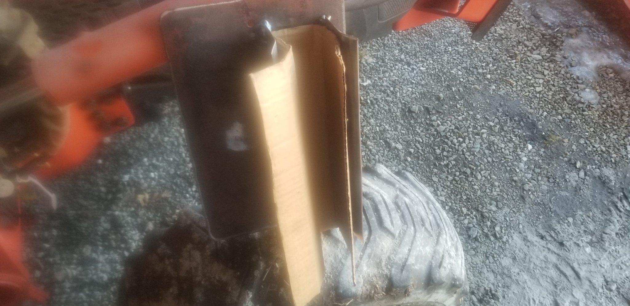

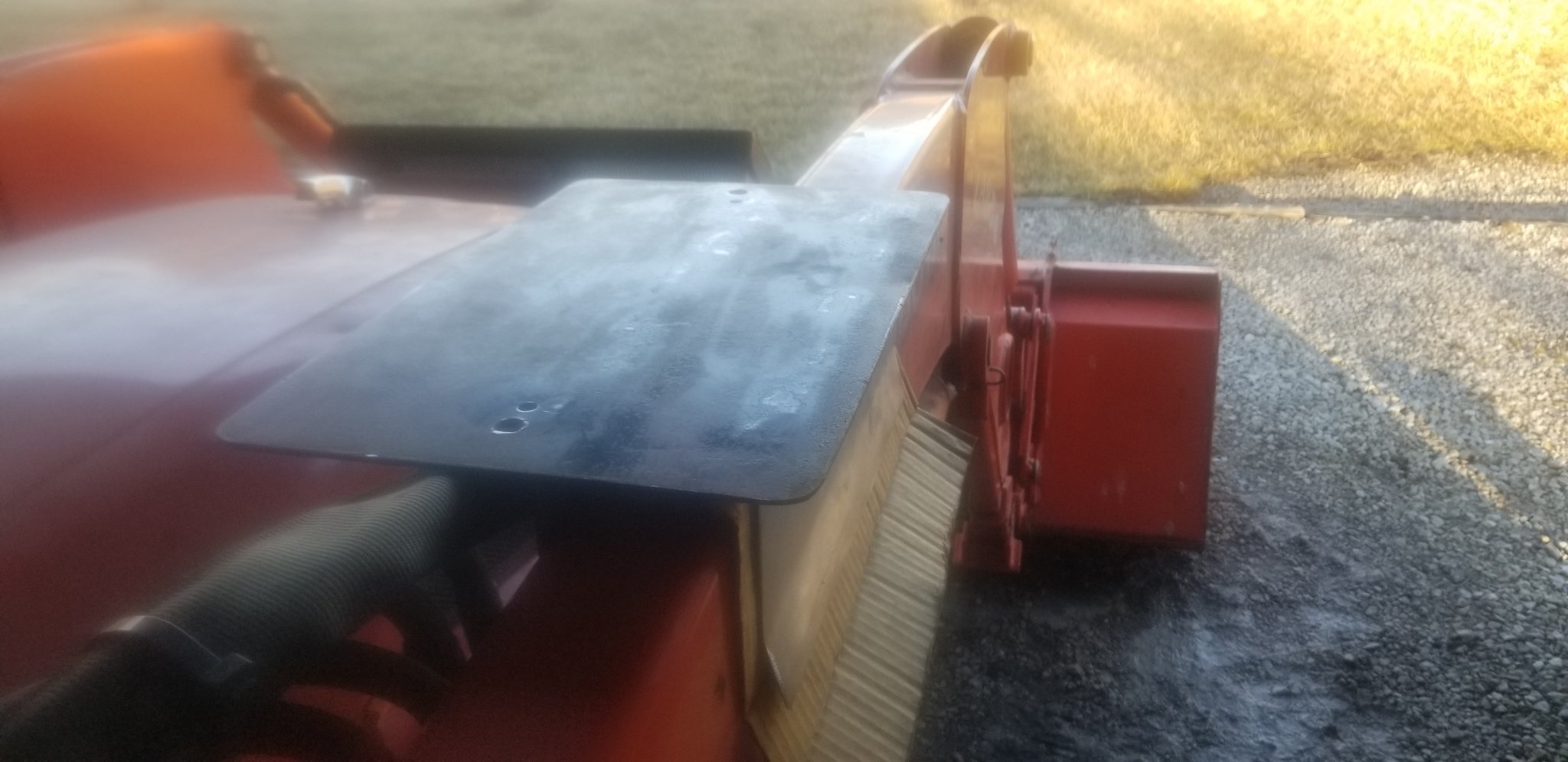

Skeets, here are some pictures. I made it out of some steel I had laying around. Made it as I imagined it.
I actually do not use it because I have an L4240 and when I set it on the loader arm, then set a fuel can on the top plate it sets too high for me (and I'm 6'-4"). I think the concept would work real good for a smaller tractor where you wouldn't have to reach up so high to the top of the fuel container. It could also easily be made out of wood with some glue and screws.
There is a piece of cardboard folded inside to keep from scratching the paint.

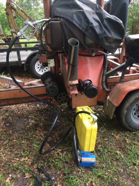

I am very satisfied with my Harbor Freight pump. It works well with the tractor or sawmill and I never have to lift the fuel jug.

Skeets here's something you might be able to fab up and make pumping fuel easier. I made one out of steel, but you can make one with wood and screw/glue it together. It's simply an upside down "U" that set over your loader arm. There is a flat board on top to set the fuel can on and stays there without support. Then you can use a siphon pump or any inexpensive pump to easily fill the tank.
I built the exact same thing out of wood and I just use that 'shake siphon' that costs about 10$ on amazon. Takes a couple of minutes but im not holding the can so who cares.

LINK. I had a coupon that knocked it down a bit. I also added a PVC pickup tube and "water hose" fittings on the pump so that I could disconnect both hoses.

I got mine after having shoulder surgery last February and have been using it for a year with absolutely no problem. I added a hook to the pump so that I can hang it on the fuel jug or whatever. I installed "garden hose" connectors on the pump and both hoses for easy disconnect and also plugs & caps to prevent dirt intrusion when not in use. The pump will empty the 5 gallon fuel jug in 30 seconds.
It was $100 well spent!! (y)
