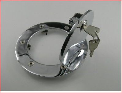

..perhaps a lad might scrounge up a flat rear quarter from a junker car and cut out and weld the fuel filler door over top of the filler cap after cutting a hole in the hood.
Pop the little door, unscrew the cap and have a peek! No hood popping/ undoing cab shrouds to fuel up or check levels
Also a project to screw around with. :D

yup this is the way to go! The Jeep ones are black; just have to
make sure the opening will be big enough to reach in to get at the filler cap.

Great ideas here. What i might do with my sight tube is tee the bottom off the fuel line,this way i can replace line without having to drain tank. The gas door is great too, may go with a chrome one. Might check out the local boat/marine supply store. They have all kinds of access doors.
