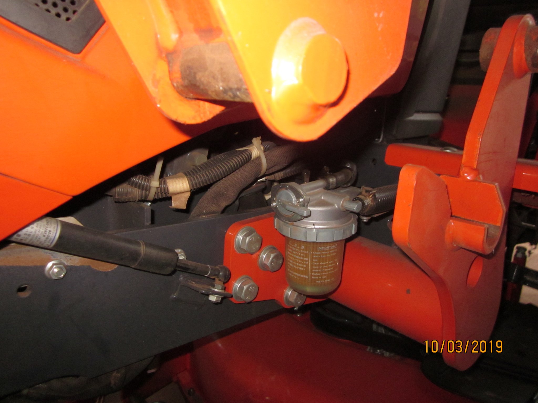

Put this on my 2380 last spring. View attachment 44718
I’ll warn you about that particular filter assy.... that little exit “elbow” is only “press-fit” and will vibrate loose and leak. It’s the same unit used on my M4700 and the previous owner had replaced it in the mistaken effort to cure a leak. (I found out about it from the selling-dealer who had all the service records of the tractor.) When I kept seeing diesel on the floor I thought it was the O-ring but some baby-powder dusted onto it revealed the leak at that elbow. (I also found the on/off valve improperly assembled and inoperative as the result. I fixed that by properly assembling it.)
I fixed the filter housing/elbow by drying it with electronic cleaner and re-installing the elbow with JB Weld and let it cure overnight. No further problems.
