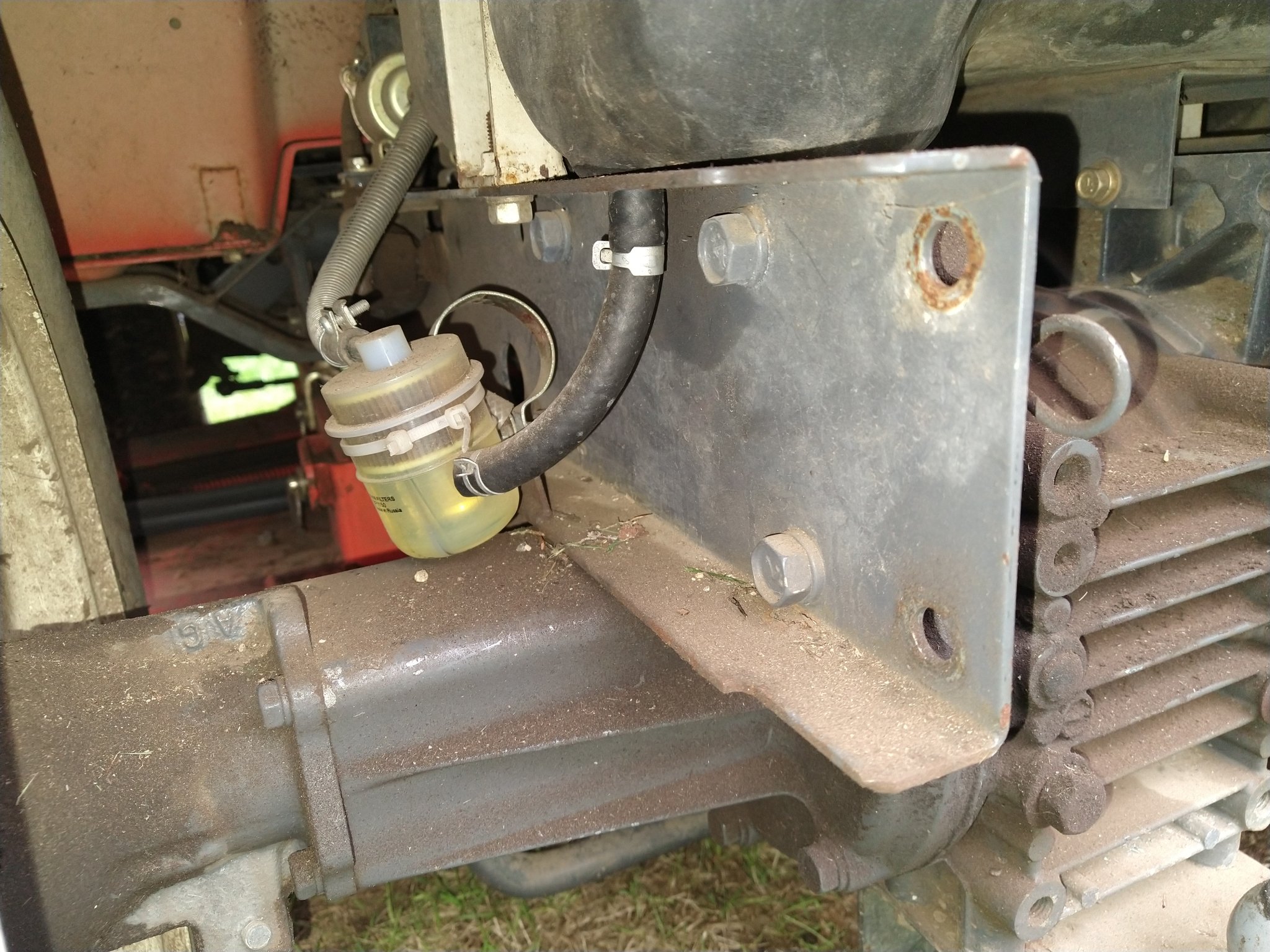

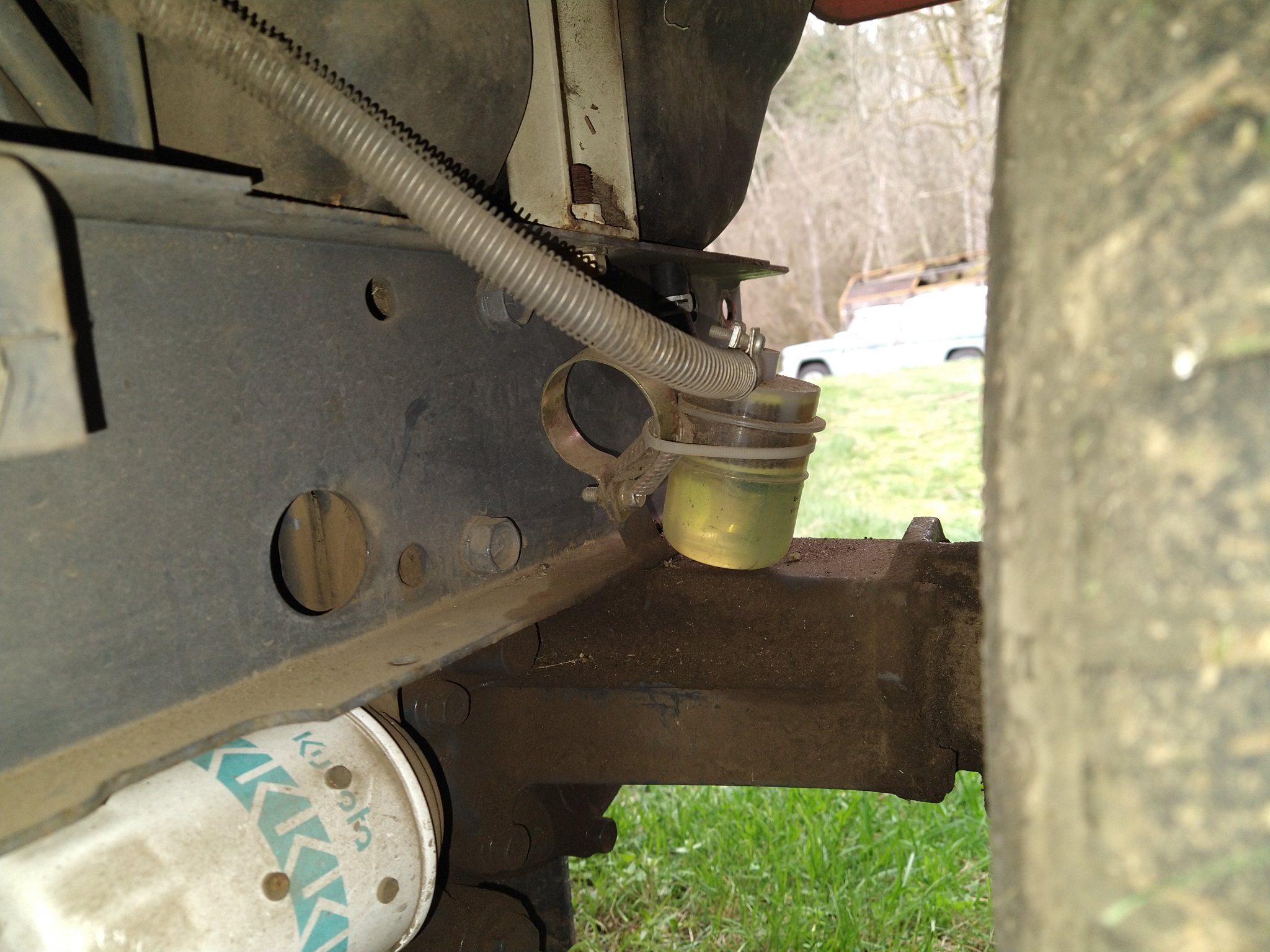

I've been a reading posts here for years, but figured I'd should sign up and help out once and a while.
I've worked with a lot of filtration products in both manufacturing (hydraulics, chemicals, etc.) and power generation (diesel gens), but I did do a simple quick filter upgrade to my G1800S.
I used a clear bowl/water trap "Suzuki filter" for my prefilter.
When I bought my G1800 it had a leaky line from the tank to the prefilter due to frequent dealer service (every year changes), so I lengthened the line and installed the Suzuki filter. I still need to find one of their mounting brackets, but it works good for now.
I still have the stock speced 2nd final filter in place, but will need to replace the other fuel lines as they are all showing signs of decay and weeping.
The "Suzuki filter" is what my filter guy called them as they are a popular retrofit on equipment, but were OEM on the Suzuki Samurai and many Suzuki outboard motors.
My Komatsu excavator is the first place I saw one retrofitted on, and when I learned about their better than normal ability to separate water due to their "deep bowl design" and with the inlet below the element as compared to the other "low cost" filters.
I have them on a lot of my equipment and vehicles. I like that I can see very quickly if there is any water or crud showing up in the bowl. I've only found them with 8mm - 5/16" barbs, but I've used barb adapters to work on 1/4" lines too.
