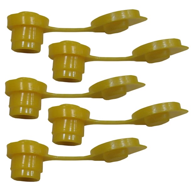

Do NOT use valve stems as they will rot in the presence of fuel. Get the cheap vents I posted earlier. They are perfect and work so simply. (If fact, they seal to tightly when snapped shut they blow-up my boat portable tank like a balloon.)
I have 15 (Fifteen) 5-gal portable fuel cans that have these vents. You use an ordinary 1/2” flat-blade wood-bit to drill a hole in upper portion of the can (I do them at the upper/rear of the handle) and use a mallet or hammer to pound it into position with ONE HIT..... They work GREAT!
Get them on Ebay or from Amazon or WalMart even... 5 for $5: https://www.walmart.com/ip/5-Yellow...MIkfivkqHA6QIVQ77ACh22FgtcEAQYAyABEgJ6hPD_BwE

Thanks all for the suggestions. I started with the little yellow old style vent tabs. I’ve installed them on all of my plastic fuel cans. I’ll see how they work before I replace them all.

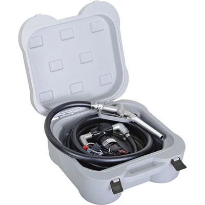

I use 55 Gallon Drums on a Pallet and a Diesel transfer Pump from Northern Tool (Amazon has them as well)..... 1594661500143.png 1594661523236.png
