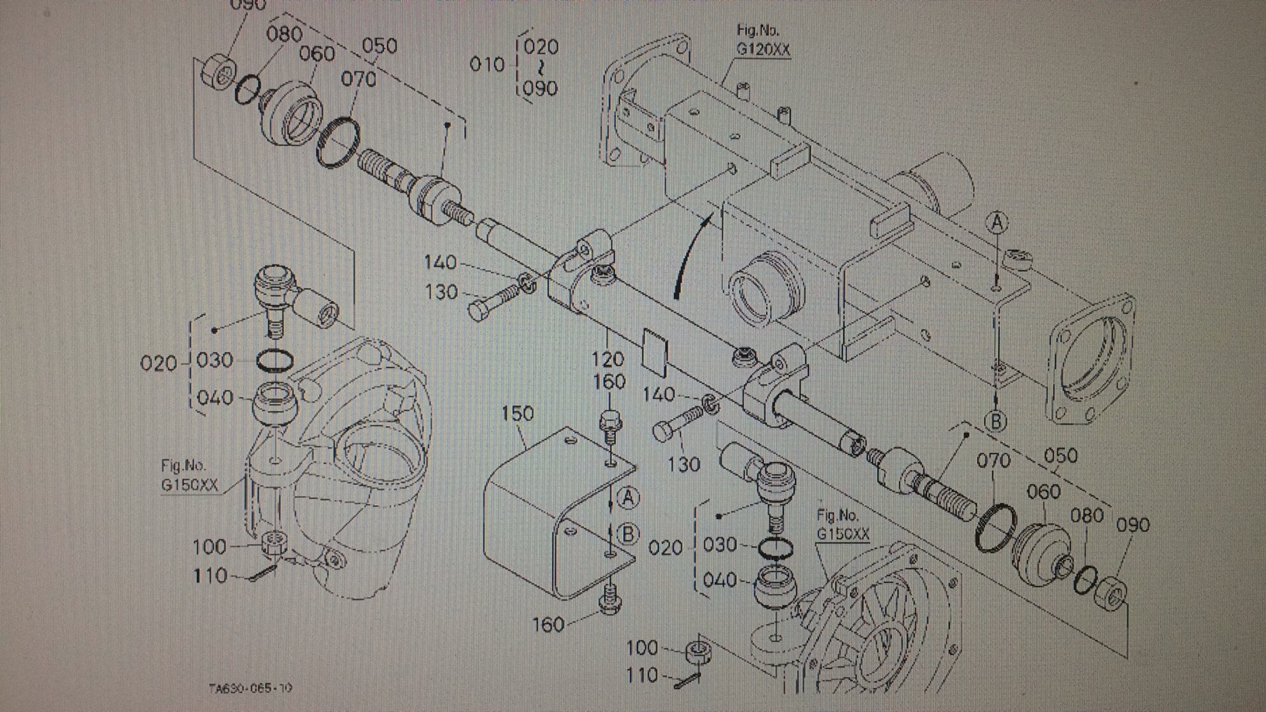

hmm, posted pictures are the steering system not the 'diff lock'. That would be inside the front axle,where drive shaft goes in.

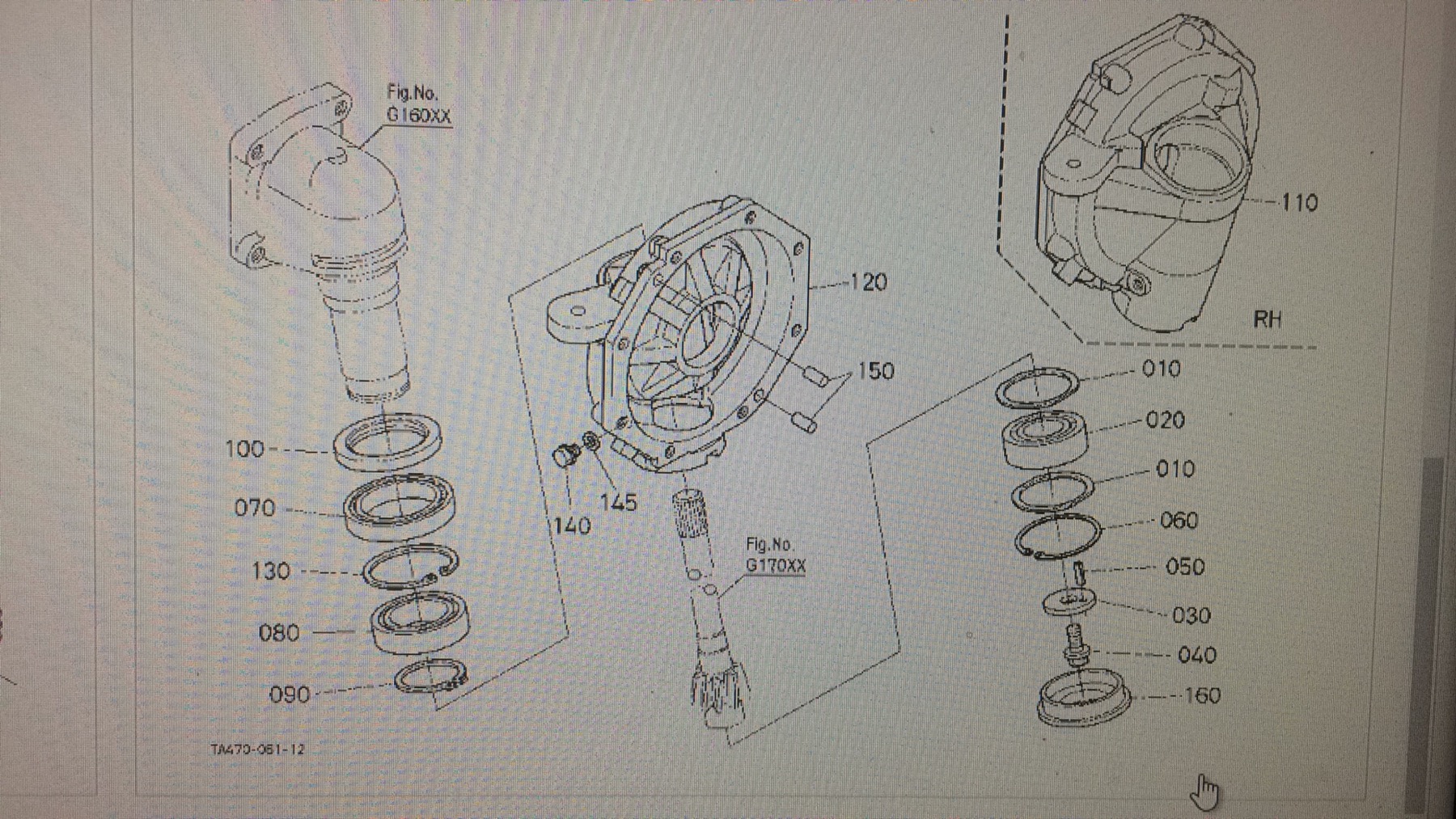

Hi, managed to get WSM for my model. I am attaching front differential screenshots, hope they are the correct once.
Those sheets are showing a NON Bi Speed front axle.
Let me do some digging and see if I can find a newer USA model of the same size that has Bi Speed.
