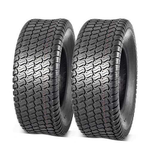

I have a B8200 hst 4wd and it needs front tires. The current tire size is 24x8.5-12. Kubota says that size has been discontinued. They are turf tires today. Seems like the answer is to go with 23x8.5-12 I am curious what others have done is it better to just get bigger rims and a different size tire? I was even thinking about the new r14 tires for the front. the rear turf tires are in great shape. Thanks for taking a minute to look at this and comment.

Thanks for the reply. I am only replacing the front tires not the rear at all. Front tires have cracks in the sidewall and very little tread. Kubota said that size is discontinued. So far the tire shops don’t have that size either. That is why i was referencing the way to go seems to be 23 inch. Looking to see what others have done.

I personally would go with 24 x 9.50 - 12
Thanks so much. I got them and they are put on. I had my kubota dealer mount them on the rims. They said if I need get any more tires for those rims please go someplace else. :) They had a hell of a time. Bottom line they were helpful and got them on the rims for me. Onto the next repair item.
