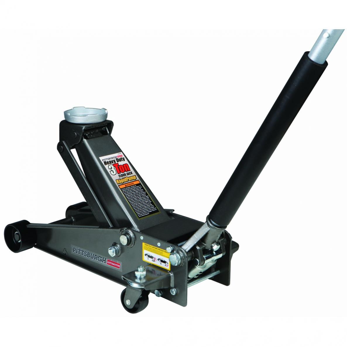

I have always just used an automotive jack - they can go down very low, yet jack plenty high. In the field I'd go for a couple of thicknesses of plywood under it, and stick a couple of timbers or a jack stand to hold the weight once the wheel is up.
The auto jack has the advantage that you don't have to put your hands or arms under the tractor while jacking.
Also, remember that the tractor weighs less than a full sized pickup. Even with filled tires you are not putting a 2 ton jack to a strain.
