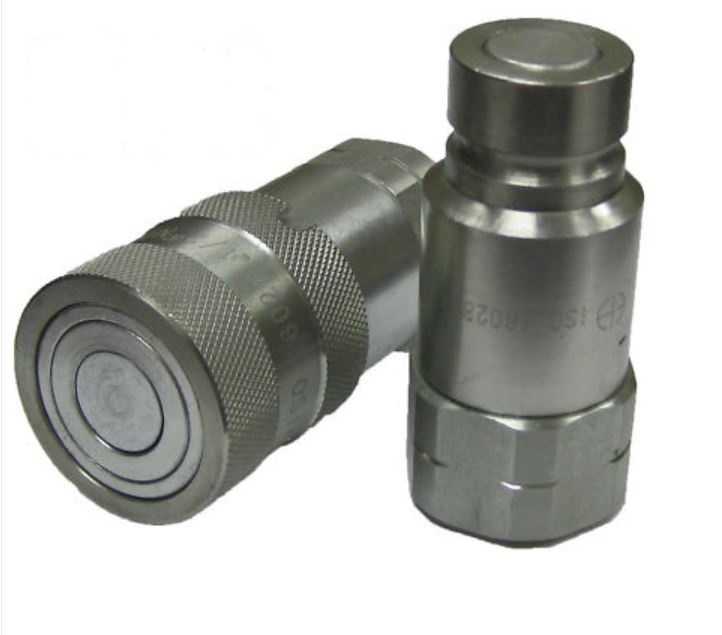

And why change the couplers out for a coupler that could have the same deficiency, I would change them out for some flat face couplers if it were mine.
You can remove the couplers with it not running and with no load on them (IE. blade in the air, or any pressure on the cylinder, just wiggle the spool control lever to relive pressure) have a small bucket or coffee can as they will leak some fluid when you take them off (and it's hydraulic fluid not ATF)
These are flat face connectors:
