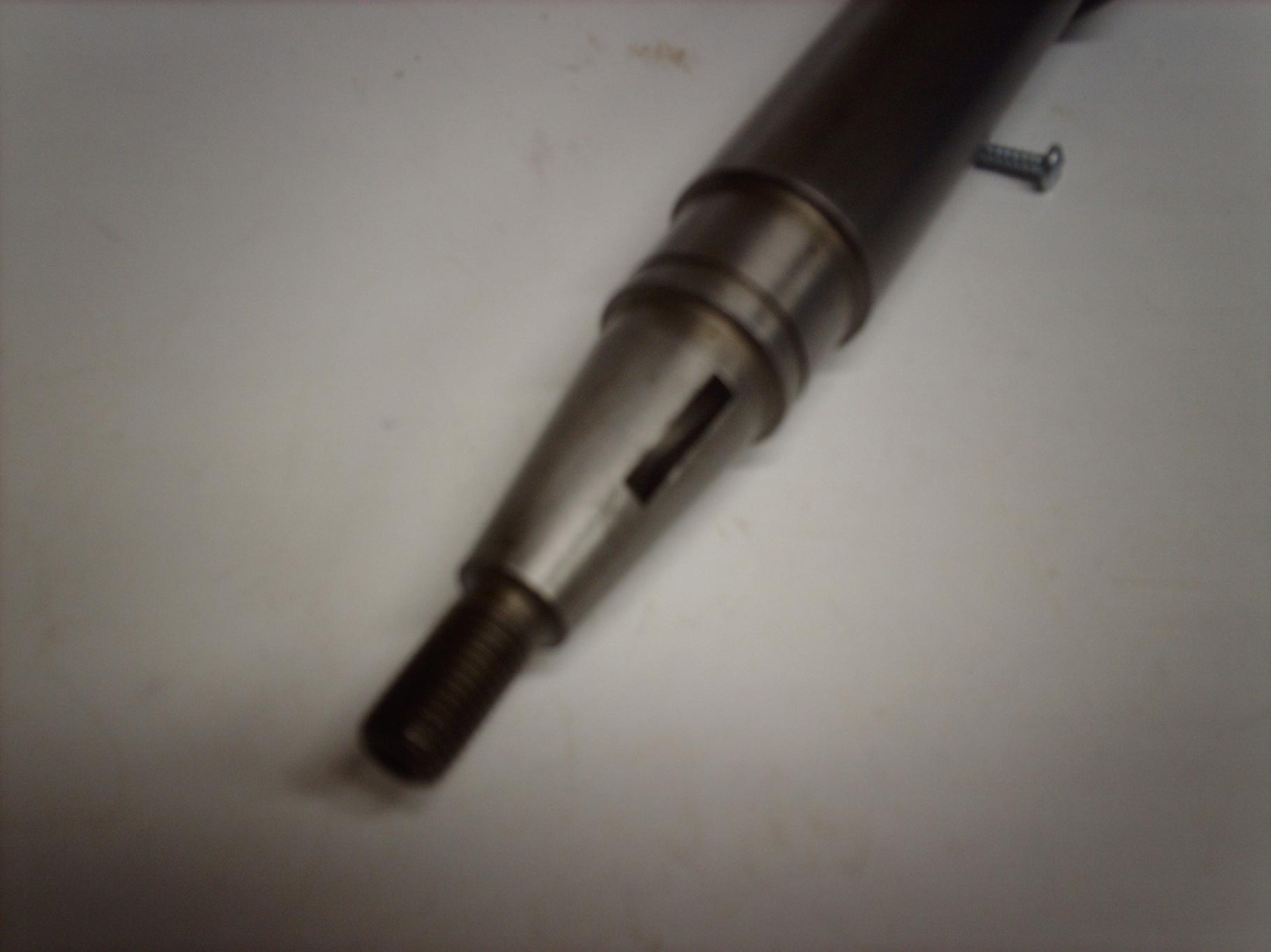

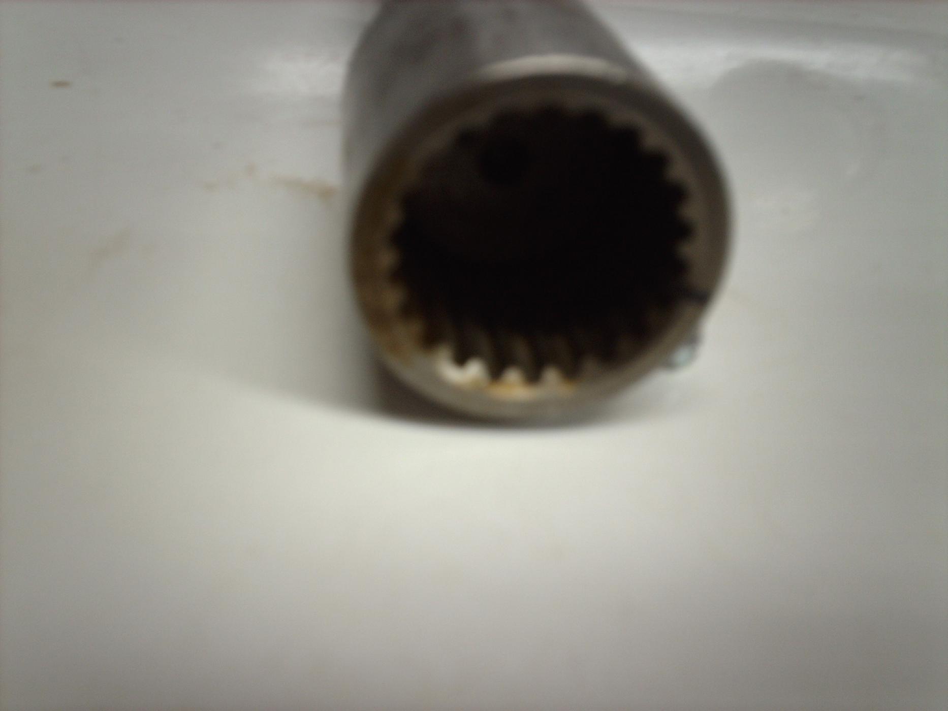

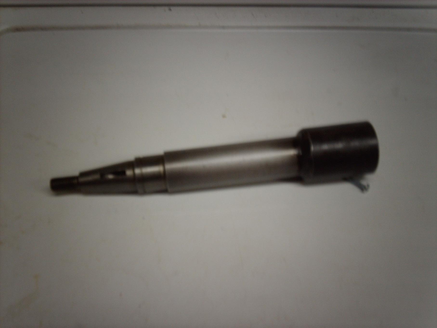

Yes the pulley has a splined shaft . I have found an electric clutch with 1" shafts and maximum torque of 110 FT/LB’s. I'm not sure if it will be enough for a snowblower
This a picture of the shaft. Diameter is a little bit less than 30 mm. It is probably 1 1/8". I count 22 teeth but I'm not sure that 22 teeth = 22 splines

Kubota part # 66494-88540 is a shaft that I think will fit the spline if you have the pulley with the 3 bolt holes with the splined hub attached. It is 8 3/4 " long and has a tapered end with threads.
