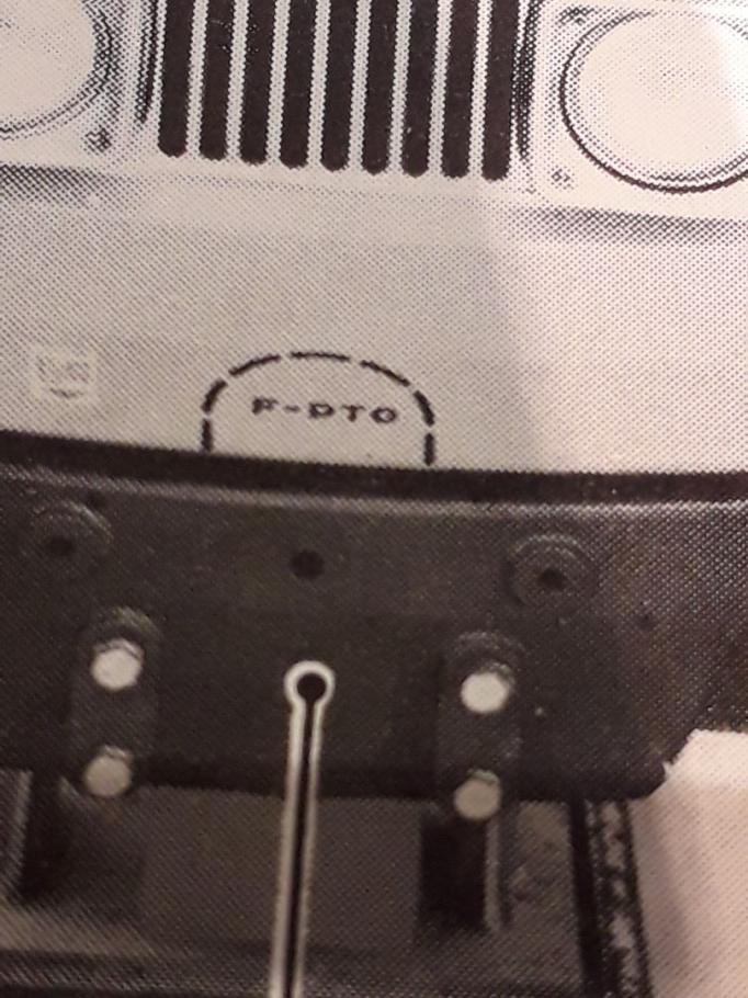

I wuz looking at some pics in the WSM and noticed that some of them had "F-PTO" showing on the front end and dotted lines indicating where a cutout for the PTO would be. See pix below. Does anyone know anything about the front PTO for these tractors - was it ever offered as an option, if offered as a kit, what was in the kit, how did it connect to the crankshaft, how was the external end of the shaft supported, was there a clutch etc etc?
There's no other info in the operating, parts, or workshop manual about them (at least the versions I have), or in the S2600-B engine manual.
Any advice/hazy recollections gratefully received!

For the M4500 there was a front loader labeled M1820. An external pump was coupled to the front of the engine - no clutch or gearing. The partslist website shows it - copy of the pdf attached. It uses two 2-row chain couplings but the drawings of the pump drive don't show much detail.
Edit: I'd try calling these people about the crank adapter, likely the tough part to duplicate. Dick B

You are legend! Thanks for that. I will check it out!
Update: H'mmm, needs a US VPN - will sort that out. Thanks for the help, it's just what I needed to get going.
If anyone else has any additional info please don't hesitate... :)

rbargeron, thanks for the pdf of the parts list. Looks like the drive adapter bolts to the crank pulley.

I found some photos of loader-equipped M4500s but it's not clear about the front mount arrangement for the pump - do you know whether the rectangular front counterweight and the heavy cast wraparound "front bumper" were left in place or were they removed to mount the pump?

Haven't seen one up close so I dunno. The weight loop likely goes away. Google pics show several different loaders on M4500 tractprs. One machine with M1820 loader appears to use the internal hydraulics (side of engine).

BTW, the wrap around front weight/bumper does not have to be removed to run a front aux pump on the M4500. The attachment isn't all that difficult, easy adaptor to fab. When mine was mounted it used a short shaft with u-joint yokes on each end.

Thanks guys. The crank pulley on mine has the 3 threaded holes for the drive, so it is all do-able :) Bonus discovery as a result of this discussion: to rotate the crank for leakdown testing I can cobble up a socket, extension and bar, in place of the front PTO shaft.
