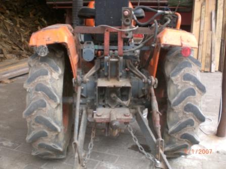

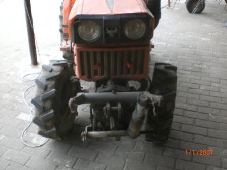

Good morning all together,
i´m new here and first some informations about me.
I am 33 years old live in Good Old Germany and since yesterday owner of an Orange B7200. I got it for free.
And now the "problem". Everybody knows it´s an older model and we need to do a few thinks.
Its not easy to get spare parts for this Kubota in Germany so i look also in other countries. Can anybody tell me the best seller for spare parts for this model?!
And a second question, did anybody knows if it is possible to install an front loader on the B7200D?! When yes, can you please tell me the model name of the front loader an maybe a seller?!
Thank you everybody.
Attached some pictures
P.S. sorry about my bad english :eek: ;)
If you need some more informations or anything is not clear, please contact me.
Regards Christian
