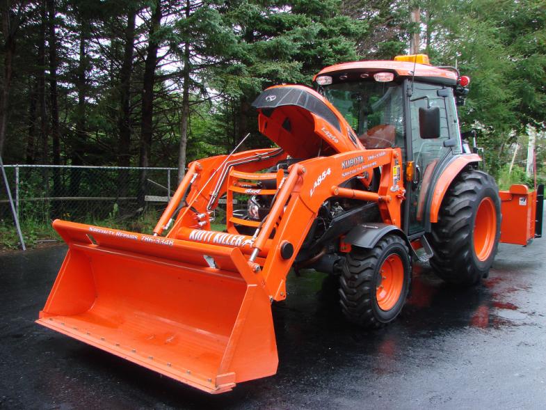

Hi swift. First of all welcome to the site.
Yep my Canadian Kubota L4240 has front fenders. They used to be standard equipment on some of the Grand L models here in Canada. I'm almost sure that from the model 3940- 5740 had them. Below those models they don't because the front Axel assembly is different with no mounting points for the fenders to bolt on to.
That being said I'm sure if you wanted to install a set of these fenders you could just by fabricating your own mounting brackets. It's a well worth item to have on a tractor in my opinion. I attached a few pictures for you to view. You'll see why I'm talking about in the difference of the front Axel.
You'll also notice that I added a mud flap to improve on keeping water from flying up on the windshield. I checked my parts manual and even my service manual and there were no part numbers on the fenders however there's a name stamped on the fenders and it is "Dunloflex-E" You might goggle it and see what that tells you. The Canadian Grand "L" model also comes with a higher output alternator and rear defrost on all three windows. I'm not sure if the American Grand L's do as well.
This past summer I removed the powder coated brackets off the fenders and fabricated new stainless steel ones to go back. I HATE powder coating. Just HATE IT! :mad::mad::mad:
I almost traded up to a 5740 Grand L this year and noticed the the Canadian Kubota's don't have the front fenders on there tractors anymore. I asked the dealer why and they couldn't tell me.They weren't sure why. Too bad because it's a very nice feature on these machines.
