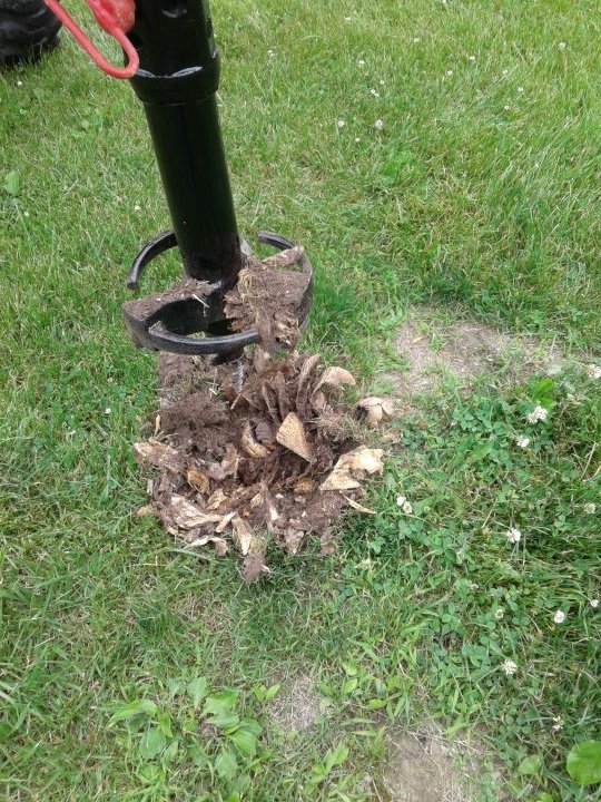

Found my LP SA20 auger at a Kubota dealer that also sells construction equipment. Has the medium flow motor, it's slow (way faster than hand digging), never had to drill new hole because of striking tree root. FEL has enough weight to use float for down pressure. When tractor starts to rock sideways, pop it out of float, auger needs time to chew thru tree root. Applying down pressure only raises front axle and tractor will twist right or left. You'll have to pull auger and realign tractor to finish hole.
Reconnecting auger - If you connect hoses together to keep couplers clean, the motor can free-wheel and you have a 2 axis swivel connecting motor to frame. I built a parking stand to address these issues.
