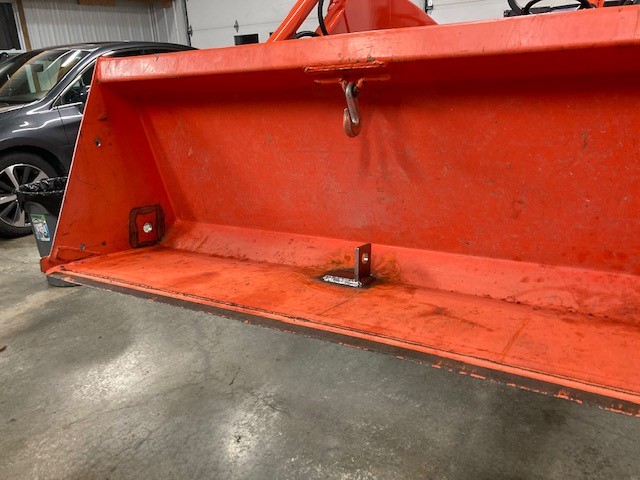

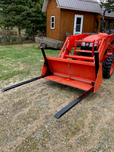

What's the purpose of the bar going across between the forks?
Looks like if they were just bolted to the bucket sides where the bar is, the functionality would be the same, and the bar would not be needed...

Je boulonne les côtés quand je l'utilise pour mes bûches ou mes piles de bois, c'est plus solide, si je l'utilise pour différentes palettes, j'enlève les 2 boulons et ça devient ajustable

The bar KEEPS them properly spaced/aligned when they’re not installed in the bucket.

According to French to English translator:
"I bolt the sides when I use it for my logs or my wood stacks, it is more solid, if I use it for different pallets I remove the 2 bolts and it becomes adjustable"
