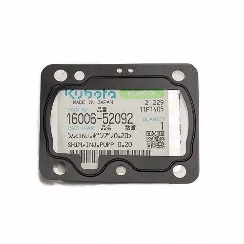

Thank you very much, this is exactly what I need to be happy. My mechanic showed me 2 more gaskets from the injection fuel pump that he needed, one made of tin, square, the second one made of cardboard completely fell apart.One looked something like this. Unfortunately I don't have any samples, as the mechanic put everything back together so that the tractor would be in working order.

You don't Willy Neilly replace that / those shims, they are sized exactly to set the timing on the injection pump.
And if they are on there, then there would be no logical reason to change them.
Correct (as usual).
For that engine there are three shims available (in different thicknesses)
0.15mm
0.30mm
0.45mm
The injection pump cover gasket should be 15296-51660.
OP would do best to contact Coleman/Messicks/Other for parts. They should have a complete breakdown.
