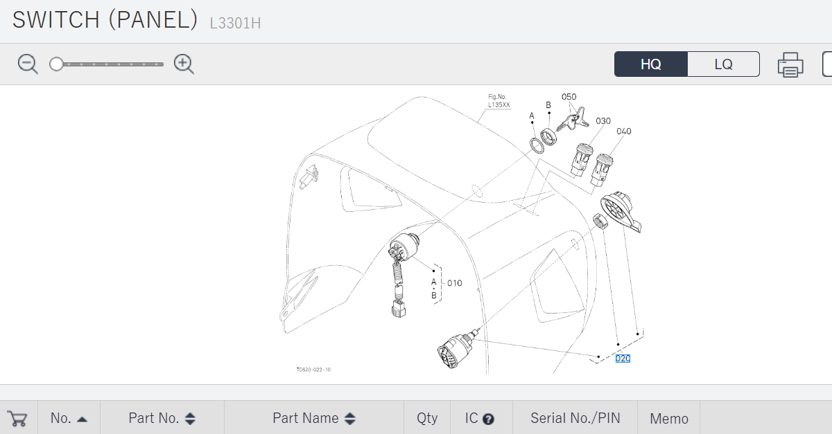

Hey team thanks for all your advice on my problem back in January. Turns out it wasn't any of the suggestions below :rolleyes: Instead it was my key switch. I know this because it has continued to degrade over the past two months to the point I now must replace it.
My follow up question to you is - how does this switch come out? I thought I can unscrew the band on the front and just push it out but with the band removed it won't budge. I can't find any videos on how to replace this key switch so thought I would ask the experts what the trick is to replacing. I am hoping I dont have to remove the fairing to get this done.
Any help or suggestions are welcome.
David
Ummm #10 said key switch....
With the bezel removed it will come out.
Evad

That's what I thought. I think years of grime, etc. just locked it in there. Also if you have big hands its really tricky to pull that thing out from under the fairing. But its done now and thanks everyone for their help and advice.
