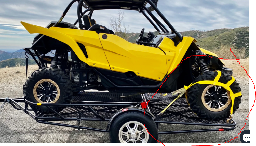

Had one of these delivered last week. Primary use is for my Polaris Rzr. My Rzr is just like the one in the picture. 2 seater, Turbo. Etc.
My concern is the hinges used for folding it. It's powder coated but it appears that the two hinges are 3/8" steel. With a 3/8" steel bolt as the hinge pins. One on each side of the trailer. Under acceleration most of the Rzr's weight will be on the back half. Only those two hinges keep the front and back half together!
My concern is the cantilever effect with my 1,500 lb Rzr on it. I'm concerned about breaking the trailer in half and watch my Rzr do cartwheels on the hiway behind me. I'm considering adding a few ubolts at the front and back half connection. Instead of trusting two 3/8" hinge bolts.

There does not appear to be any lock on the folding part, am I right on that asumption?
This is flat stupid, you don't tie things down to something that moves!

This trailer checks all the boxes regarding what I need.
There IS a lock. But it doesn't hold the front and back half together. But, it just prevents upward travel of the rear half. More info tomorrow.... I'm off to bed.

Wolfman: The back half has cheesy latches to keep it from folding upward. That's why I'm thinking ubolts top and bottom where the front and back half meet. Was hoping you all may have a better idea.
Jay: The tongue and hitch are all welded. Valid point regarding the powder coat. Regarding stability it looks to be 60/40. Reviews say it pulls very well. I'll find out.

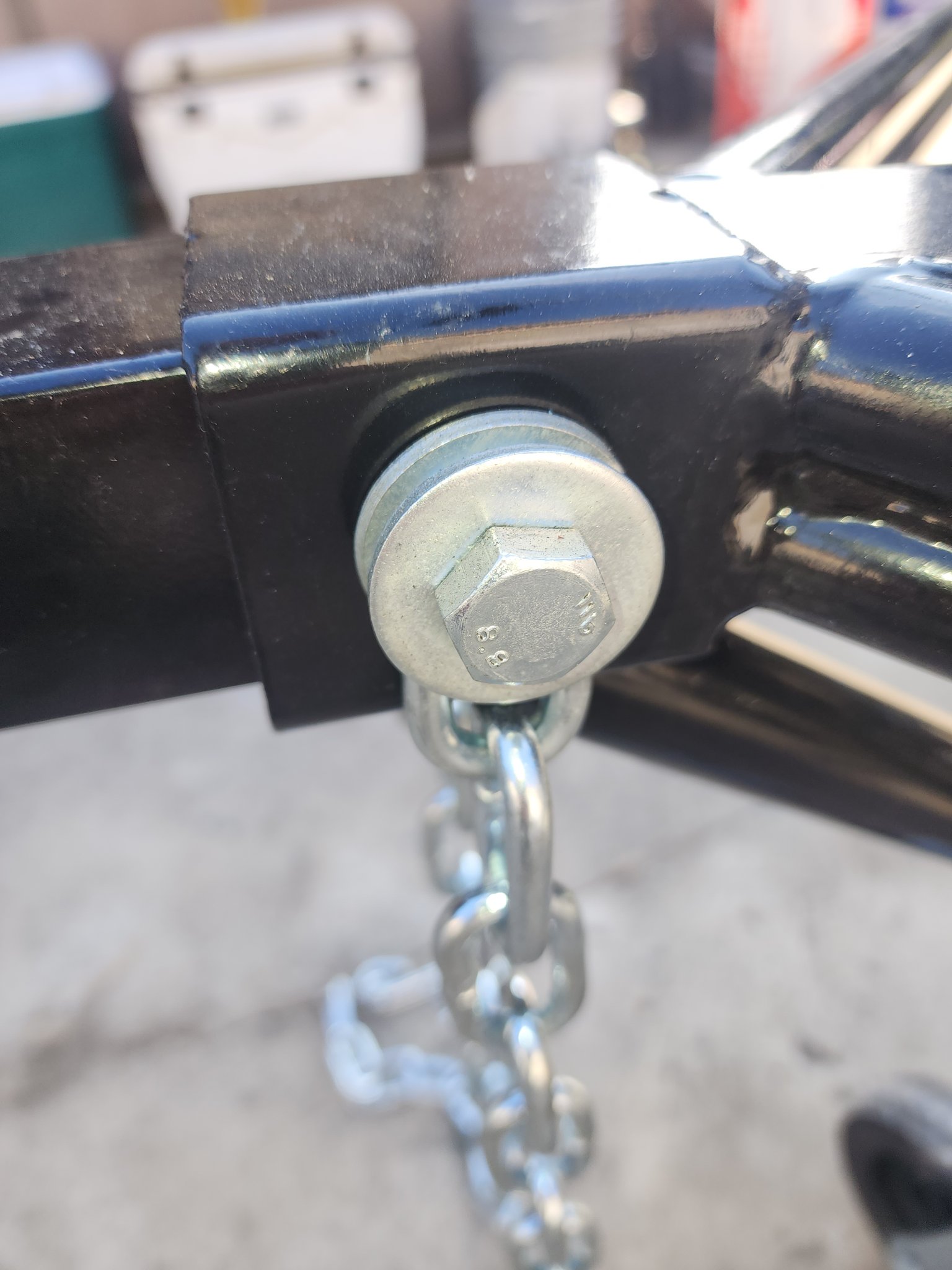

That's a METRIC bolt holding tongue onto trailer AND the 2 safety chains.....

Oh crap! You are correct. Pics. View attachment 120193
Should be fine as long as you cross the safety chains. :ROFLMAO::ROFLMAO::ROFLMAO:

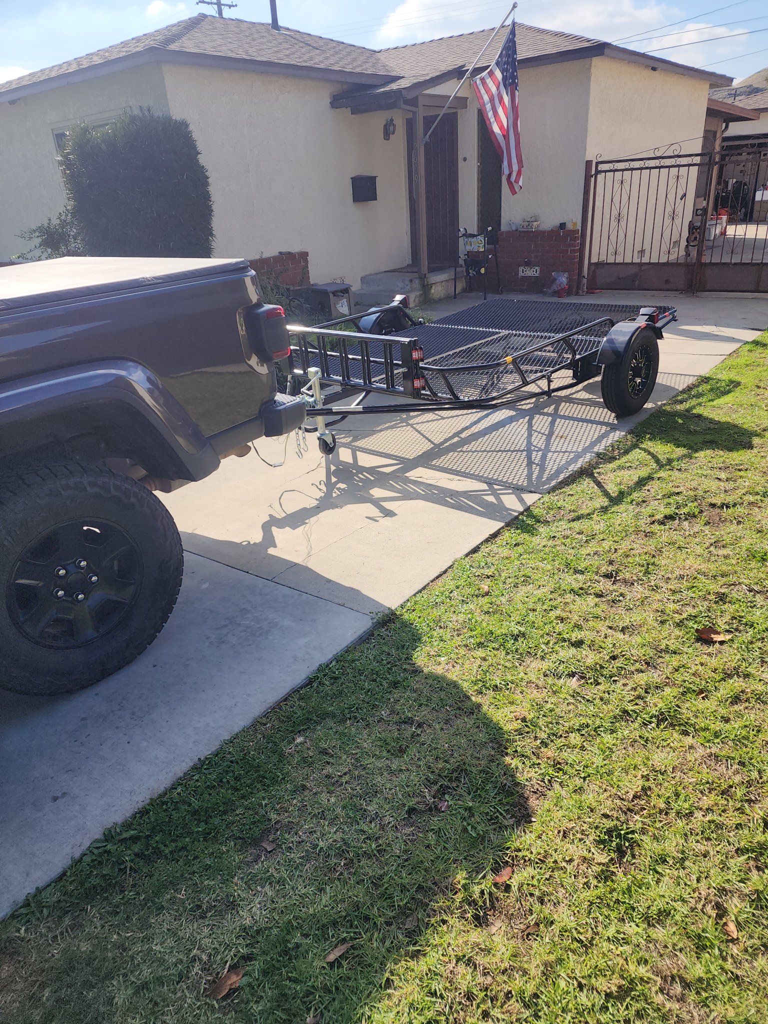

Trailer hooked to my Jeep truck. 1st time.
At vacation property.

How was backing that new trailer with such a short tongue?
I have a small offroad teardrop camper, that has a short tongue (lock n roll articulating hitch) and wide wheels/fenders…two things I would mention about a short tongue:
1. They turn incredibly sharp…sharper than you may be used too.
2. Regarding fuel ups and gas stations, if someone not used to pulling a trailer (such as a spousal unit or friend) can very easily wrap it around concrete pilings. (Although I suspect by the pictures yours may track pretty true to the vehicle as the wheels don’t look too wide…maybe a non issue with yours?)
Good luck and keep the rubber side down. 👍
Yep@ I never try to back up a trailer shorter than the tow vehicle. By the time you realize that the trailer is going the wrong direction, its completely start over time.
Been there, done that too.
Thanks
Thats why I got the wheeled jack on the trailer.

A few things you may be overlooking:
- The pictures all show the utv backed onto the trailer so the engine and fuel weight is on the fixed part of the trailer and much of that is becoming tongue weight on the tow vehicle.
- The trailer axle does not carry the tongue weight. Indeed this is part of the definition of a semi-trailer, a portion of the weight is carried by the tow vehicle. The only common on road full-trailers are a semi-trailer with a converter dolly, i.e. the 2nd or 3rd trailer in a double or tripple rig.
- The weight shift under acceleration is far less than you might imagine.
Go to a truck stop and scale the utv, I bet the front axle weight is far less than the rear axle weight.
The shear strength on that bolt is likely greater than the strength of the brackets it connects to. I don't care for the single shear design though, I would have doubled those brackets so they are stronger, more resistant to bending and the bolt is in a tripple shear configuration. That may not matter much if the front of the utv is only 600# or something.
