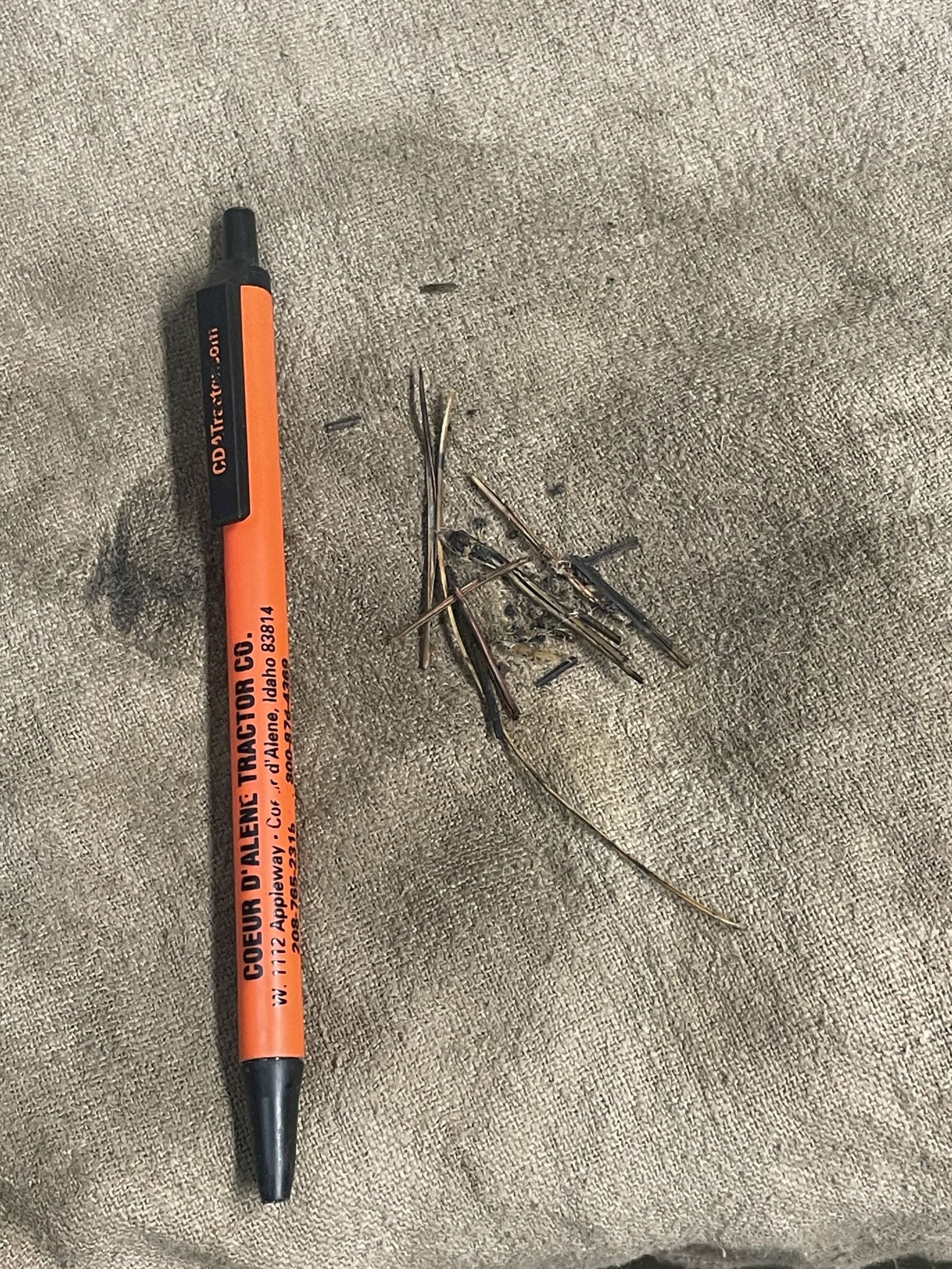

As I tend to over maintain my Kubota BX, I was wondering if I had a batch of bad fuel when at idle I was noticing some surging. Time to get it in the air and change the fuel filters. With a clean container, to see if there may be water in my fuel, I changed the rear filter first, and noticed fuel was not pouring from the fuel line, it was barely dripping. I grabbed an air hose, with a rubber tipped blower and blew up the fuel line, just a quick light blast. Now the fuel poured out. Ok, the filter was as new, problem is in the tank.
Doing some research on OTT and speaking with a Kubota guru friend, I ordered two more fuel filters and a BX sending unit. I’ve seen pics of terribly corroded sending units, filling the tank with particles of rust.
Received the parts within a couple days. Let the fun begin. My BX is a 2014, so possibly early enough to have the old sending unit that corrodes.

With the rear tires off, and the tractor on the lift, it’s a bit easier to operate on basically unbolting everything on the rear. All told about an 8 hour job from start to finish, although, now I could do it in 5. But I don’t ever wish to do it again. With the tank out, and the petcock removed, I could clearly see a mix of pine needles and black schmutz lodged in place. A pipe cleaner, rodded it out on a rag to inspect the particles.
Upon removing the sending unit, it was in exceptional condition, no rust or corrosion.
my issue, and I have known this could be an issue, down the line, in the fall I was in the heavy woods, grappling out huge piles of brush, branches and downed trees. I felt something hit my leg, and saw the fuel cap on the floor boards. Looking at the filler, there were pines needles, twigs etc, all over the upper deck. UGH! Well after flushing a few times, and re installing the petcock rubber and fitting, reassembly, ready to go. 10 hours of work or so, all good. Note to self, this tractor is new enough (august 2014 delivery) that it came with the upgraded sending unit.

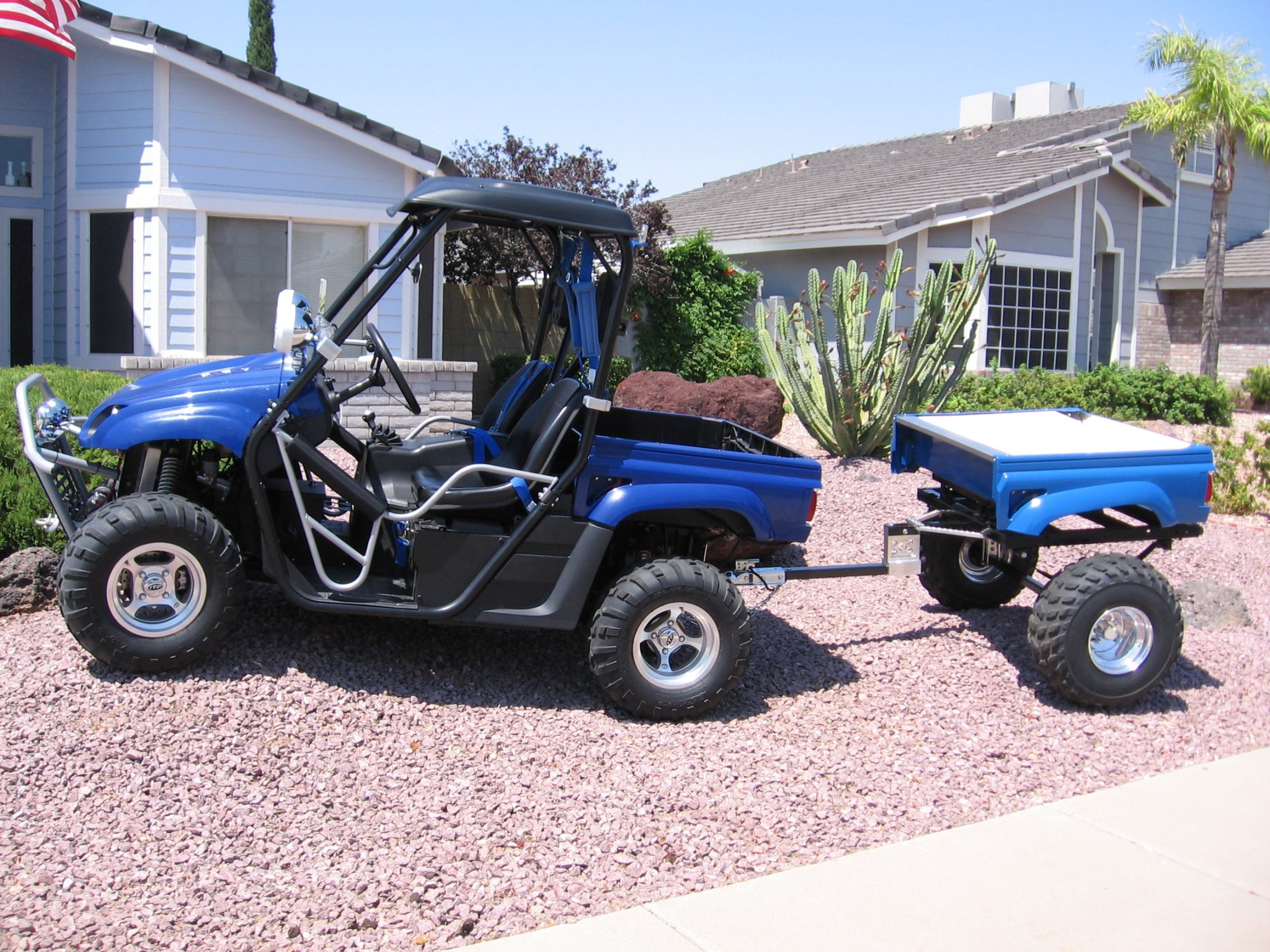

I will say that the hoses only started to seep in two spots, up near the outlet from the head, and they were the original 2004 hoses. (about 6000 miles, in Arizona)
I replaced them with aftermarket silicone hoses from eboy. The two on the radiator weren't too bad, and the one on top the drivers side of the engine was OK, (mine was a more little complicated by an after market coolant temp sensor tee) but those two under the passenger side/rear of the engine were a bitch.
No room for hands/visibility, and they were all hard to clean the metal pipes before installing the new hoses. It would have been a far easier job on a lift.

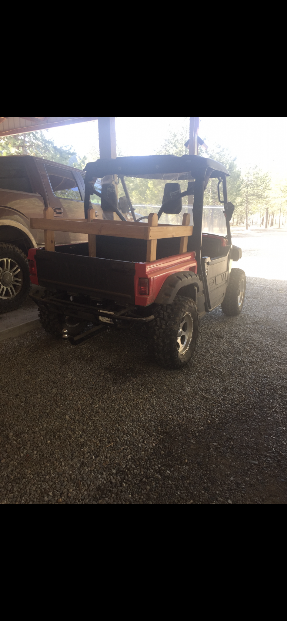

I was just thinking how it would kill me to lay on my back trying to change hoses. That lift was 2K well spent. Fortunately I have a buddy that knows how to adjust the cables, or I may still have been trying to build and adjust It.
This Yamaha is an 04, with 207 hours and 1080 miles. Just like any piece of equipment, maintenance goes a long way. This poor thing was NOT taken care of, but with all the fluids changed, everything cleaned and greased, and the plastic soaked in plastic renew, it is a great fire wood delivery vehicle, and the two dogs fit in the bed, with their noses thru the wood side rails. Here in Idaho you can drive ANY off road vehicle on the streets with a $10. Per year license plate. It’s nice fir running around town, or visiting neighbors.
It’s cool to go to town, and see a family in a SxS, a couple kids on dirt bikes, a big tractor fueling up, kinda like the simple old days.
