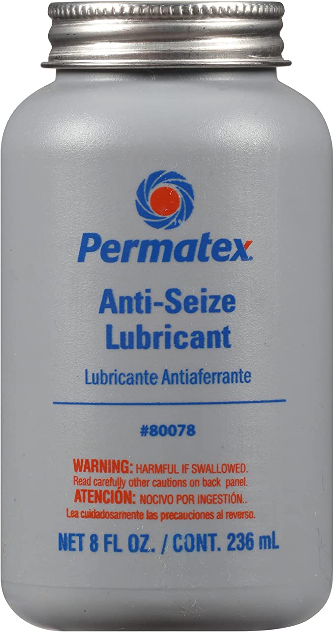

When you tackle the manifold, be really,really careful about removing the nuts and studs.....maybe order spares before you begin...
FWIW.... you might want to put a few drips of new oil on the starter nuts and studs while you're 'in the neighbourhood'......

Good to know! Sheering a stud off cant be fun with these little engines... i mean it isnt fun with any engine but ordering parts prior too is probably much faster in the long run

On my older L185 the nuts holding the manifold to the block are brass and larger hex size (for size of studs) so easily removed.
