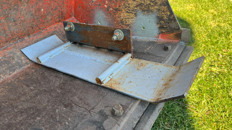

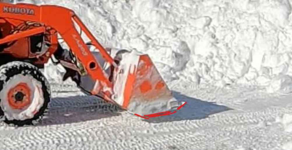

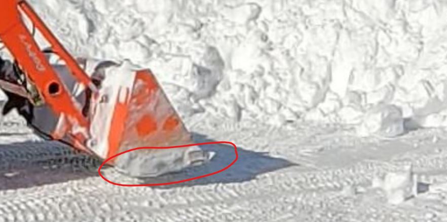

I made a pair of "Bucket Skis" a few years back. I used 1/4" x 6" flat stock that I bent on my press so there was a 2" "Ski Tip" on the front and rear. I welded angle onto the outside edge, and drilled a couple 1/2" holes through the sides of the bucket. They get bolted on for the winter. Being that wide and running the entire depth of the bucket, when in float mode, it gets really close to grade, and does a really nice job.
Depending on how heavy the snow is, I'll have to angle the bucket upwards as I'm pushing once it starts to get full to keep from getting into the gravel. The snow can weight a lot and drive the bucket down in float mode.
Not the best picture, but you can kinda make it out. Had to really zoom in to see them.
Not the best picture, but you can kinda make it out. Had to really zoom in to see them. View attachment 117851
That's awesome! I could probably utilize the holes from the tooth bar for something like that. I would still need something in the center since the driveway is crowned. Excellent idea!
Thanks! Being 6" wide, they really work awesome.

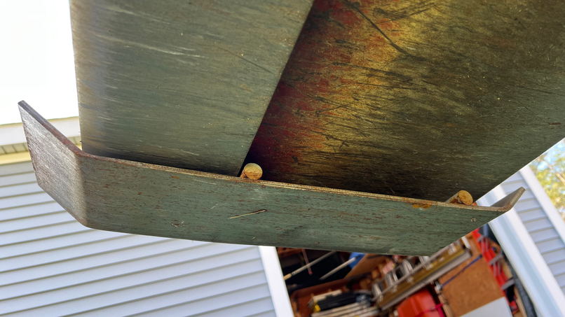

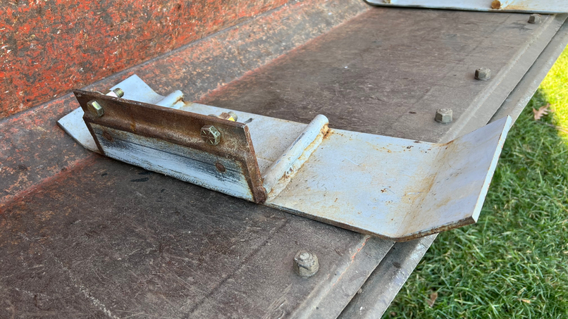

I decided to get the "Skis" bolted on before the snow decides to make an appearance.
Seems it's always too cold when I put them to get them painted!!! LOL
Here's some pics...
