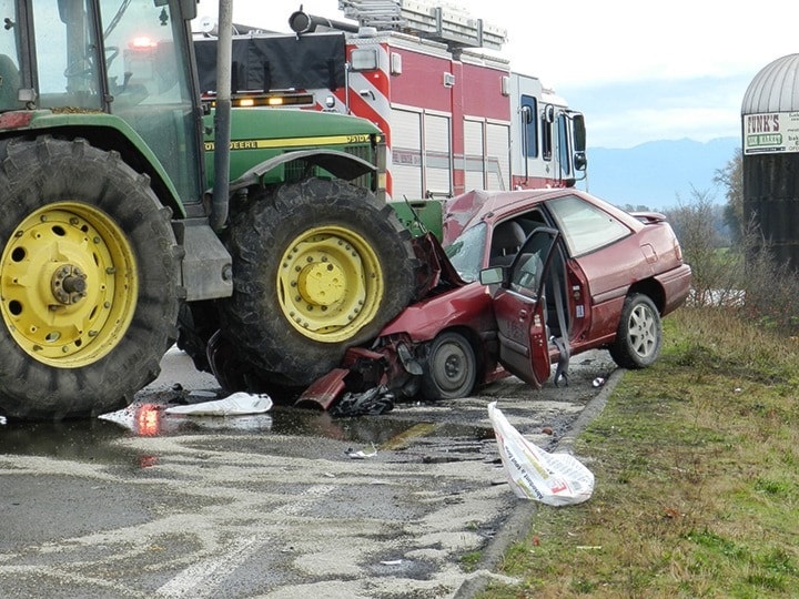

I never thought a deer could cause damage to my tractor.
Deeres can do a lot of damage to cars so not surprised they could damage a Kubota (haha)
