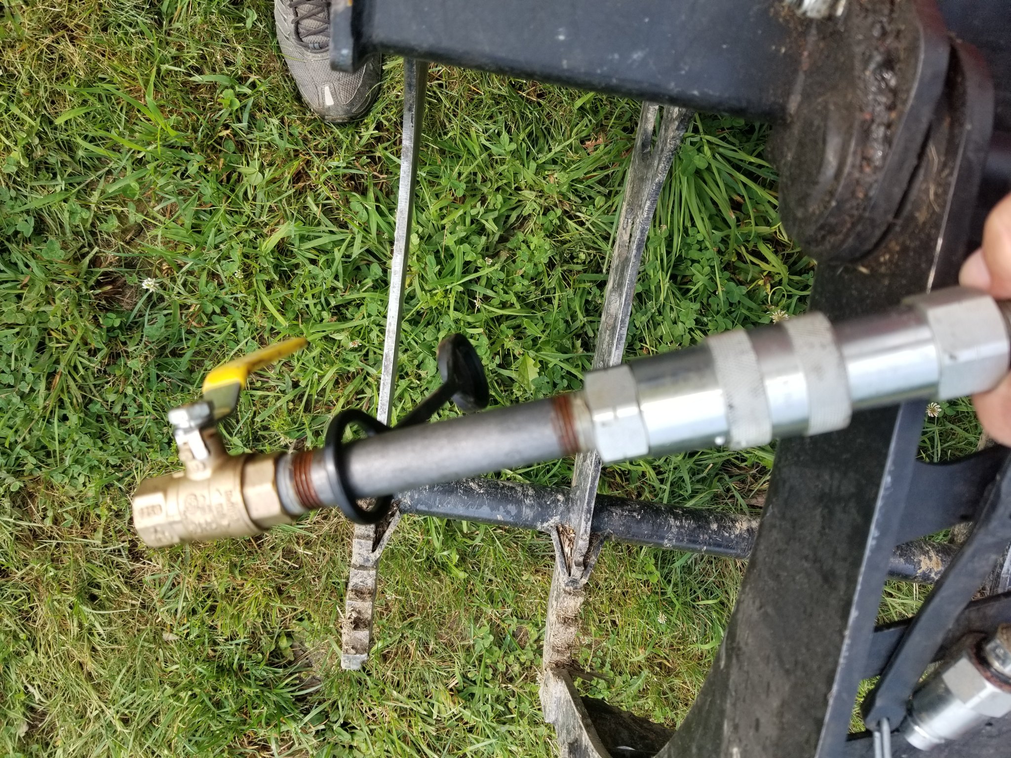

How can I bleed off the pressure from these when attaching a grapple? Once I disconnect and come back to reconnect I cannot unless I crack a line and bleed off pressure. They are on my L4060 HSTC-LE with factory 3rd function. The grapple is a 10 bale hay grapple.
I disconnect one hose and attach this. Air in the black pipe lets the oil expand.
On the tractor side shut off turn key on. Press the buttons a few times.
