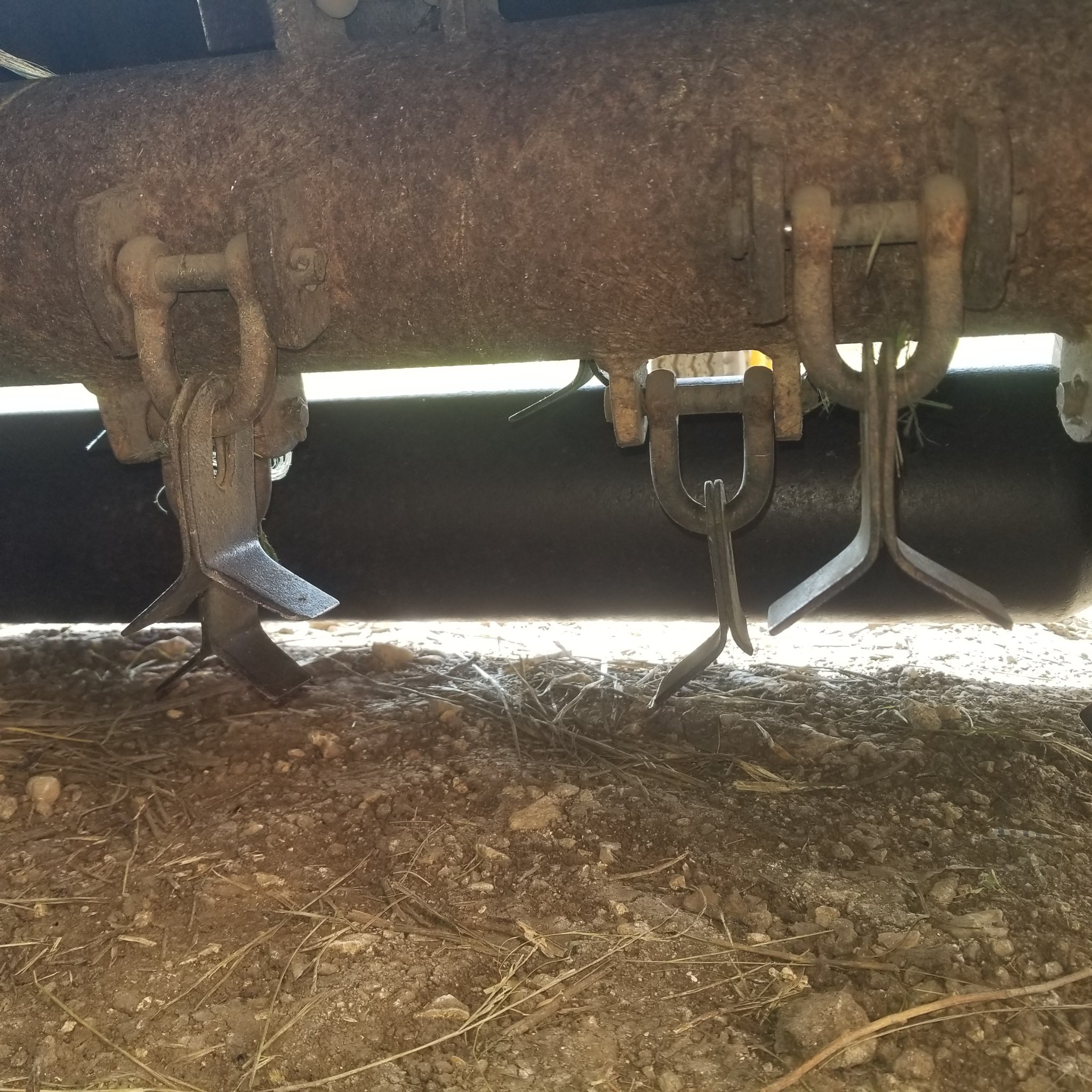

I cut my pasture with a 7' flail and leave it 10"-12" high. Have it anchored at that height with a deck height stabilizer kit. Mows fine, has Y blades.
So tractor is carrying the mower and nothing on the flail is touching the ground, correct?
Is the cut still fairly consistent or does it vary somewhat depending on the ups and downs of the tractor front wheels?
Does the mower still chop up the material or is it just leaving it as cut? In other words, if you are cutting from 24 to 12 inches, what is the length of the removed material?

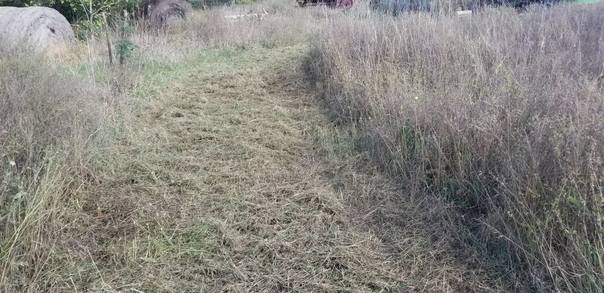

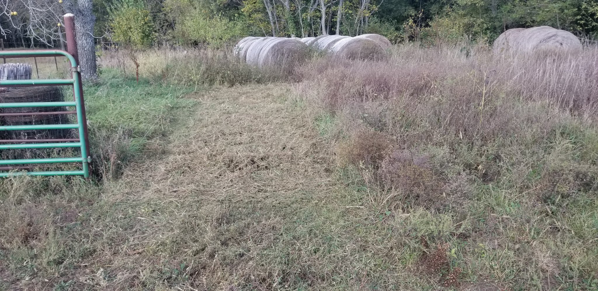

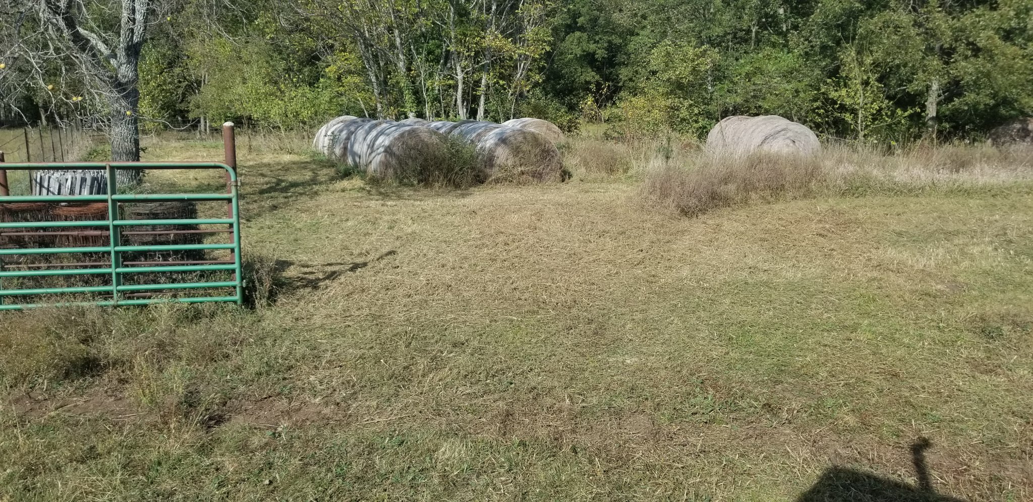

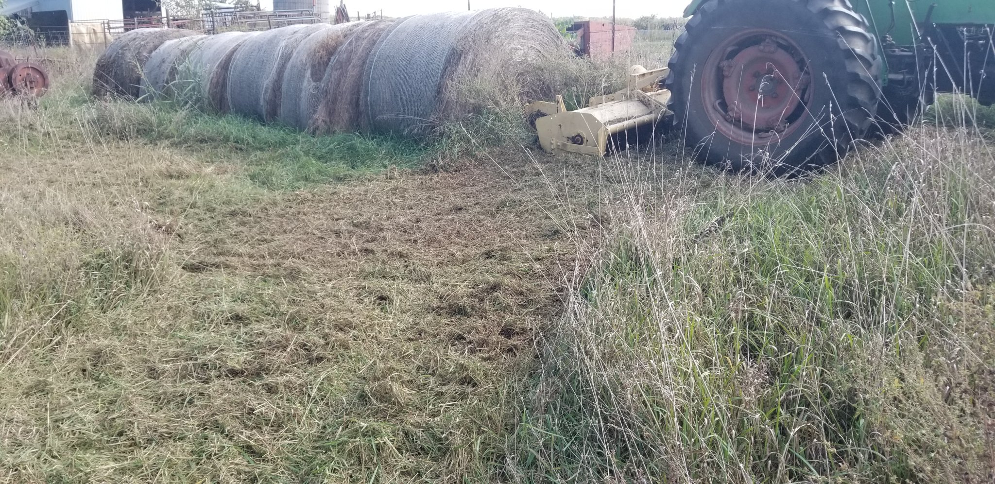

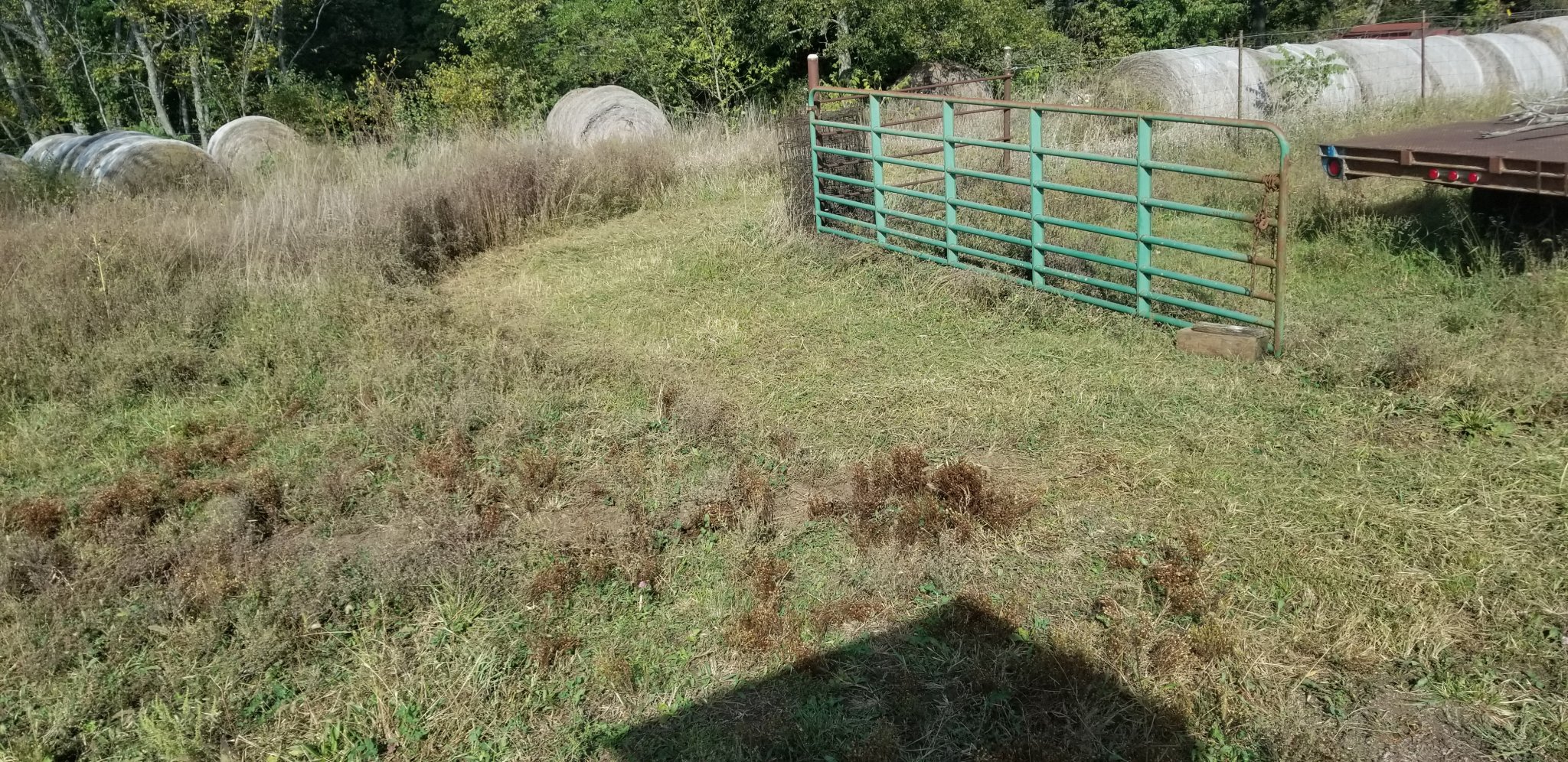

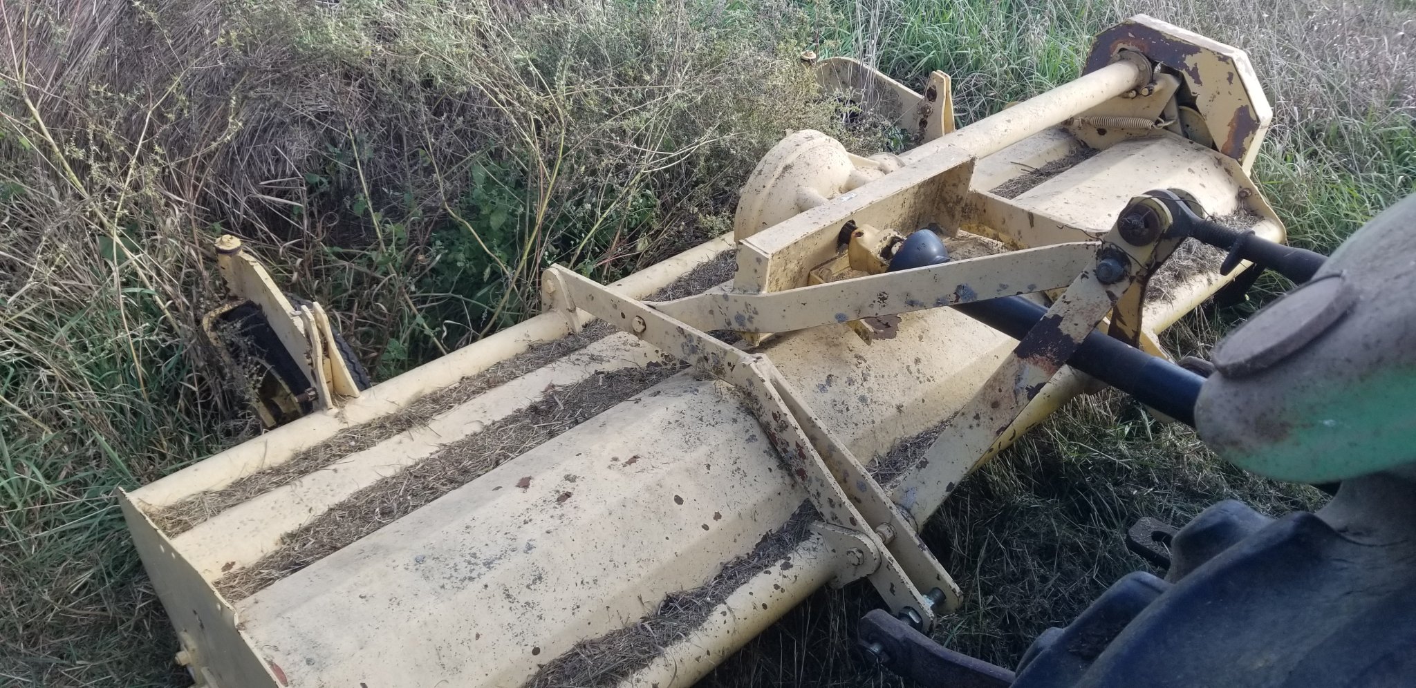

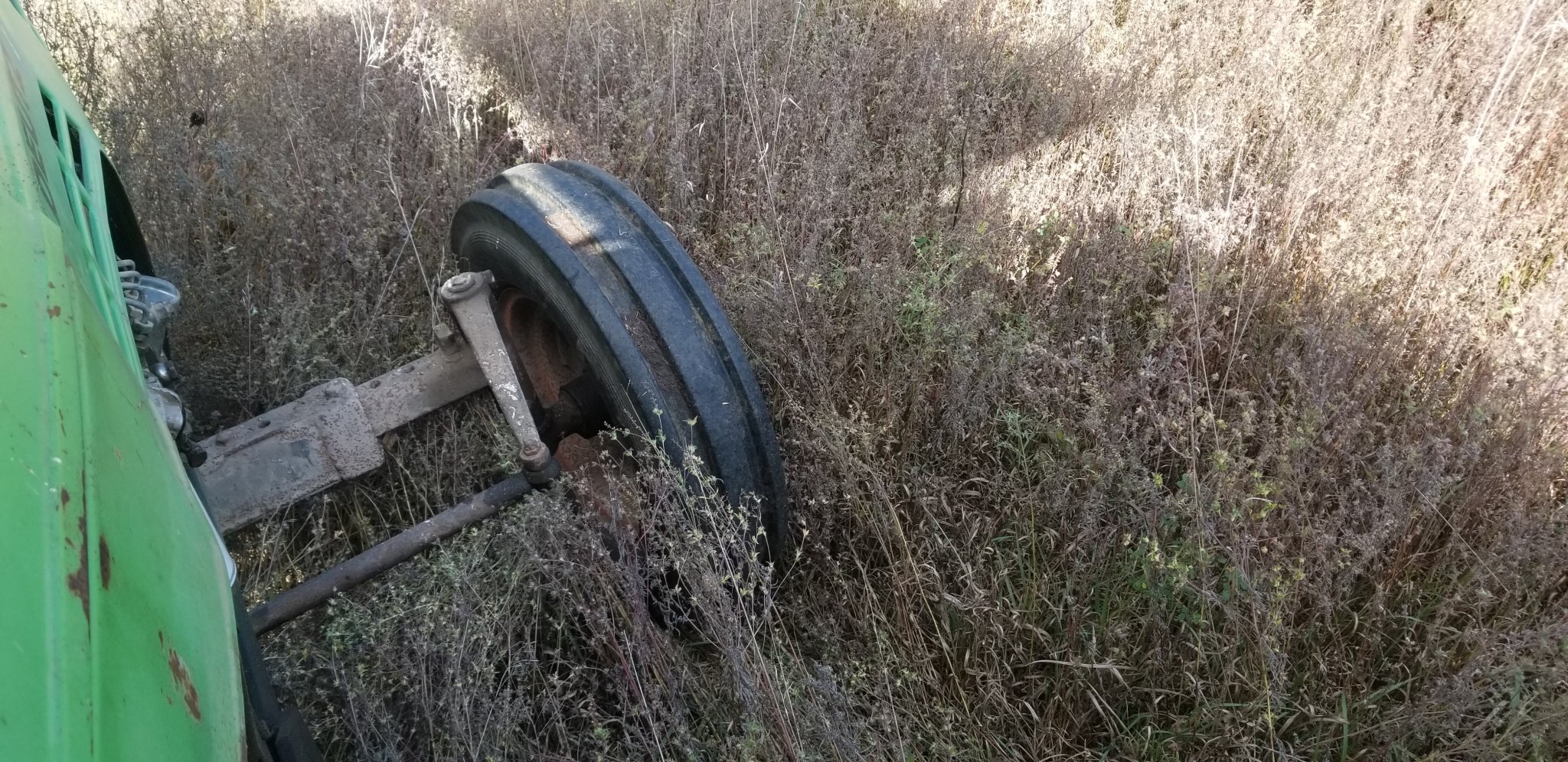

Russell, here's some pictures I took a couple of years ago. This is an area I keep some round bales in and in the summer the grass doesn't get touched. The tractor is a Deutz 6206 to give you an idea of height of grass (7.50 x 16 front tires).
I did not have the chains holding the mower up in these pictures. What is really interesting is I can mow an area with some grass and some weeds the cattle won't touch, but as soon as I go over it with the flail they are out there eating it like birds after plowing. I think it is because the grass get chopped up good.
