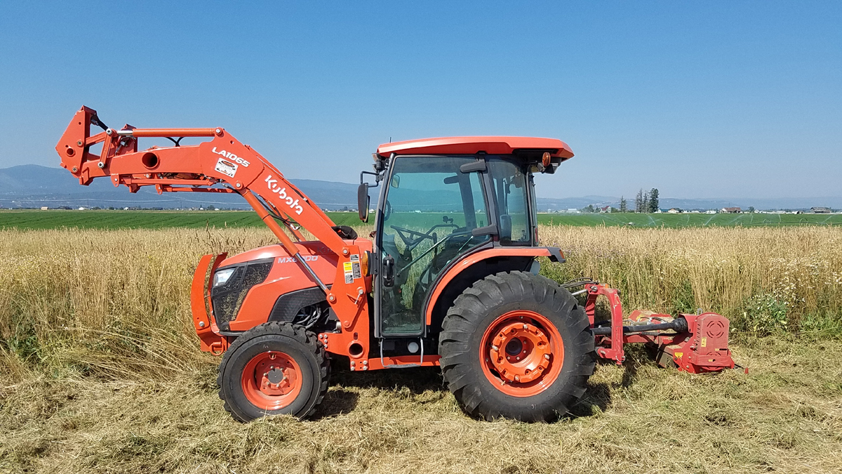

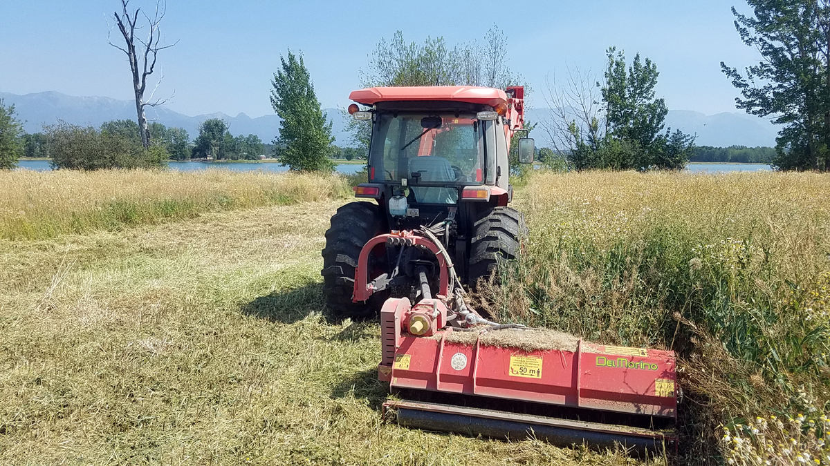

I have a Del Morino Centurion Super 158 made in Italy that I'm pleased with. It's well designed, very well made and it does a great job.

The only thing I would change about the Del Morino I have is to make it 12" wider and possibly have it offset even more so that I wouldn't need to drive over any vegetation before cutting. As it is, it's a very good flail that does a great job in a variety of situations. I really like the RCR1884 rotary cutter, but it's one-trick pony compared to the hydraulic offset flail so I would part with the RCR long before the Del Morino.
