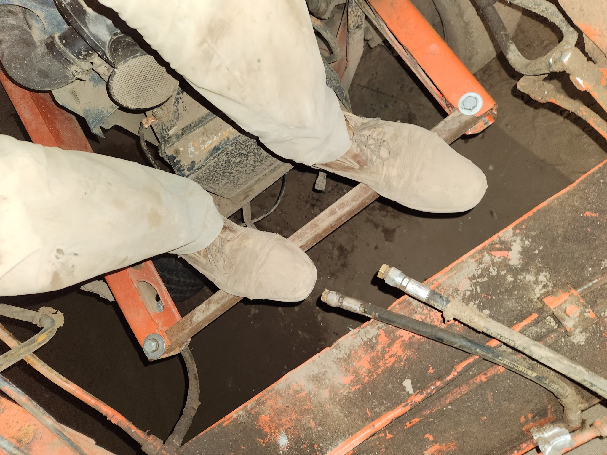

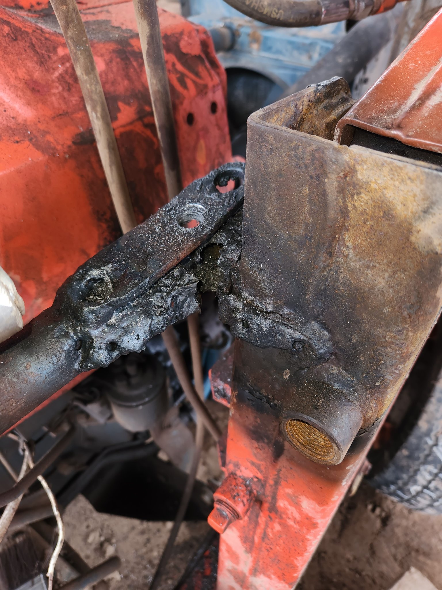

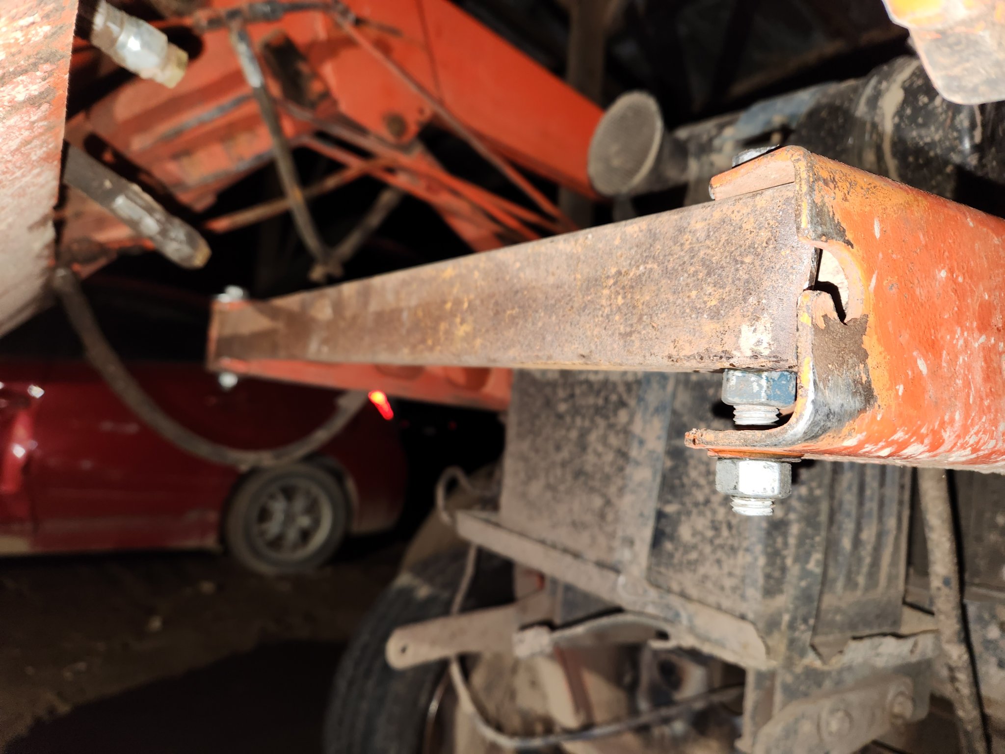

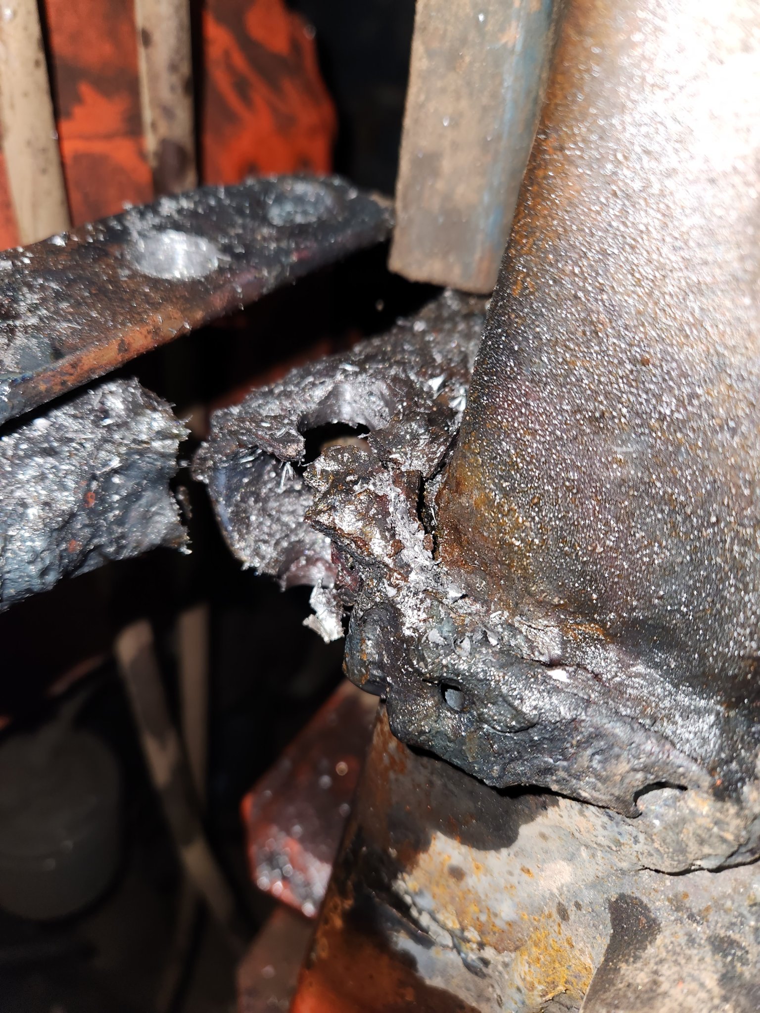

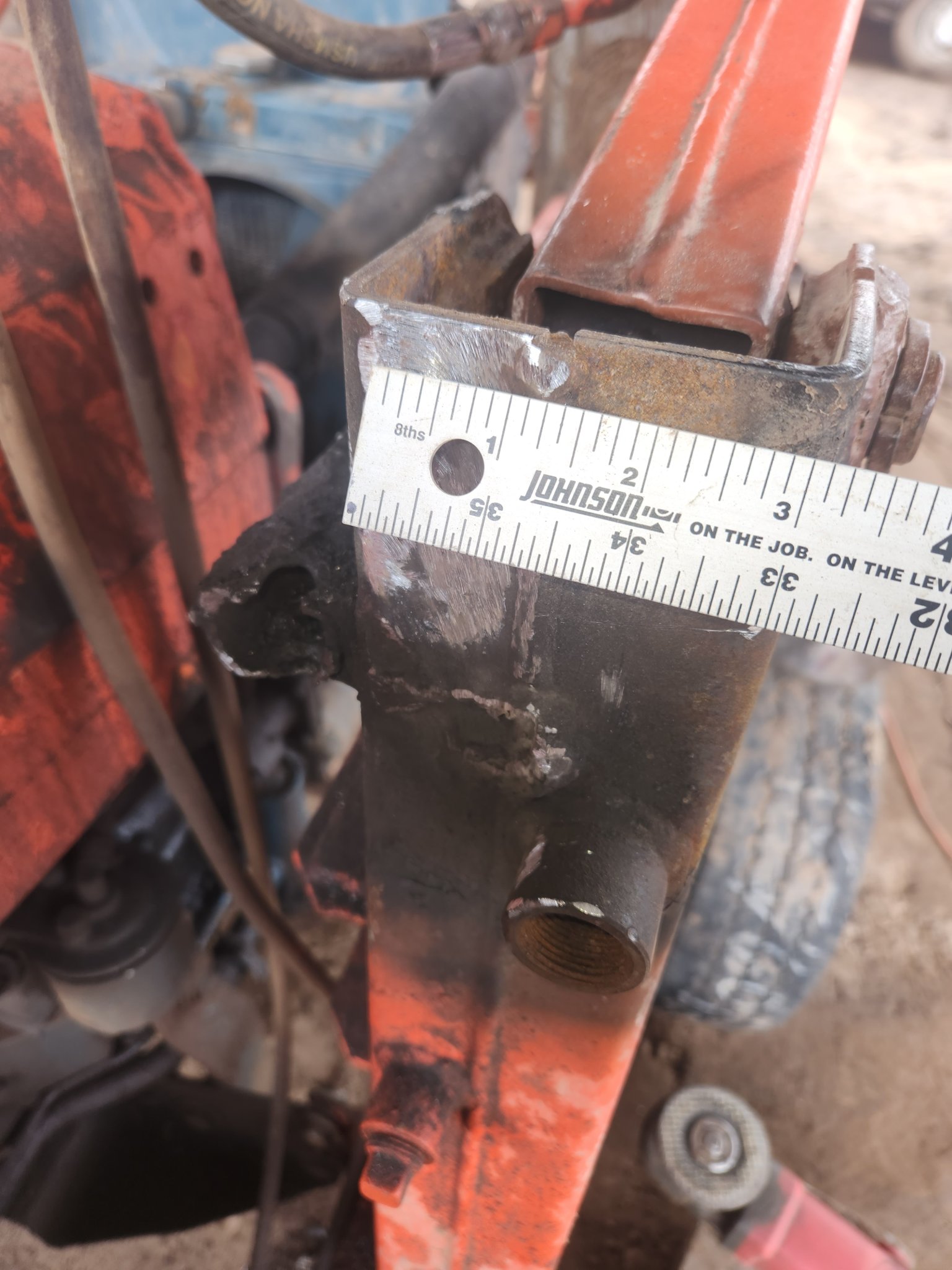

front frame solid, fix your busted weld
glue thread for bottom nut
frame bolted solid
stand on frame, solid

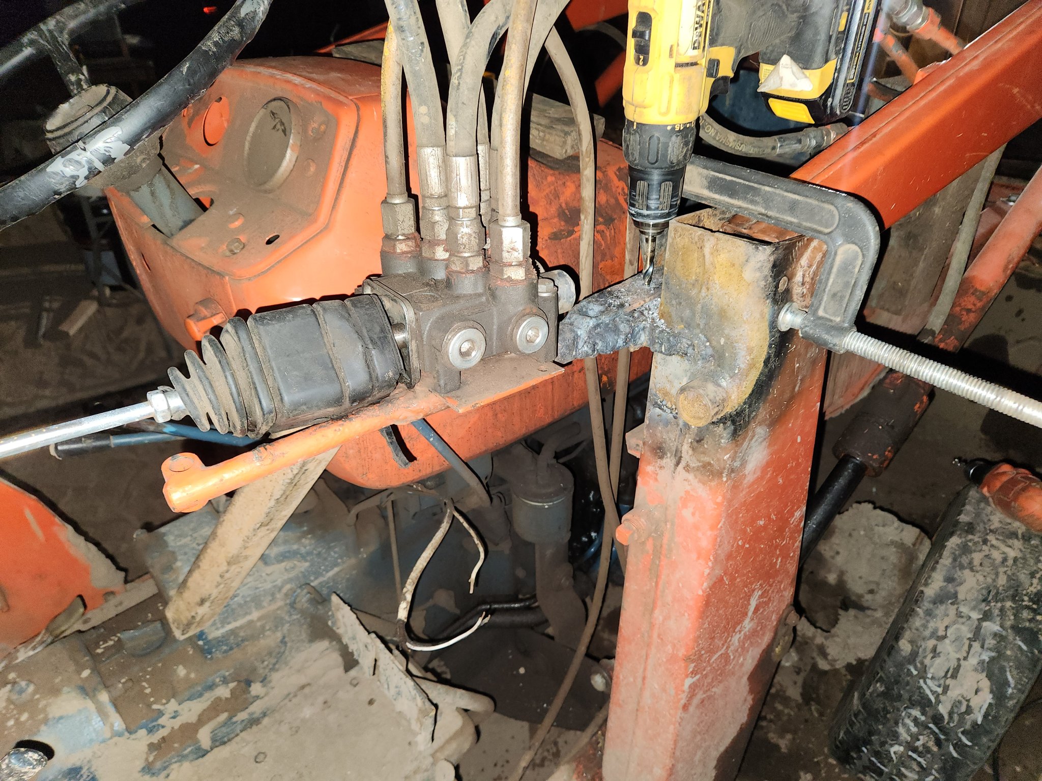

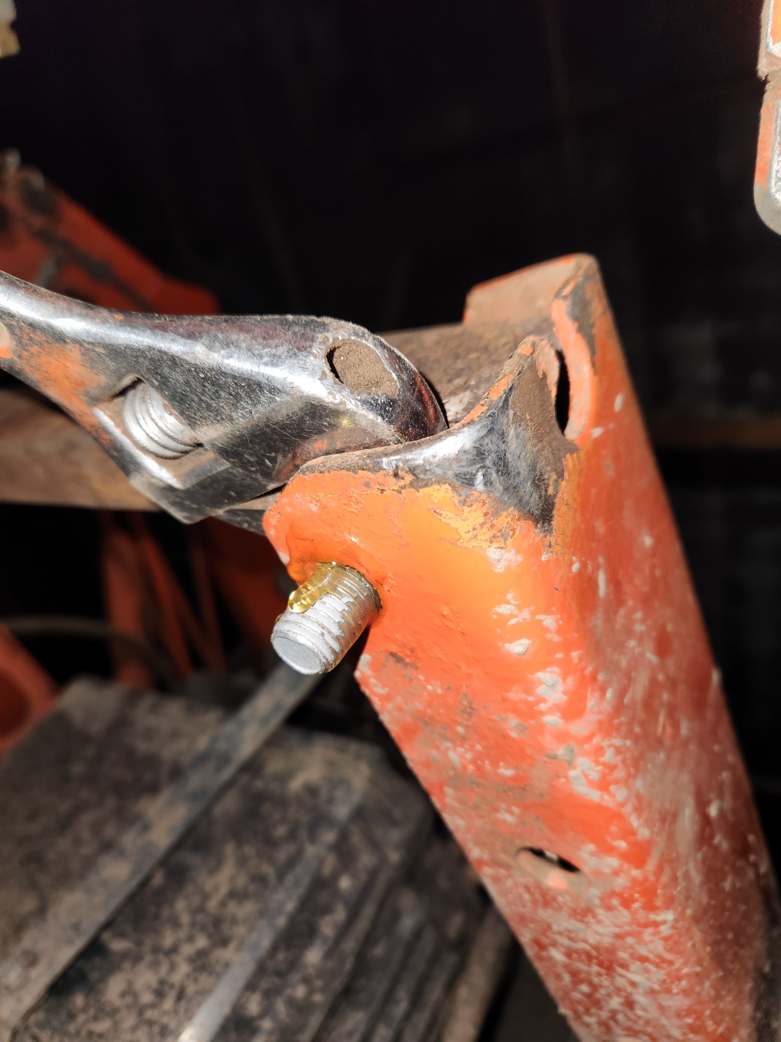

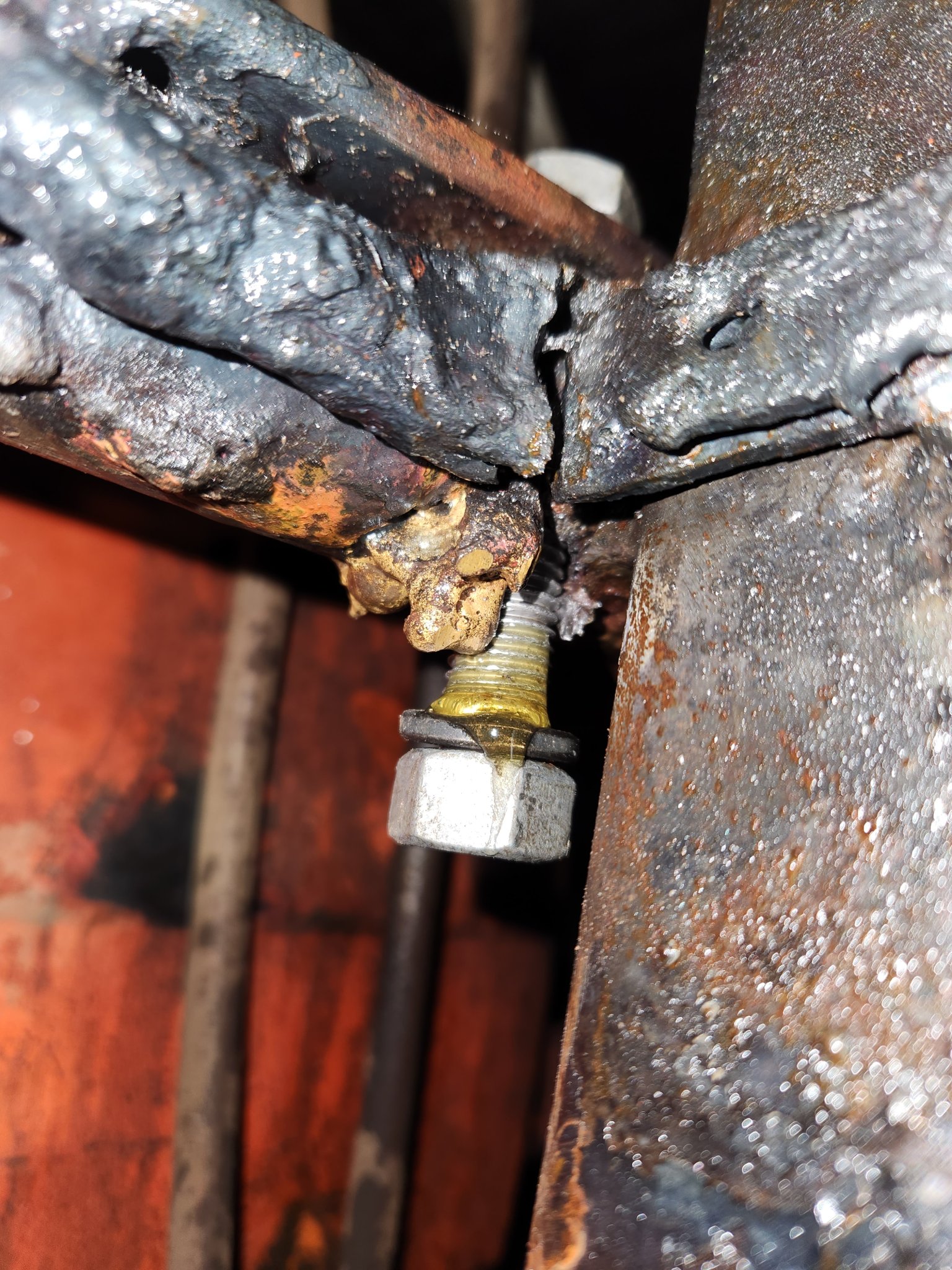

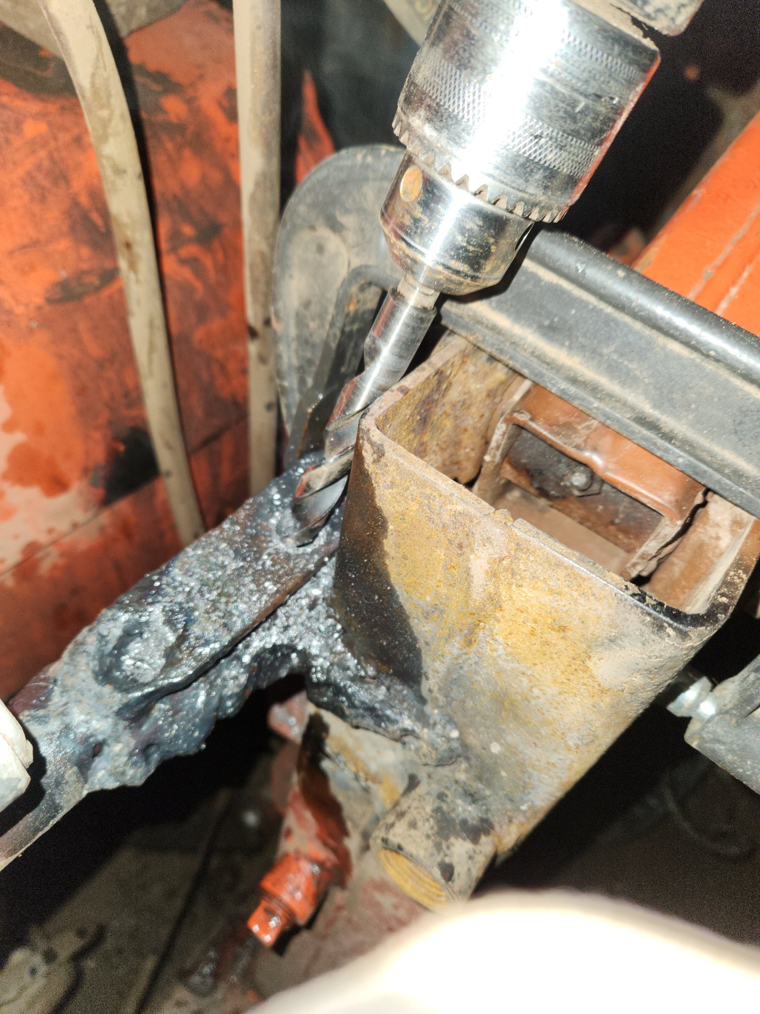

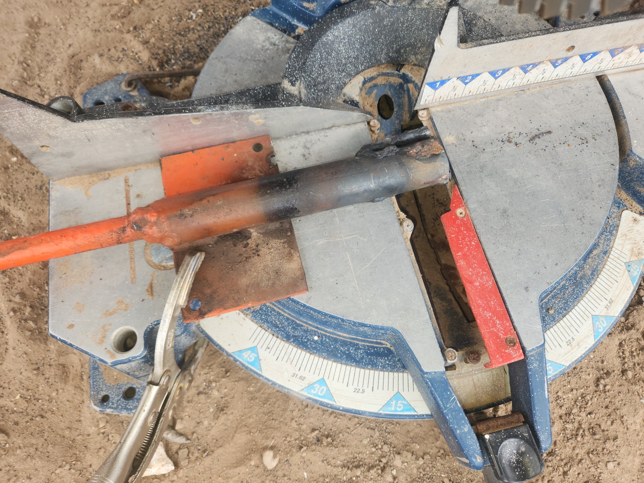

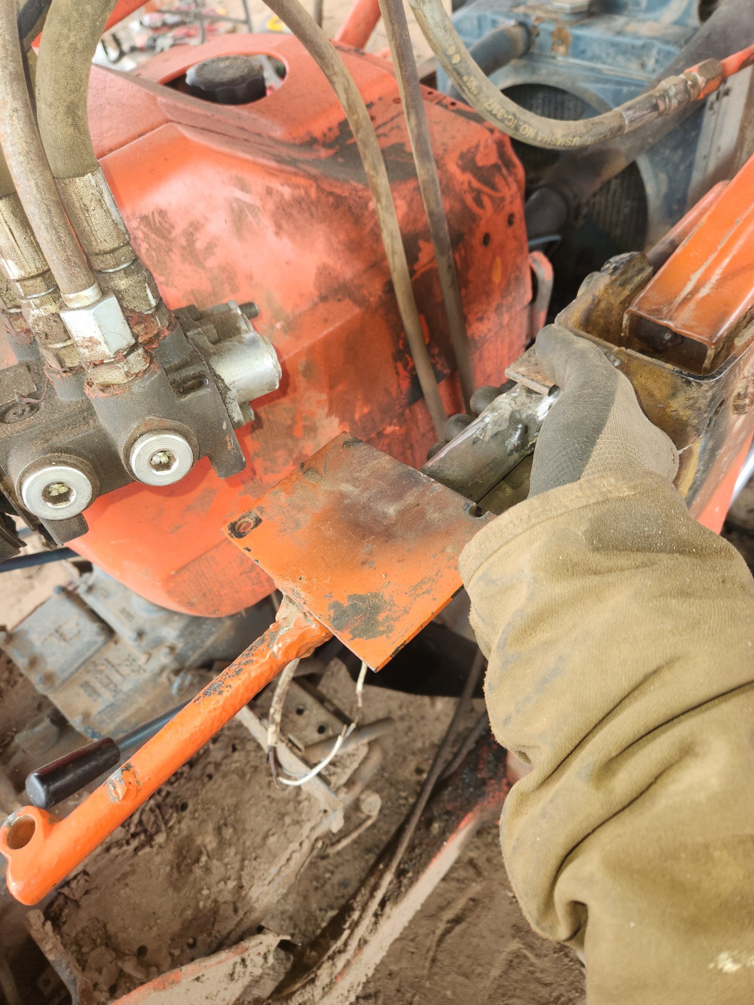

busted fel plan: prop it tight, hold it with big clamp, drill out big hole, put you a big bolt
prop busted fel valve with square tubing and big clamp, drill your hole with pilot then big drill
drill bit too worn, smother it all with diesel periodically, drill through with your busted bit
keep drilling keep soaking diesel
put your bolt through
smother in glue, put nut onto bolt
keep tightening, fail
your bolt broke the entire weld
come you up with different plan

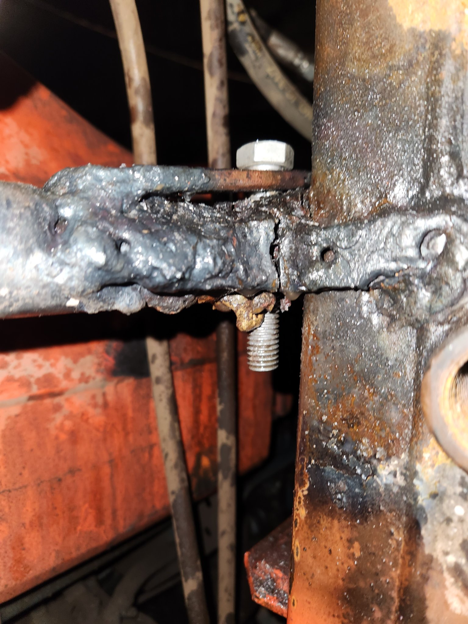

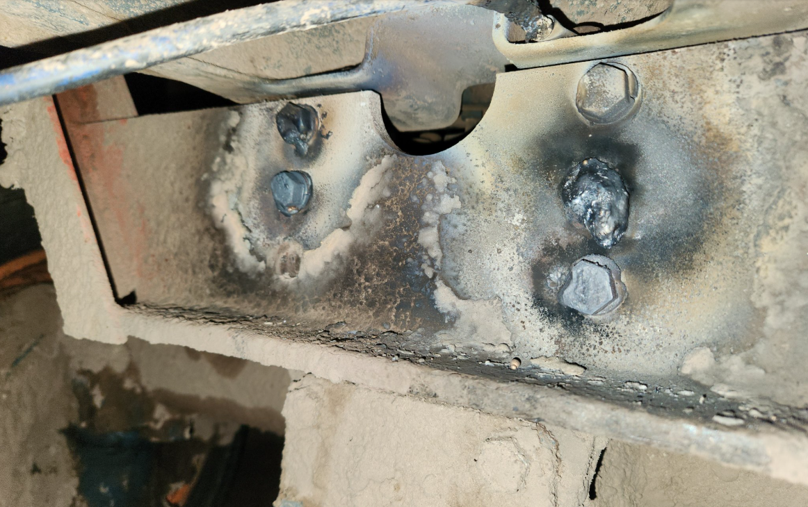

I should clarify why welding the bolts was such a bad idea.
When they break or loosen you'll play all heck to get them out.
The lock washers that were spring hardened are now soft, so they are no longer working.
The welds have done nothing except soften the bolts or fatigue them, and the welds will not hold.
You don't do anything to a fastening member that you can't easily undo.
What you could have done was make a thin metal plate with tabs that could have been bent to the bolts to lock them in place, then when they needed removed you simply bend the locking tabs and unscrew the bolts.
Joe, your completely working against yourself to keep the tractor together and running.
You send all your time repairing repairs, because your not making effective and lasting repairs.
I was dead serious that you have spent more time and money doing bad repairs.
If you would do proper repairs you would be so much farther ahead!
I have the utmost respect for anyone thats trying to fix and maintain on a budget, but listen to good advice!

Problem is that Joe is 100% advice resistant. I gave up trying to give him advice. Waste of time. Let him do whatever he wants to do. The only sad thing is the Kubota tractor being messed up, but that is beyond repair at this stage anyway.

I just can't continue to look at the "welds" that are being shown in this thread. I would go as far as to say that this thread repeatedly shows the worst "welds" I've ever seen. I worked for a decade as a certified/coded welder and have continued to weld regularly over a few decades since, and frankly this is just painful to watch.
In my welding career I've encountered everything from exceptional to excruciating and it's very easy to make snide remarks about someone else's work, but you don't always know the conditions that they were working in or the equipment they were using. Making a nice weld under ideal conditions is as easy as falling off a log, and clearly the conditions here are not ideal, but for me there is simply nothing to gained from this thread. If the OP were listening to advice and trying to do a better job, then maybe.
I'm no longer interested in any aspect of this thread.

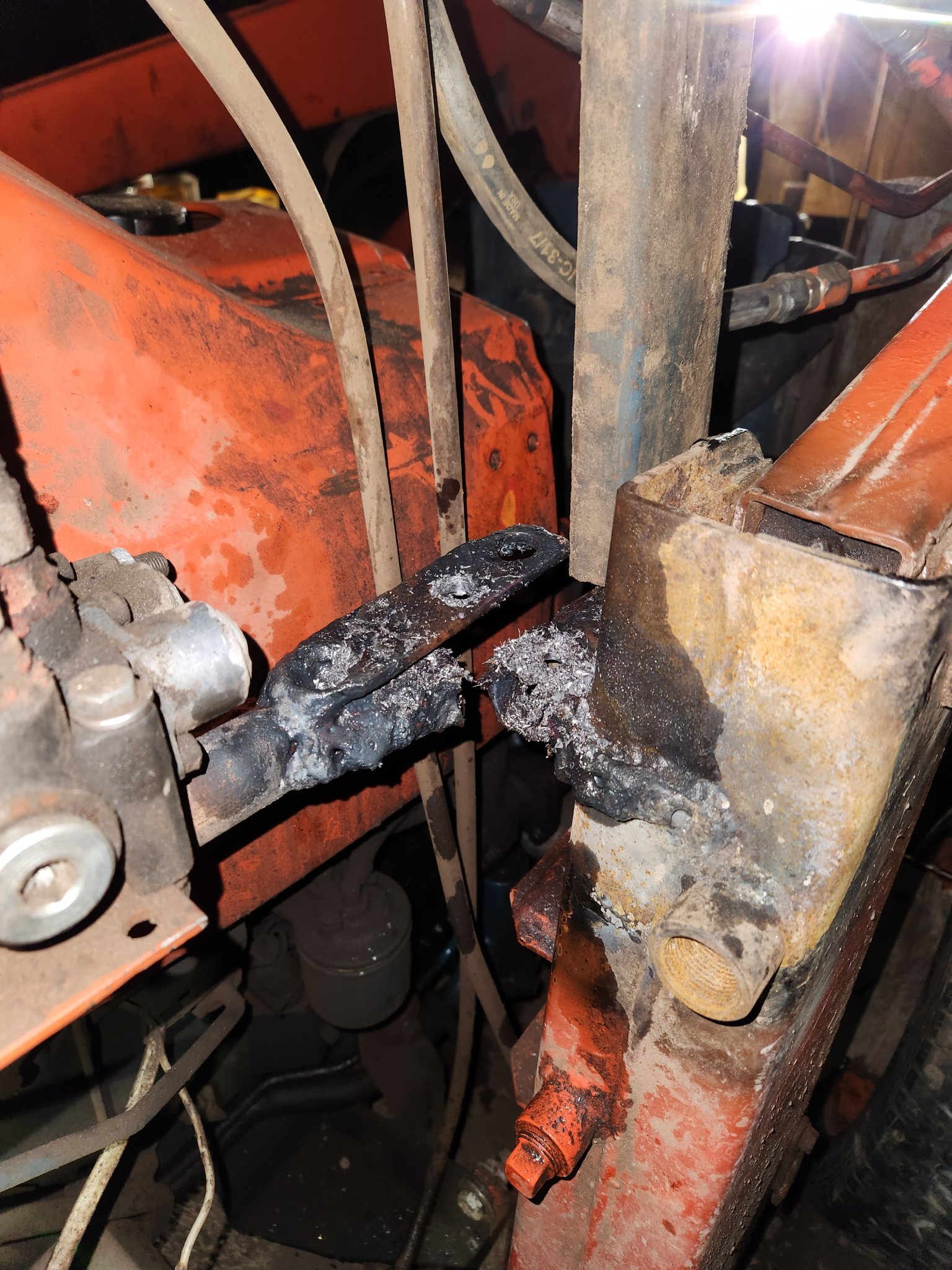

fix busted fel valve without welding, cut everything flat, come up with good plan
maybe: slice all metal flat, make you a 90 out of that thick steel, then
put bolts on fel rod and onto your big steel support, figure it out

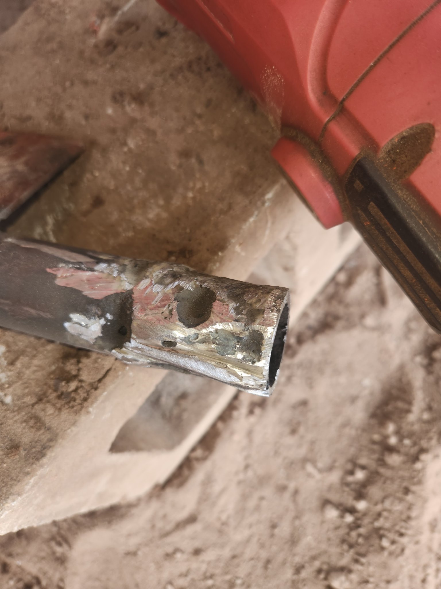

take base off fel valve, slice it flat
grind down all the bad weld
measure to cut your bracket
slice a bracket
mock it up

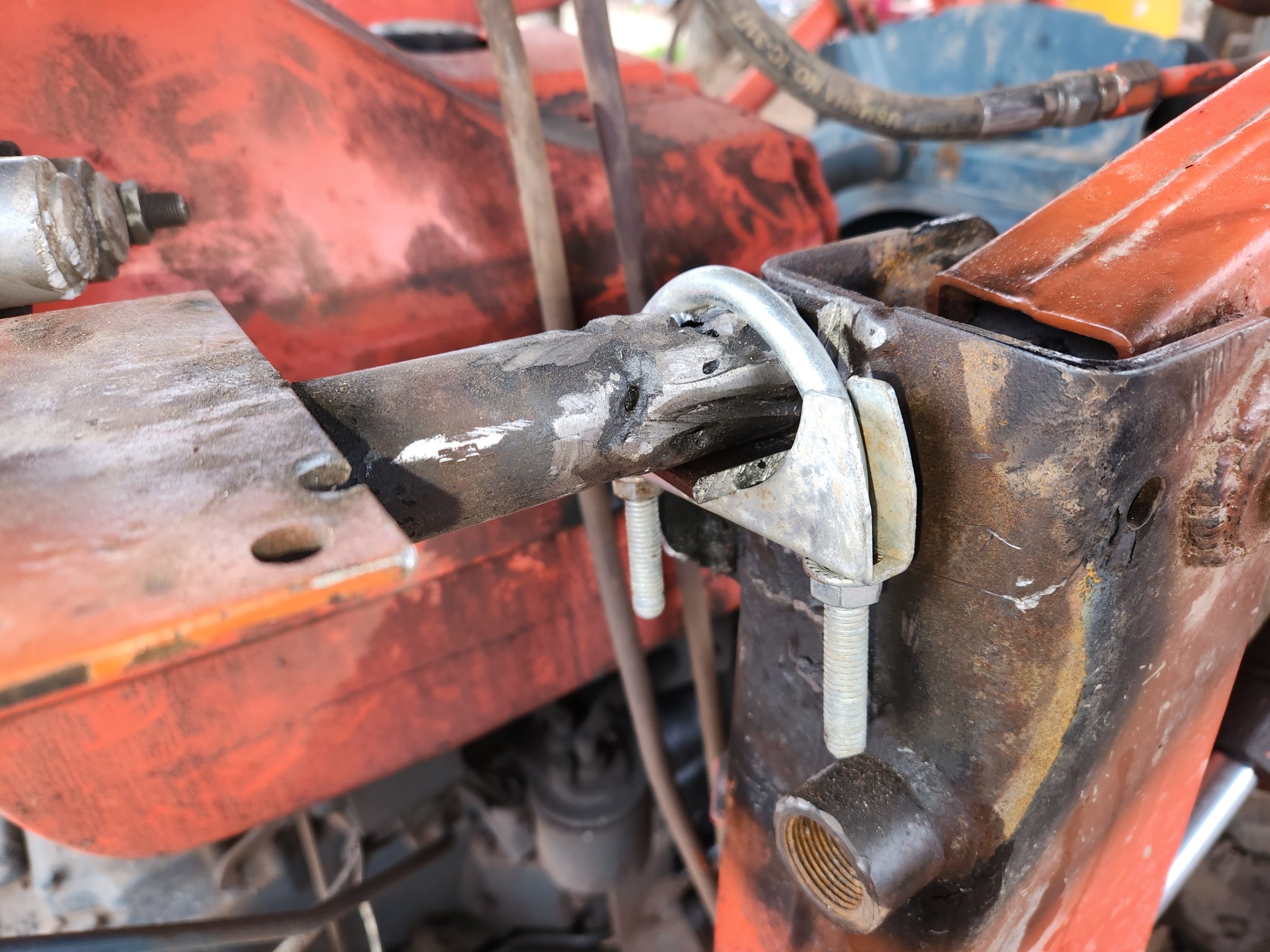

tried drilling hole on the fel rod, nope, keep breaking bit
thick steel in there you cant drill through
found an exhaust clamp, not holding well
busted fel won again
you cant figure out to fasten it permanently without the thick metal welding

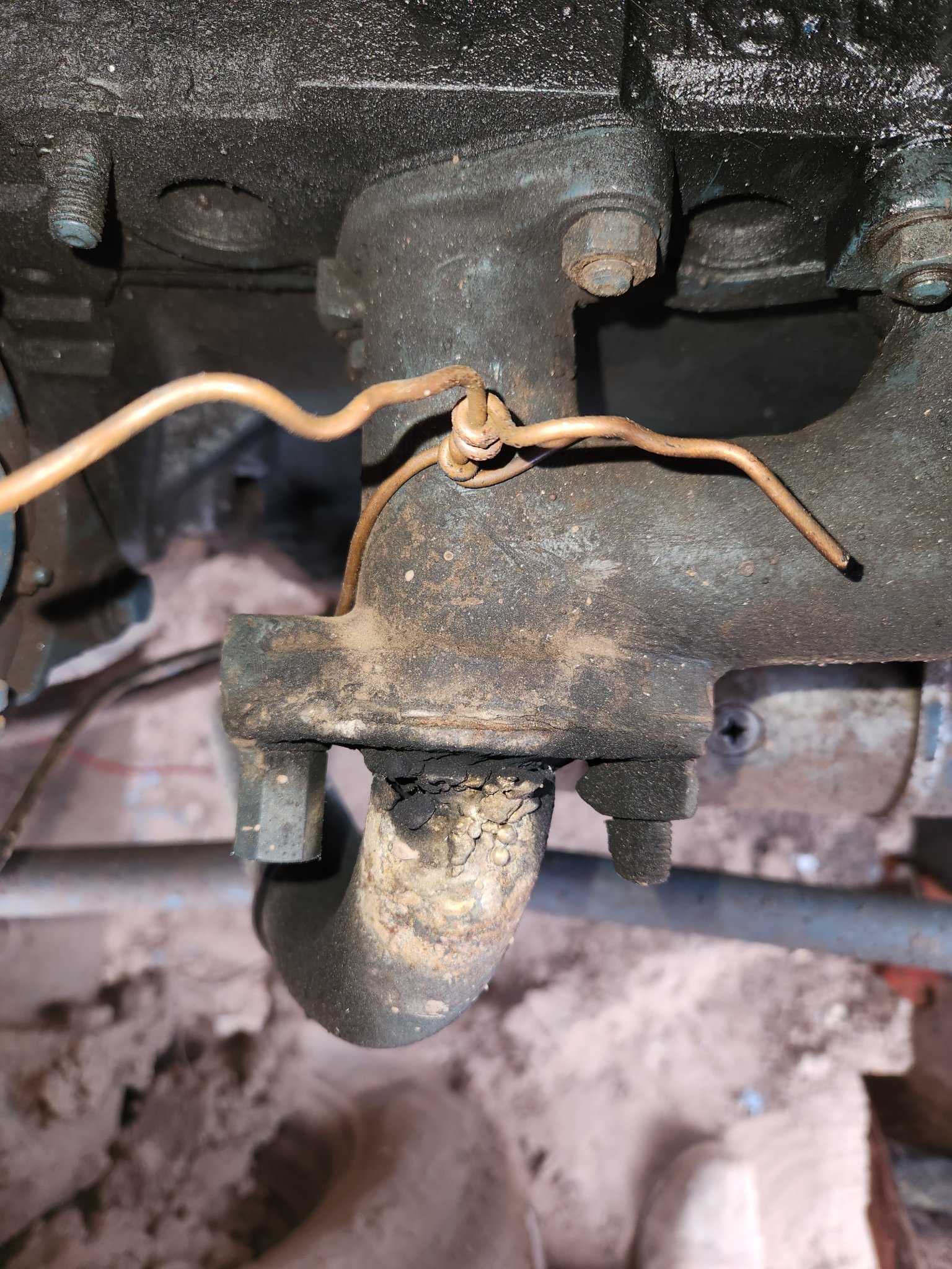

take your L on the busted fel rod, melt you some bronze on your busted exhaust manifold

Joe,
Glad to see your considering an alternative to gas welding. You had me and then 'Lost" me when you started welding cracks and chunks of steel to your tractor in the fashion you were.
I say this in sincerity , have you considered taking an adult welding class at the local (maybe not so local in your case) tech collage? Getting some real hands on instruction would be worth it's weight in gold. Youtube videos and internet advice can be good but does not replace face to face instruction from an experienced welder.

I too, am glad to see you considering alternatives. I've owned commercial grade welders for 40 years, until I retired and sold out. Welding wasn't my profession, but when you run a shop with a dozen pieces of heavy equipment, you do a lot of your own repairs. Since retirement, I still like to stick things together at times, and so purchased an inverter welder, that does tig, gas and gasless mig, and stick welding. It will run off my 220 volt 5,000 watt generator when need be, and the cost was right close to $200 on sale. Obviously, when hard wired at home, I can crank up the amperage and weld thicker pieces, but out in the field, if you don't over do the cycles, it is surprising how good the little China "toy" performs. Instruction would be beneficial, but I'm pretty sure that is not going to happen here. However, with one of these inexpensive machines, I have no doubt, some very strong 3 pass welding could be accomplished after very little practice. These little things are the easiest way for a novice with little resources, to accomplish structurally sound repairs.

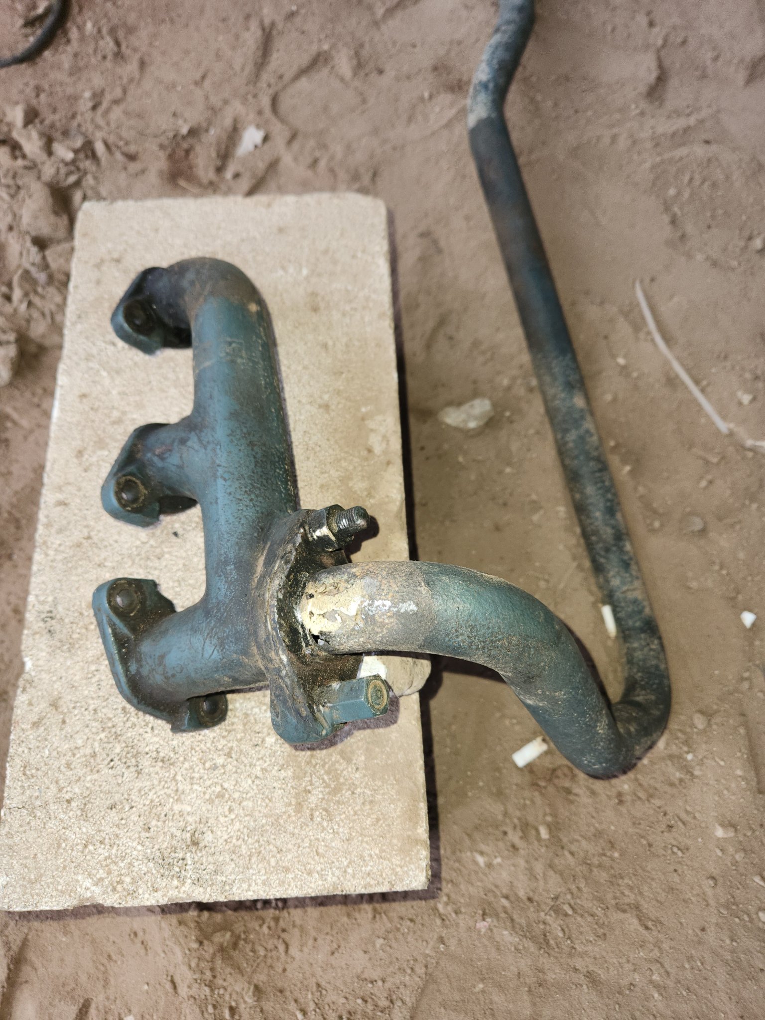

weld busted exhaust, fix other tasks
take out entire exhaust, grind your welding area, clean it, set it up the way you want to weld it
use a higher acetylene flame, use a nail as filler, bronze is weak, melt you big puddle around entire break

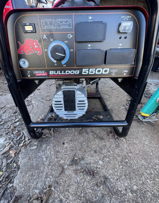

You do NOT want stick, you want MIG.
A MIG welder, can be run off a smaller generator.
Mig is much easier and quicker to learn how to use it properly.
You can weld metal in a much wider range of sizes, from your exhaust to your loader frame.

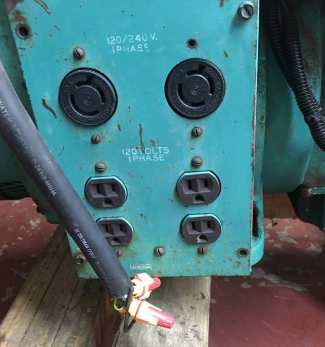

He wants a stick welder, it's cheaper, the rod is also cheaper, and there's no MIG feeder to clog up, no tips to replace and no expensive gas. Remember his "shop" is "uneven dirt," a feeder will jam constantly. Plus, instead of welding rod he can use coat hangers. Or a bolt. Or an old fork... 👨‍🔧
34,342
9,579
You're 1,000 posts late to the party... :ROFLMAO:
Have you ever tried and run a stick welder on a generator?
Doesn't work well unless the gen is very large!
Agree with the no clog and tips, neither of which I have any issue with and I used my mig in condition similar to joe.
You can also do flux core (gasless) wire, but a small bottle of gas if far cheaper than what he's been paying for acetylene, and one bottle lasts me a long time.
And yes I know, my advice is probably never going to reach joe, but maybe someone else is reading this and using it.
I have, and it takes a big generator. I bought a 14kw 30 hp generator to run tools and welders in my old barn without electricity. You need a 50 amp 220 plug for my stick. My generator puts out 55 amps but that's only required on the high setting of the welder. I think Joe just needs to find a mobile welder for the next job. It's too late for this machine because it's beyond proper repair at this point but future machines with problems should be noted and addressed at teardown. Then properly repaired before final assembly. This thread has been how my 10 year old grandson would have attacked this build because he wouldn't listen to anyone at that age. But at least now he has learned that you can find out how to fix anything on the internet 😆 and still doesn't listen.
It's fine, you should see his solar wiring, and the stuff he tries to run off it.

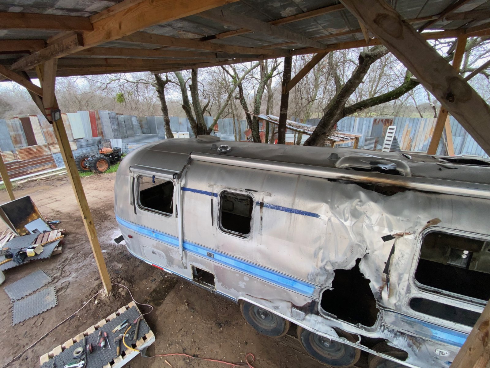

Joe's Airstream content:
"Joe Smith" posted:
At this moment, the 3 big things I am trying to figure out (feel free to critique/give advice):
1. I want to build a metal frame around the exposed wheel well. My plan: Build a metal structure out of square tubing (1/2'' size), then use either metal or aluminum sheeting and fasten it to the metal structure, then spray rustproofing above the tires onto the new metal to seal it up from the weather
2. Locate the proper aluminum that will be used to cover the burned aluminum to seal the body of the airstream
The right way to go with this one is maybe to go with whole other airstream that is donor unit, like someone mentioned
The cost of aluminum nowadays, it might be cheaper just to get a whole other airstream
3. Windows: The cost of one airstream window is more than I paid for the entire airstream
My plan: Get similar sized windows from facebook marketplace/craigslist and fit them into the holes
only hold up on the mig: every video I see of them sticking together THICK steel, they always are doing stick welding, higher amp
and some of them say that mig welding thick steel is not as reliable
but I am still considering mig (just because you recommend it)

wow, check out a 1973 diesel Onan, 12000 watt, can do 240 volt, for $1000
this thing an absolute tank, and could power your stick welding off grid situation
for about $1500, you can completely solve your big steel sticking together problem, where
you get a big ol generator, and a quality stick/arc welder
