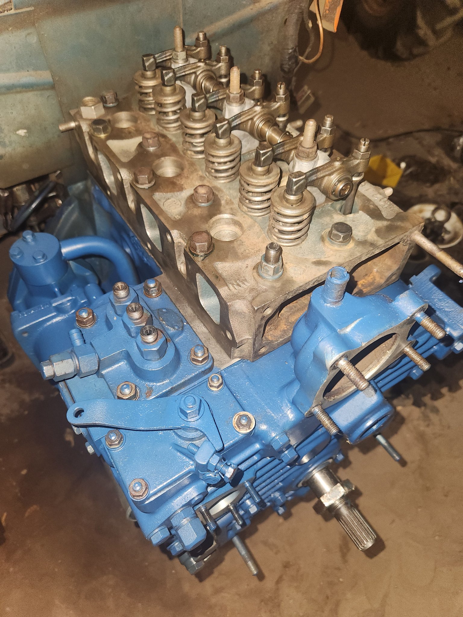

Hand sand head hardware
Bucket of diesel, hand sand all crud, especially off the top of bolt, 1000 grit sand paper, then dip parts in part cleaner
Forgot to install those 6 small cylinders, took head off installed them, now put head back on
Rhythm: dip hands and bolt into solvent, dip end of head bolt in some clean grease, hand tighten

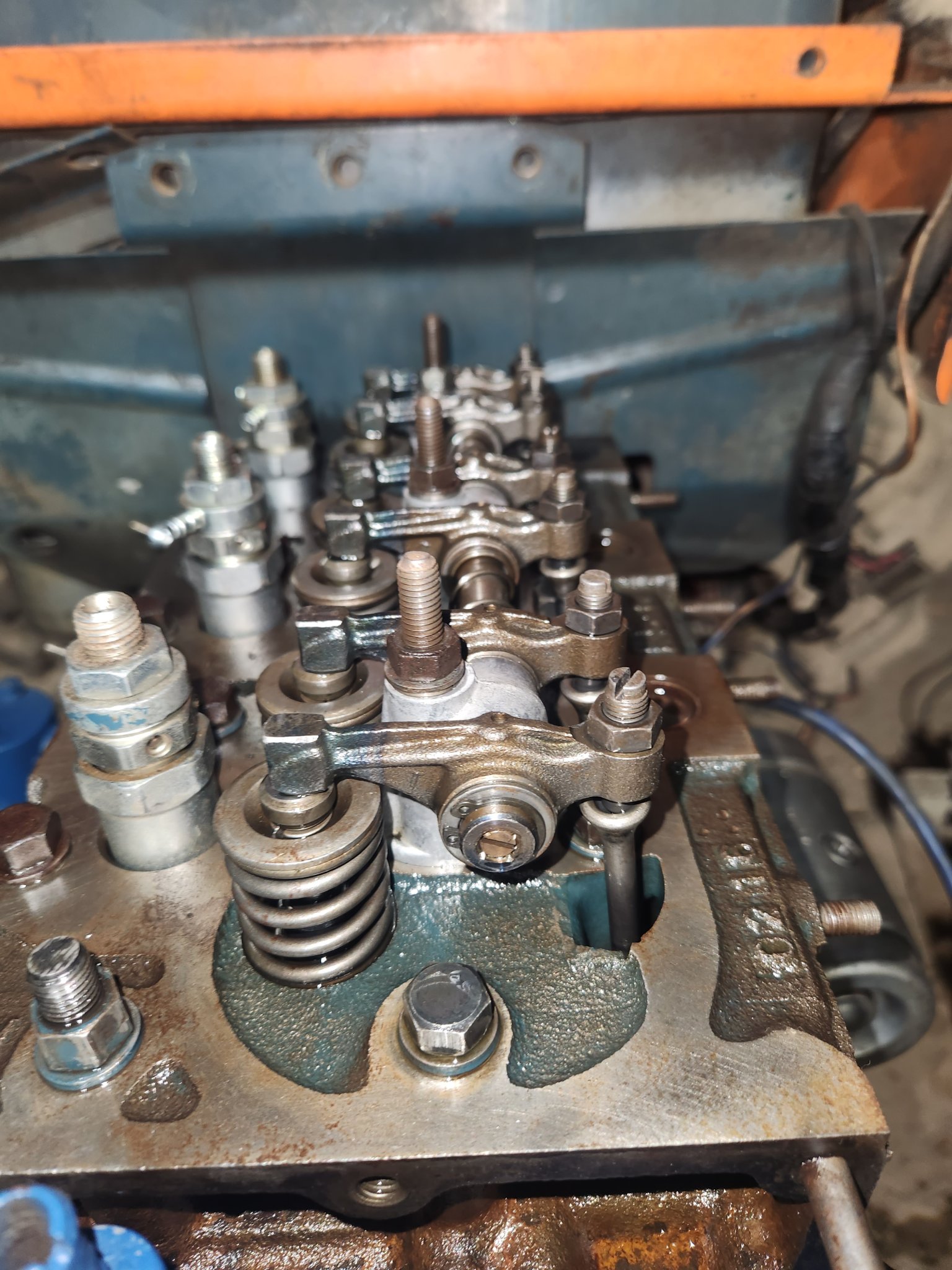

Per diagram: they call for stud with plain washer for front and rear of head
Do I have head studs in proper location? I can't find the right washer for that rear stud, I might put spring washer then that big washer
Up close of what I had torque wrench set to, they call for for 58
That bolt when I had split washer, would tear through split washer, had to go find regular washer and finally tightened it to spec
Cleaned phaser, figuring out how it goes on and the hardware, look at diagram now
Almost forgot these little caps go on top of spring
Tightened phaser bolts to 15 foot pound
Moving slow trying not to forget any hardware
I read yalls statements about washers, yes they do seem a bit off
Up close of diagram: they use 190, 190 is PLAIN washer, not split
Either I mixed the parts or it was installed improperly
Soon I go search for plain washers and just use those, and maybe take off those big washers if they are blocking the head cover

By the way, it is critical to tighten head bolts in sequence shown in WSM; do them in stages; and have the bolt threads oiled. One of the few places that really need the torque wrench.
dragfan66
B7500 Z231KW G1800 L3350DT
Apr 12, 2020
65
74
Alabama
Make sure those washers you are using on the head studs don't interfere with the valve cover and gasket installation.

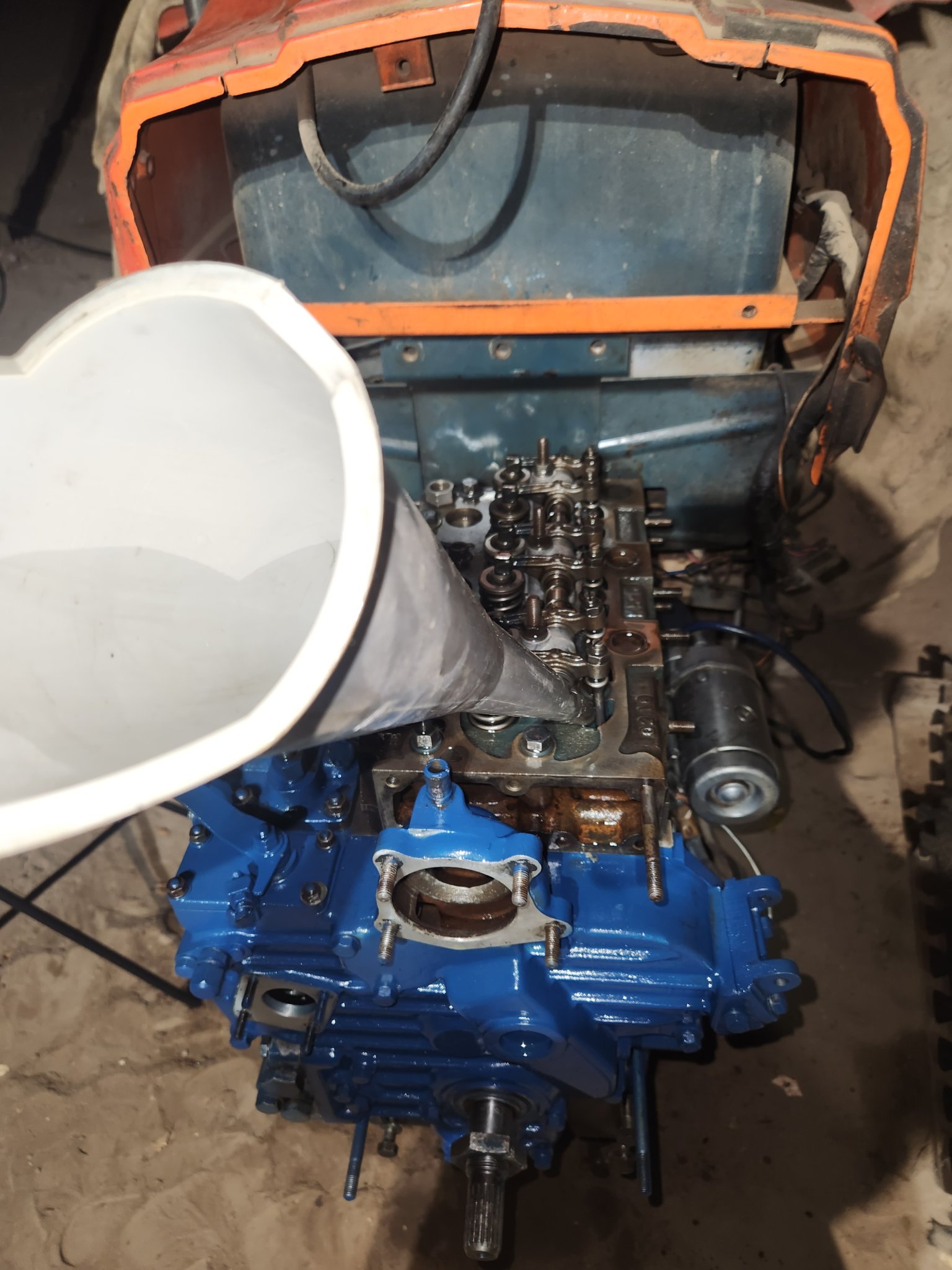

Fill it with half gallon engine oil, give 12 volt to starter...
Poured whole gallon oil into engine using funnel
First test with starter
Now: get bx1500, run jumper cables, do 2nd test
2nd test with more power: shot oil out the side
Put hardware on that hole and run another test trying to make it shoot oil out the top
Up close of diesel and oil mixing coming up from bottom of engine
3rd test, oil gushing to top

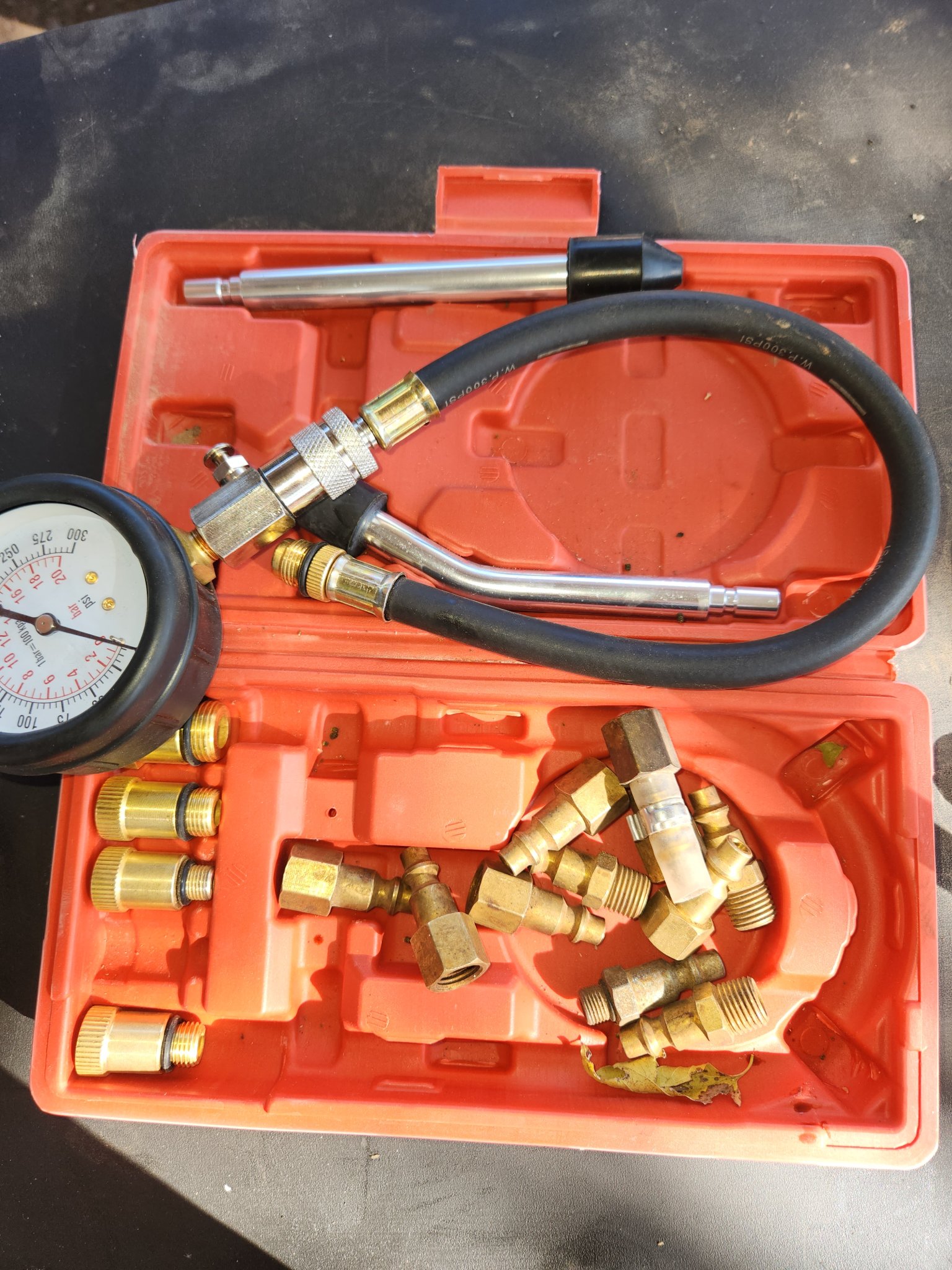

None of the fittings fit tight into block, might put plumbing tape if it leaks
Put plumbing tape, ran compression, sits at 250, staying still after 10 minutes
Cylinder 3 won't make it past 140 psi
Cylinder 1 almost at 275 psi
Diagnosing cylinder 3, why compression low: I did not put new rings on that piston, it is the original piston from this engine, 500 hours, there are brand new rings on piston 2 (275 psi) and piston 1 (290 psi)
The engine head has no damage, could it be the adjustments on the phaser? I think it has to be the piston rings
First, get a proper fitting that fits that hole, either make your own or find the right one

Tried all kinds of combinations with air fittings, cannot get anything to thread into block reliably
yes, i search through this forum, @D2Cat said it is M10-1.25
Now, I search for a kit that has this exact thread, AND a gauge that goes up to 500 psi (they call for 450 psi per the spec sheet)
@Ktrim said: "backyard valve job" - yes, I will look into how to do this
Summary: get the right compression kit m10-1.25 that goes up to 500 psi, watch videos about adjusting valves, come up with plan to paint the entire chassis/engine in one shot (if possible)
shoot ideas from the hip about how I can paint the entire chassis/engine in one shot after getting the compression problem solved
Paint plan: take all panels off tractor, leave the back wheels on, clean the entire thing with the usual methods, then spray entire chassis including engine with the enamel paint
Here is a kit, that has the m10-1.25, and goes up to 1000 psi, $40

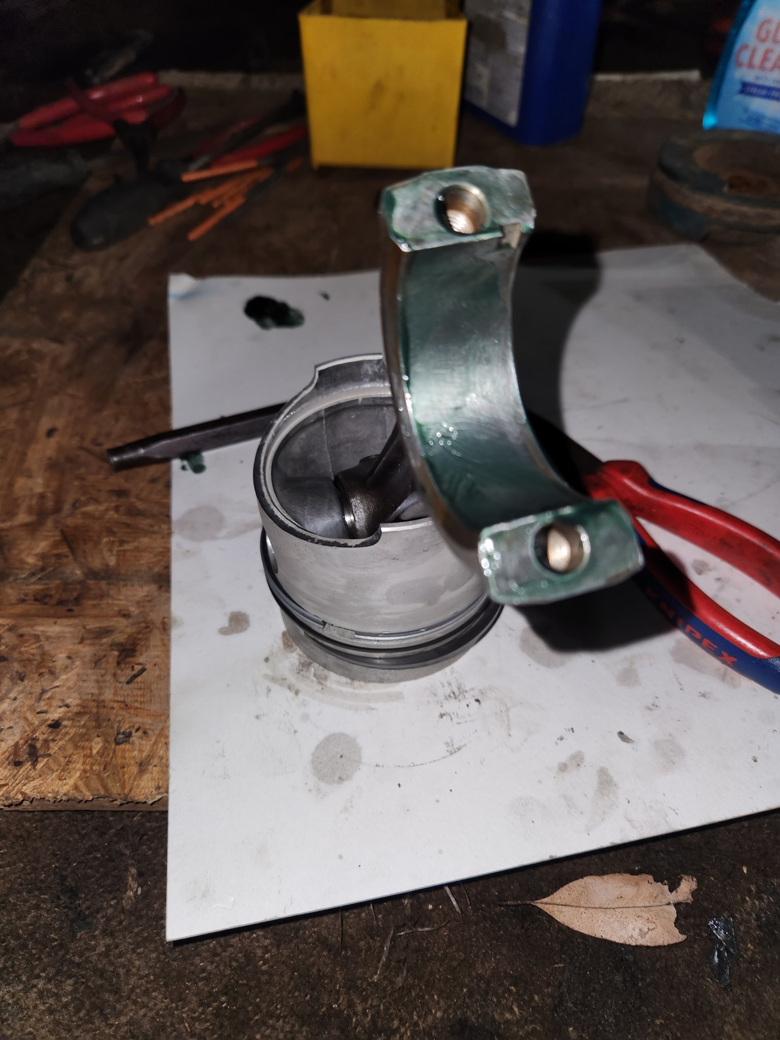

I guess take out top and bottom, pop piston out and put new rings
Cleared area, took off head
Drain oil, remove oil pan, remove hardware, pop out piston
Took out piston 3, I point to new gashes in connecting rod from hitting crank
As it was coming out, it was twisted a bit, take connecting rod from other engine, use that connecting rod

Lesson: ALWAYS change rings when you have pistons out (I even have new rings but was just being cheap/frugal)
"take off oil pan and head........"
And, of course,......reuse head gasket?
Ktrim
B2400, lA352 loader,3pth quick hitch/z122r zero turn/restored 52 farmall super a
Dec 23, 2020
444
369
Nazareth Pa
Easy to go in maybe a dead give away!!!! Always new rings when they are removed. And at least a back yard valve job to be sure. Again no one I know has eyes like a micrometer.

Cylinder 3 fixed, now has 300 psi
New piston, new rings, connecting rod from spare engine
Ready to go into bore
Installed piston with large hose clamp
Put top back on for compression test, now all 3 pistons have 300 psi
