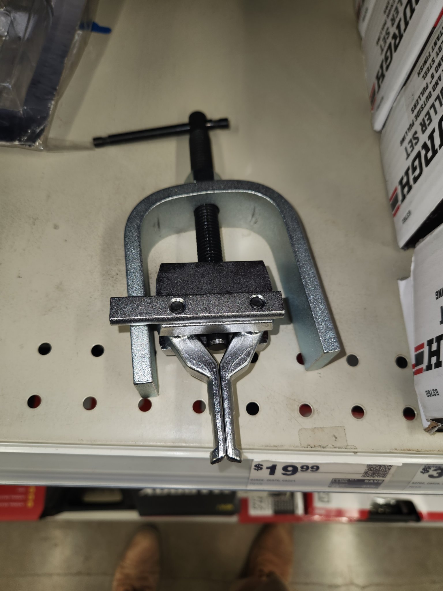

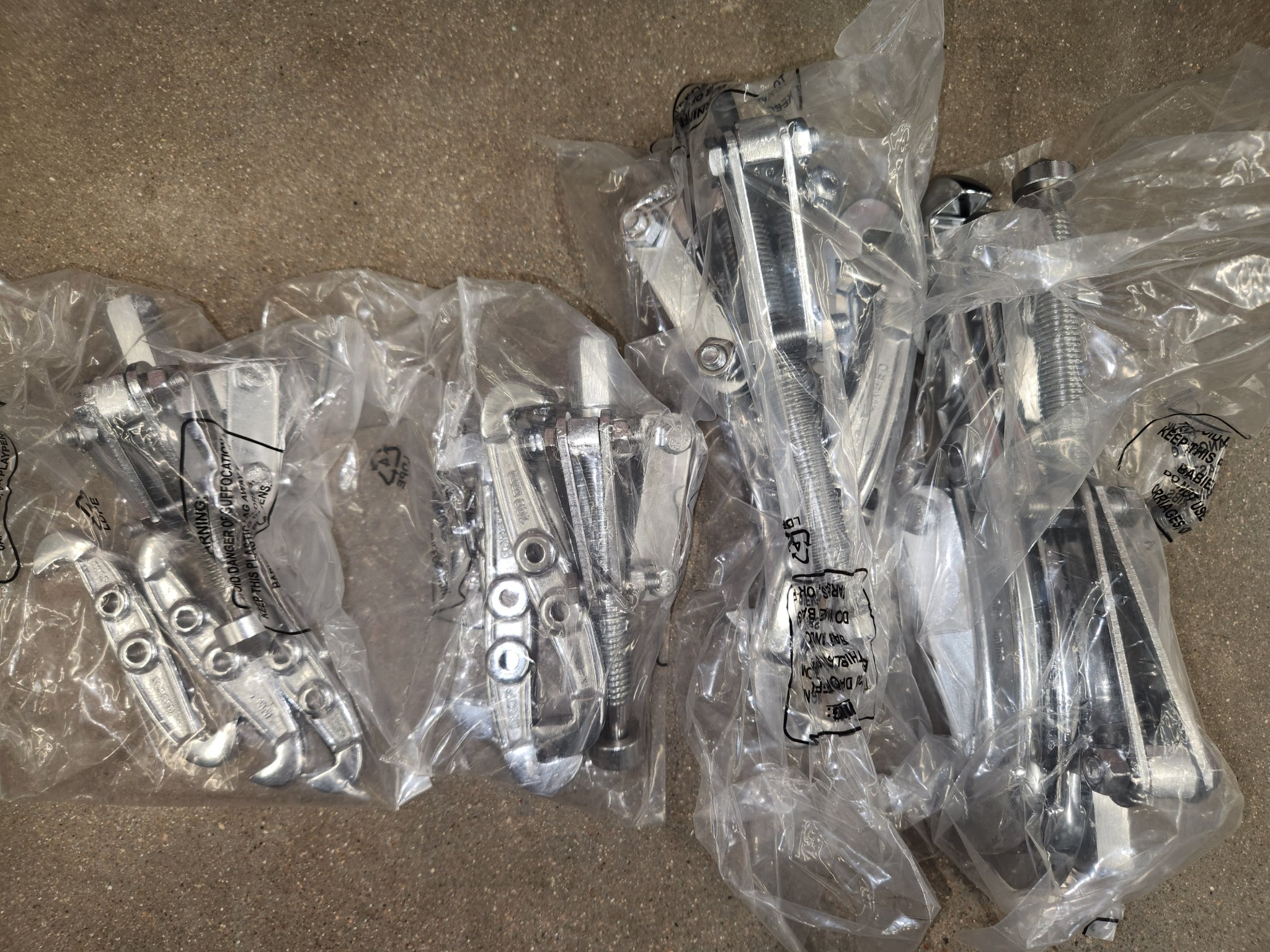

I am at harbor freight, closest thing I can find is the tool I show you in video
Do yall think it will work?
Or pay $15 more, and get this whole kit?
Only problem with this: I don't see how I can get teeth behind the bearing and grip it enough to pull it
Here is one for 30, someone did say slide hammer would work
Opened the slide hammer, I prefer the one I showed in the video

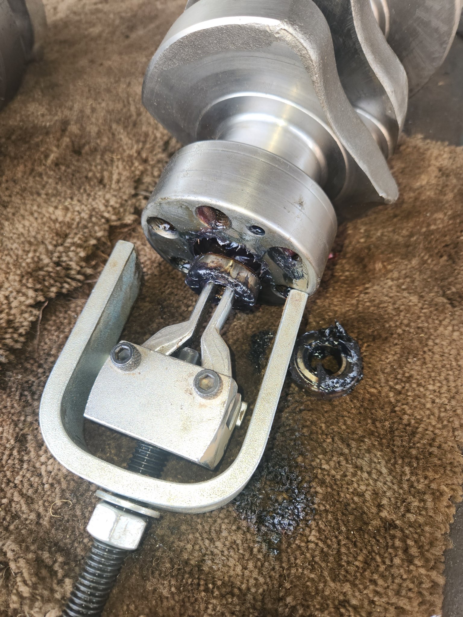

This one is exactly like the one that chim drew out for us, and it has that bridge to push onto the crankshaft
We give this one a shot
It says, "pulls pilot bearing from end of crankshaft"

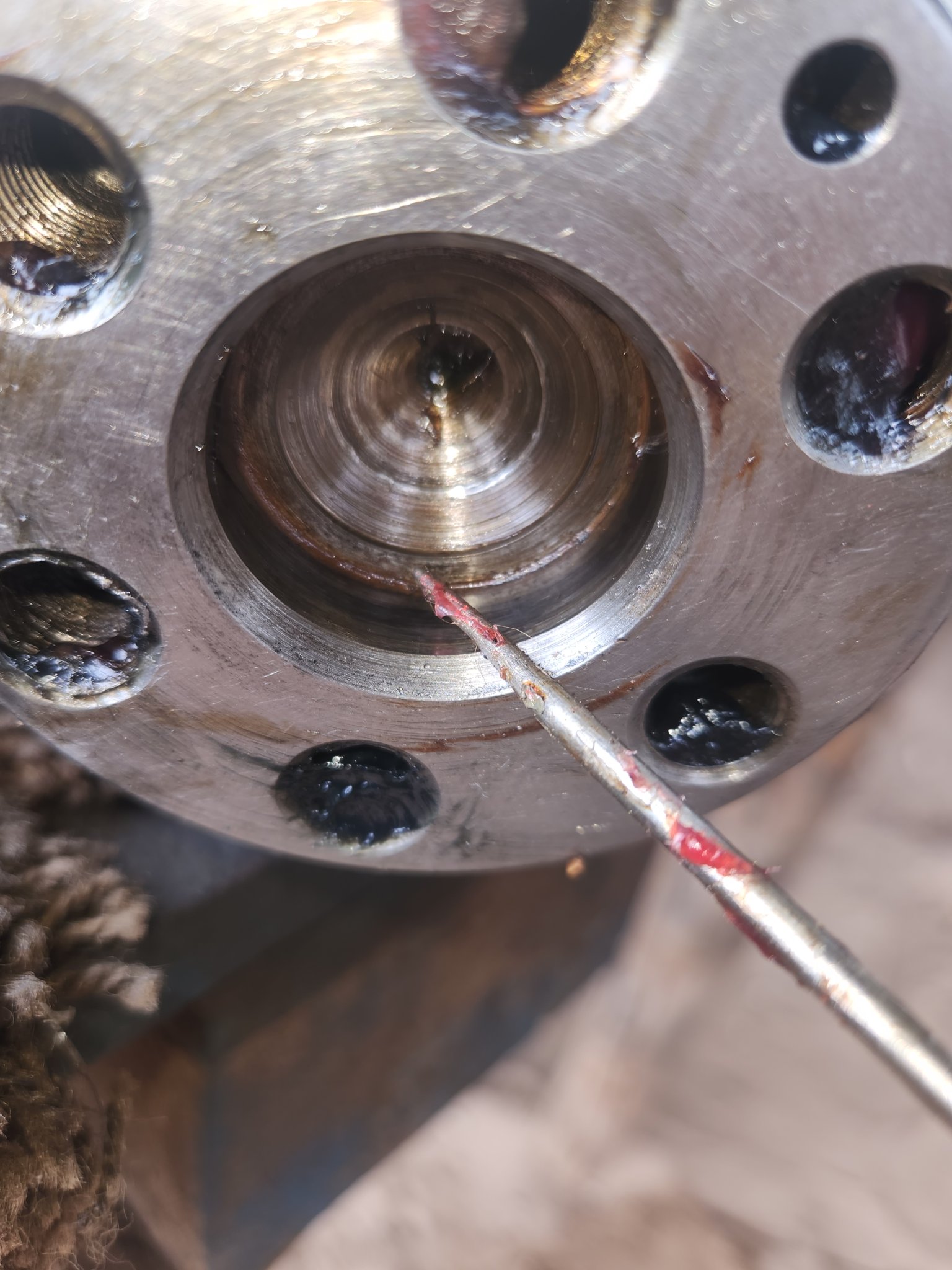

Got the 2nd pilot bearing removed
Pilot bearing on crankshaft with 500 hours was much harder to remove
Found the grinding noise when turning crankshaft with 2500 hours

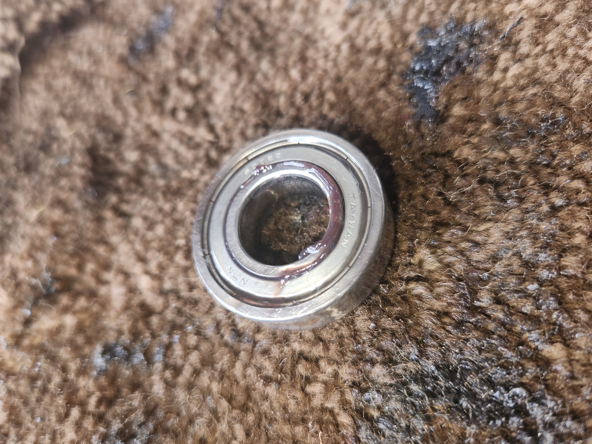

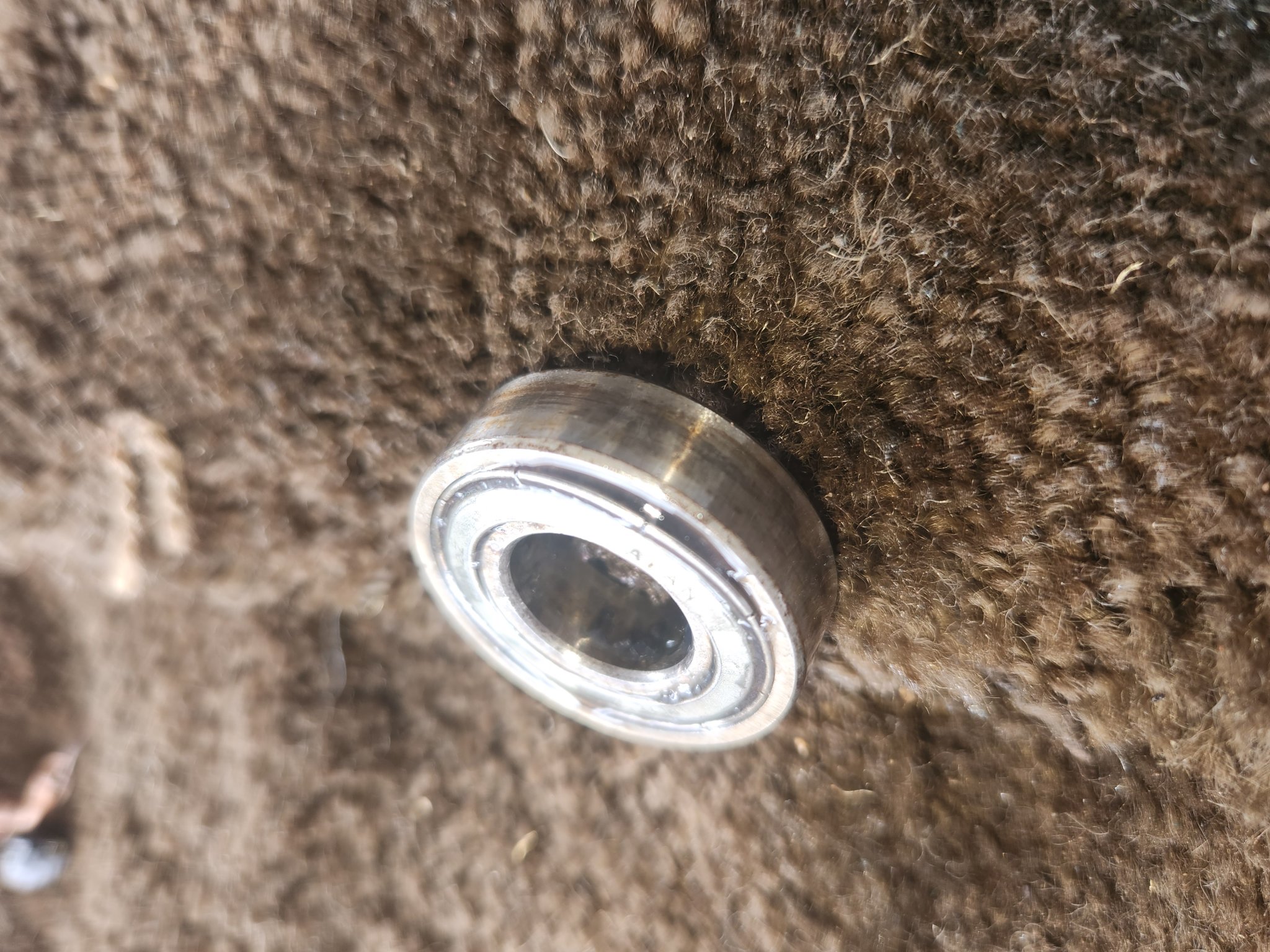

See how bearing is bulged? Damaged, seized bearing
Bearing from engine with hole in it
Spins a bit rough
I point: back of bearing seized to crankshaft, I hit with torch and try to chisel it out

That is like what I had shown you that I used. As long as the ends grip the backside of the bearing it should do the job. Take a video of you setting it up and pulling the bearing out.

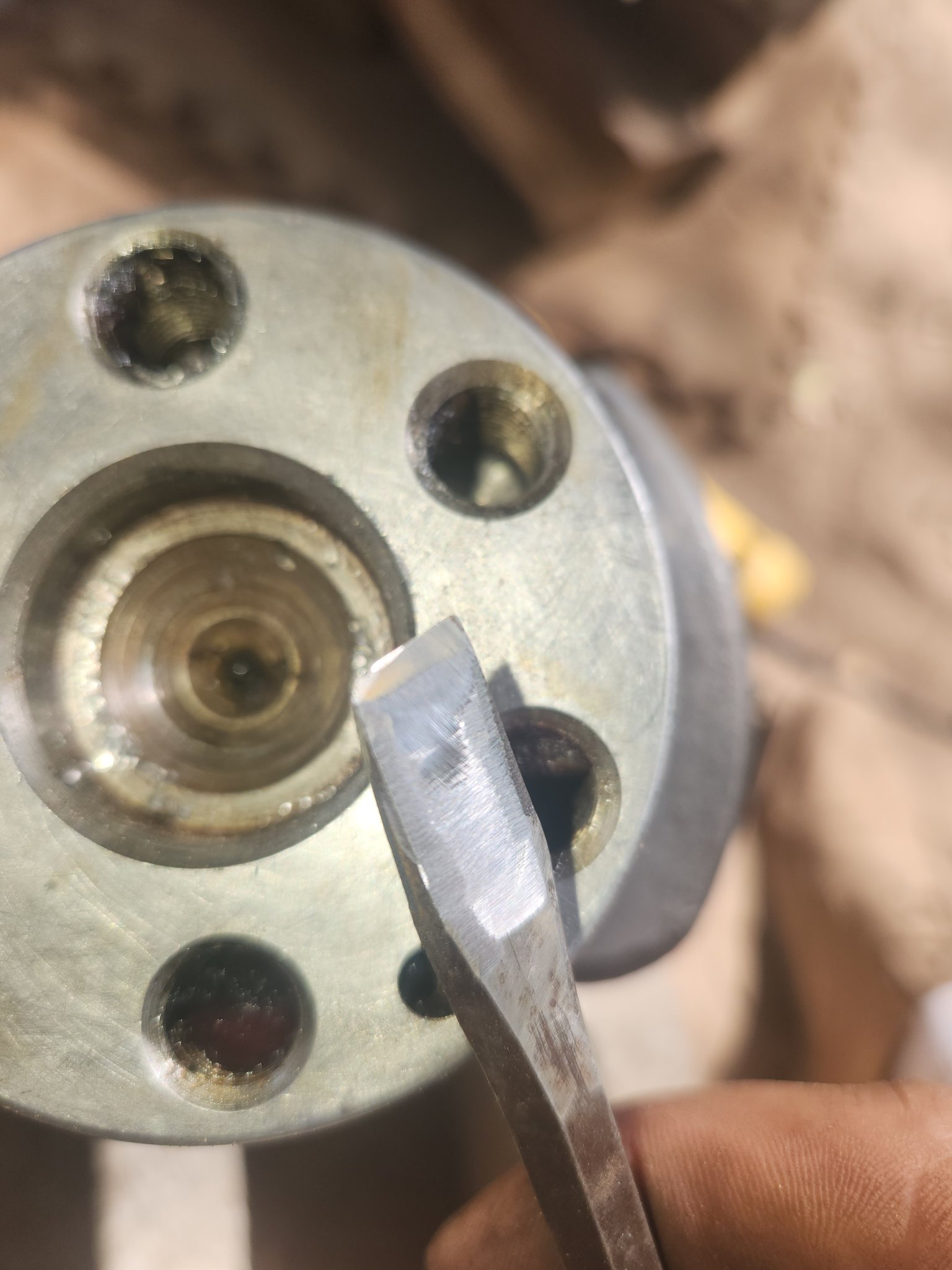

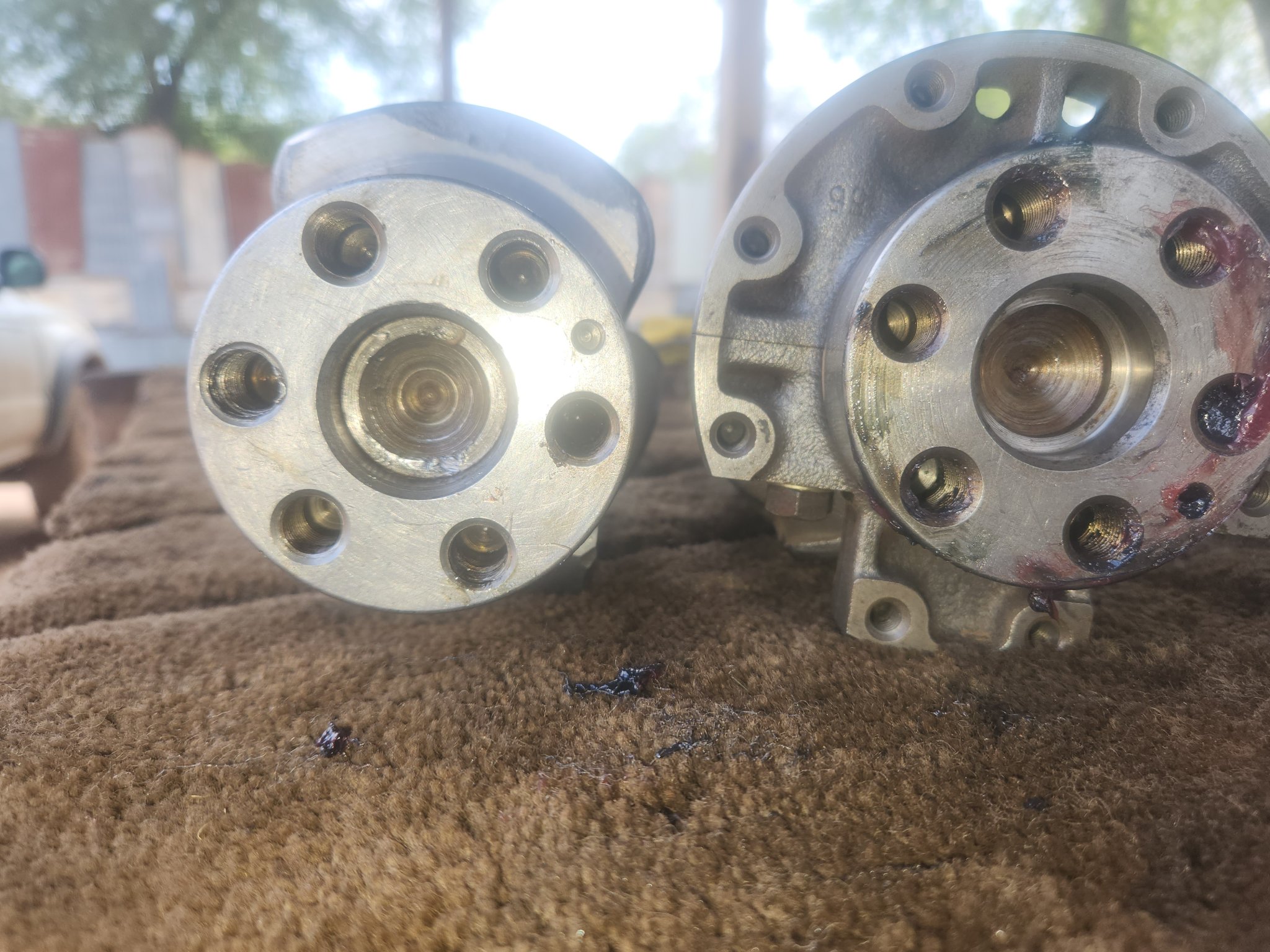

Chiseling at seized back of bearing onto crankshaft
Sharpened chisel with grinder
Trying to uplift it from crankshaft, can't, fully seized
Now: hit it with torch, fill it with diesel, let it set in, give another shot with sharp chisel and sledgehammer
Mistake: chiseled into it for no reason, that was the whole bearing without the back cover
Picture of both bearings: same size, meaning nothing is stuck inside crankshaft
That bearing just didn't come with a rear cover

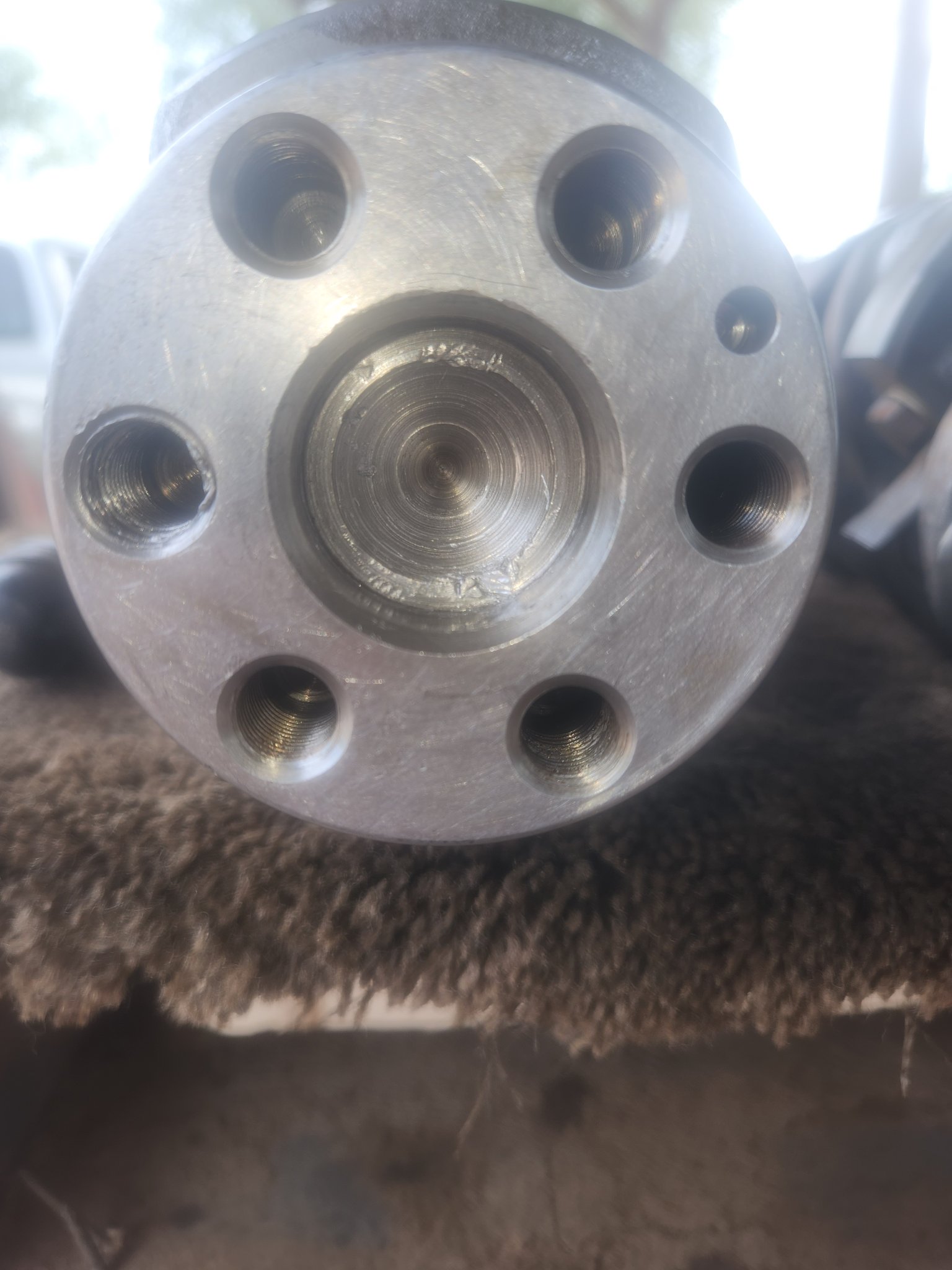

Crankshaft with less hours ready for bearing
Crankshaft with higher hours
Hit both areas with wire wheel in both directions, dip in diesel, hit with compressed air

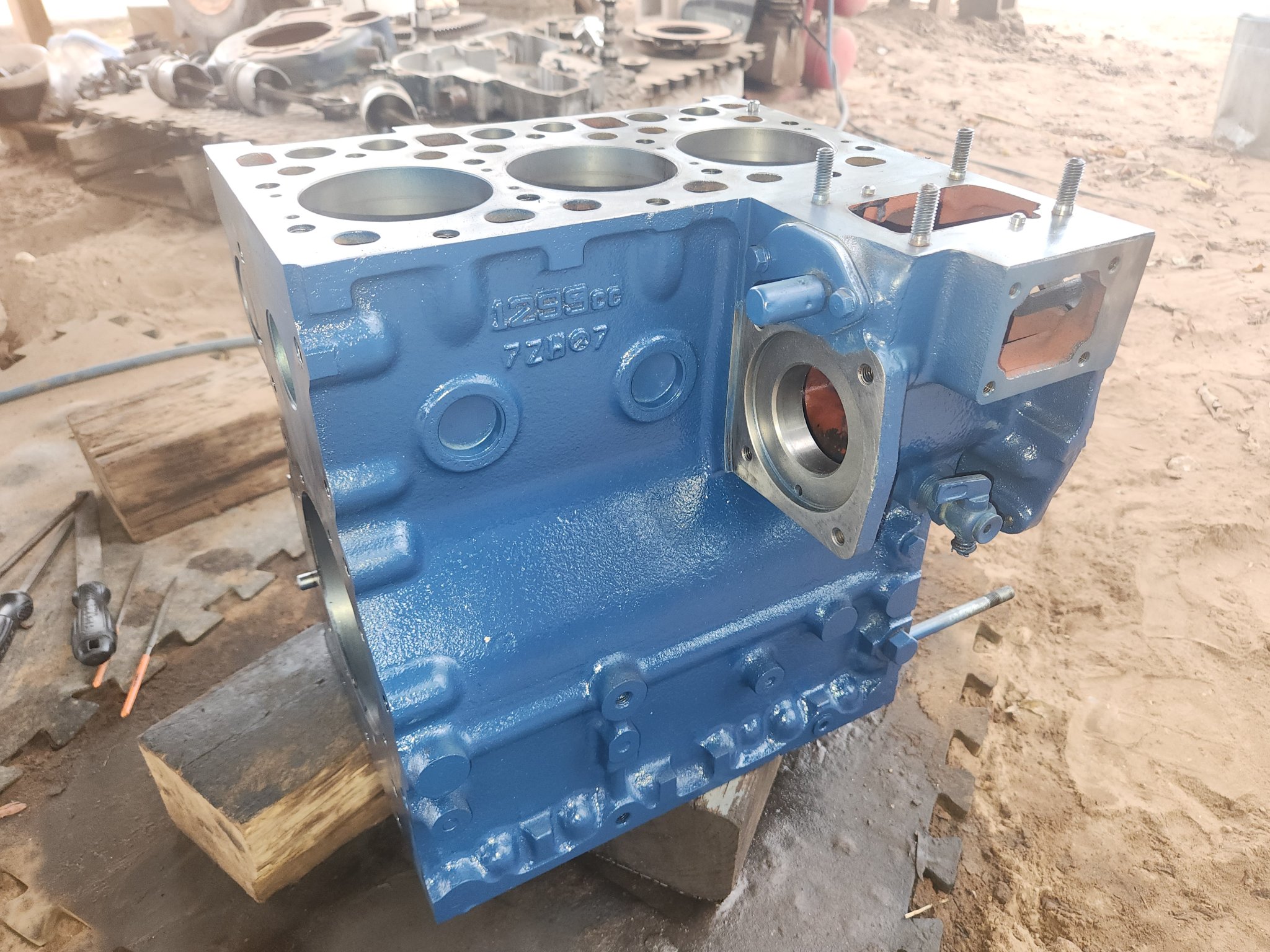

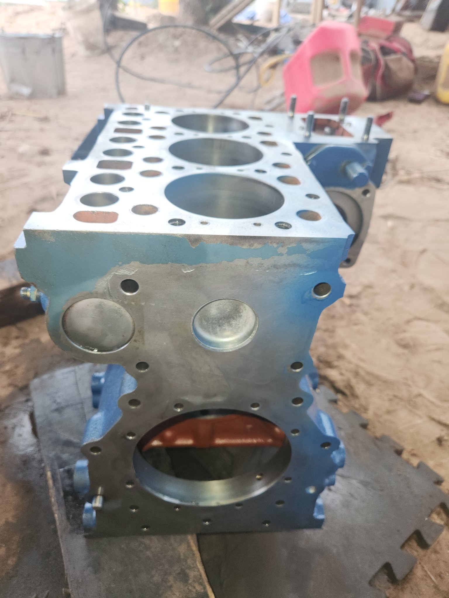

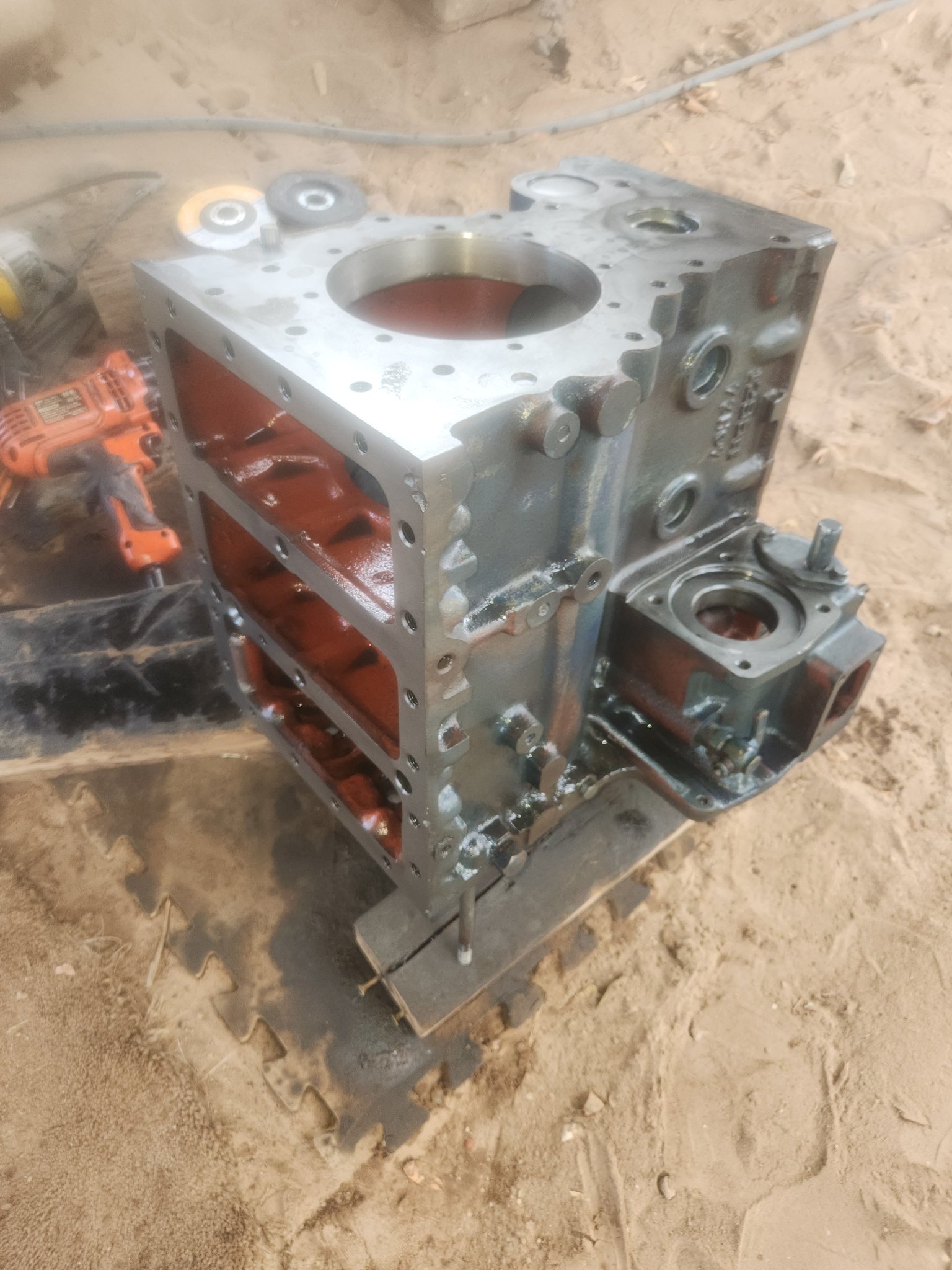

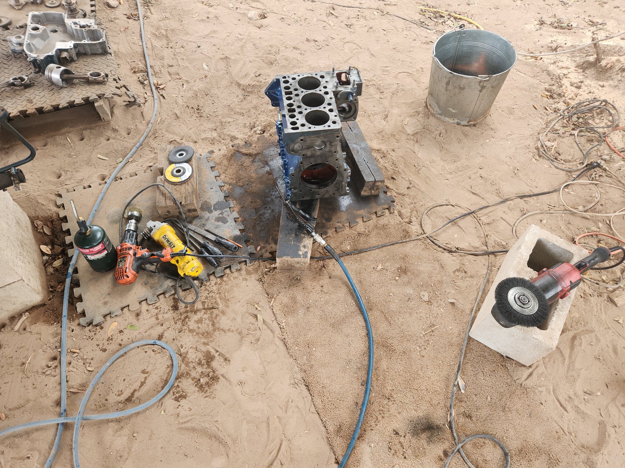

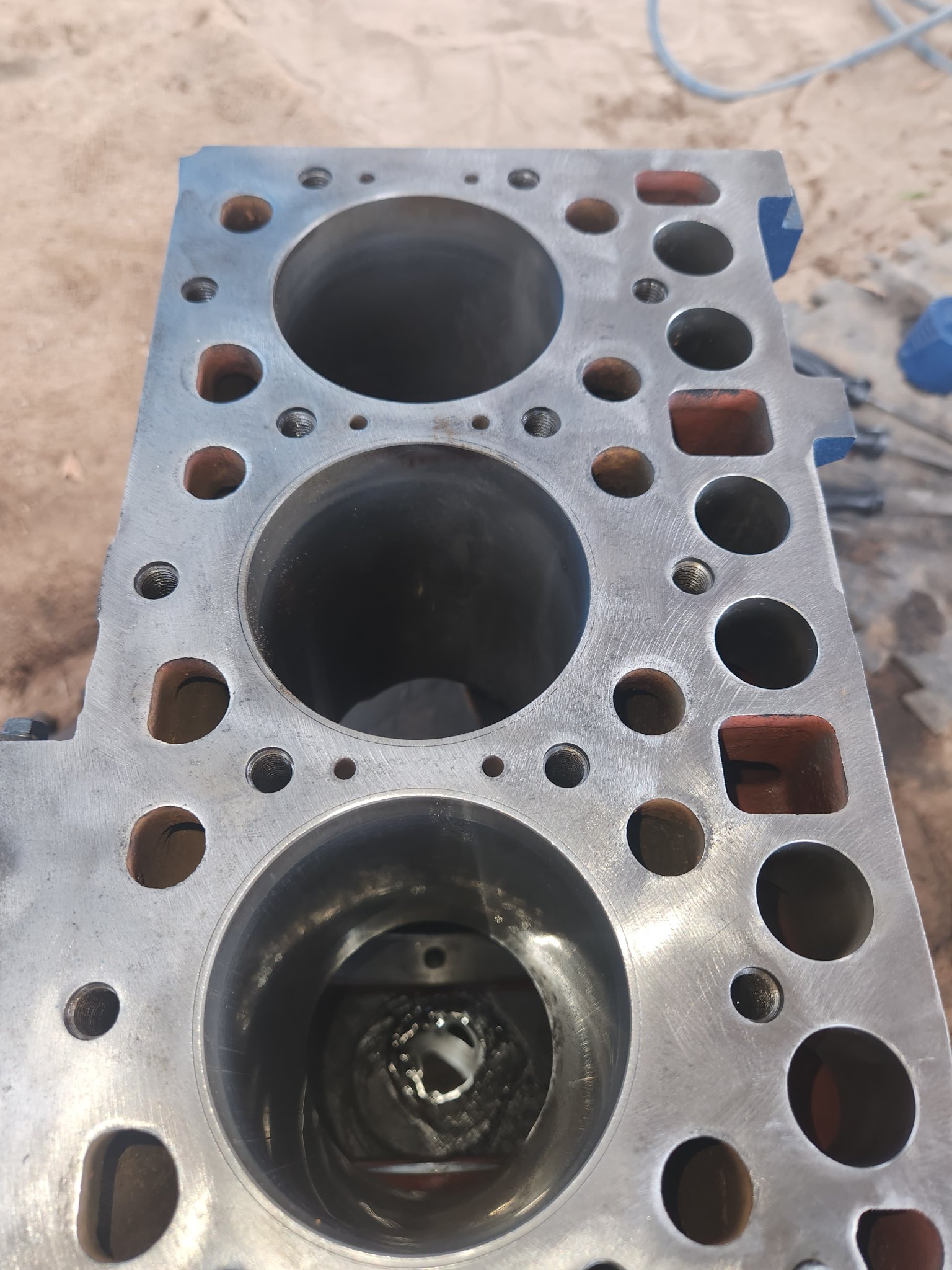

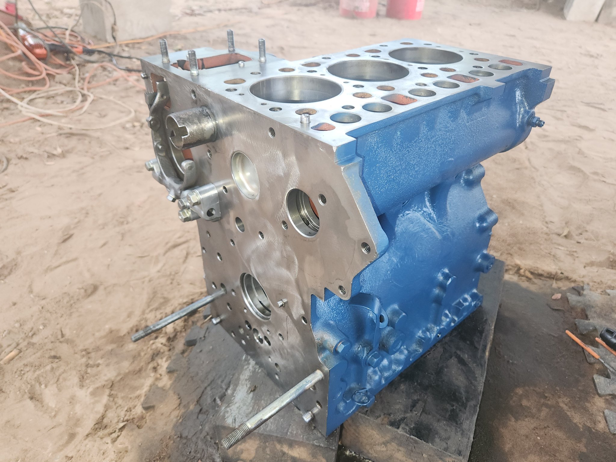

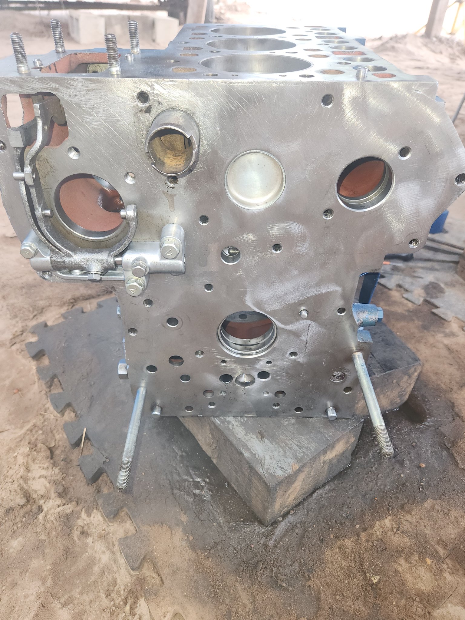

Gave block one last cleaning, painted opposite side of patch
Plained all flat surfaces with 80 grit flap, then 2800 rpm wire wheel
Removed all gasket material
Used files to get hard to reach areas

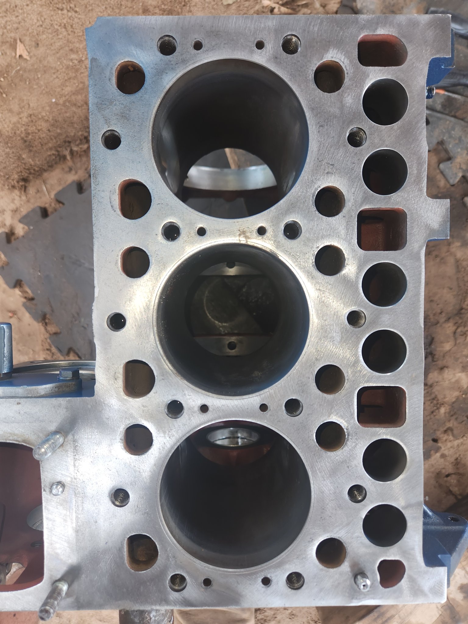

Hit cylinders with t shaped wire wheel on drill, spin both direction
Hit with compressed air then part cleaner
Propped up opposite side of block to paint, hit with compressed air then alcohol
Spray matching paint

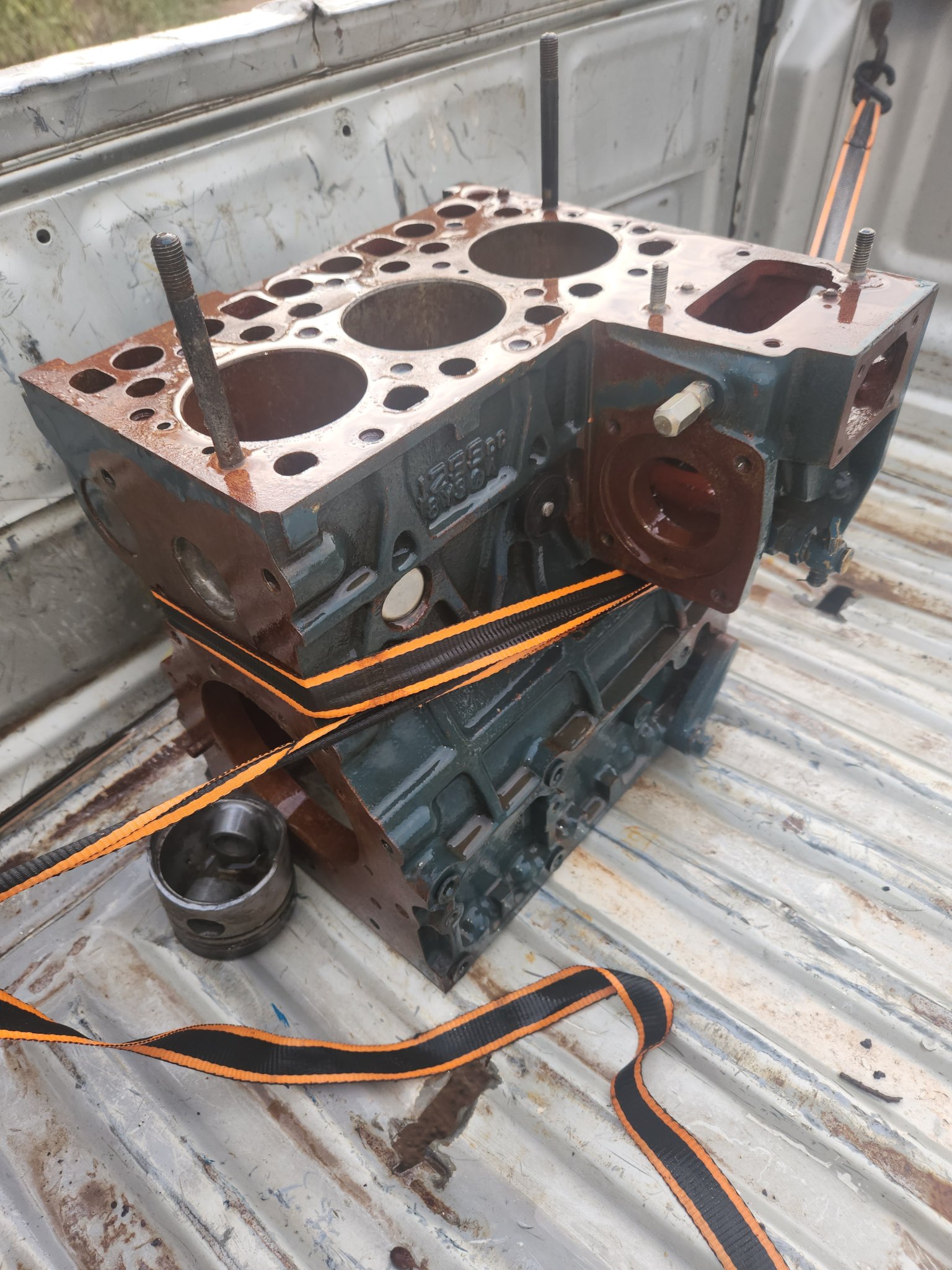

Since there is nothing left to do on block with hole in it, shift focus back on other block that need milling job
Plan: take to machine shop in person, offer to pay the shop rate plus $150 tip if they can get it done within a month
It would be nice to put them back together at the same time, using the same tools, same diagrams, same hardware
The engine is worthless disassembled, but worth big cash on the machine running

You put wire wheel inside the cylinders????🫨

I think I'd like to see a straight edge posed in various locations across the deck.

Shouldn't deck be square and plumb since he "Plained all flat surfaces with 80 grit flap then 2800 rpm wire wheel"? 🤭
That block had such little wear, i cant find anywhere on it to clean.
It only had 600 hours, thats only 6 oil changes
The reason why it popped a hole in the block: it must've sat for a decade or 2 without starting once
Then once it was started again, parts were seized and damage occurred
Not only are you seeing the pictures, but you are reading my narration, I am honored
problem is finding a machine shop that CAN do it right.
There are very capable machine shops that can mill the liners, its just that I am a nobody and cannot get their attention

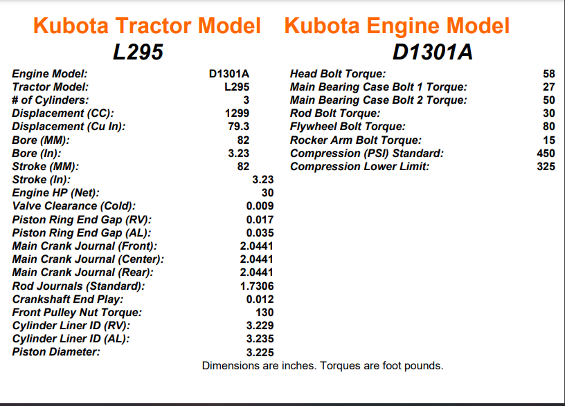

I keep having to find this, give this to machinist when giving block
3 things to give machinist: block, piston, and that sheet

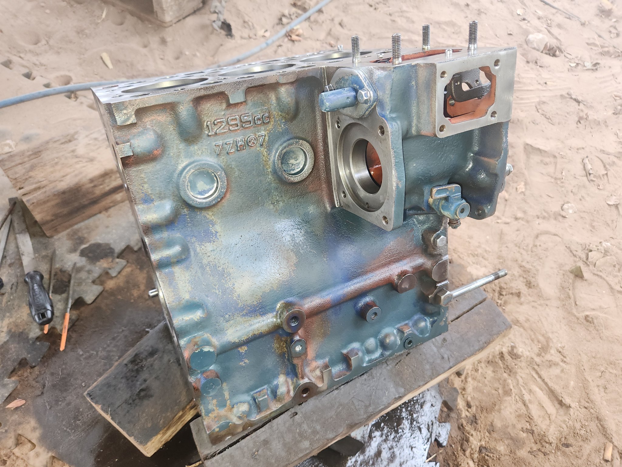

Dirty block been sitting out getting wet
Washed block with free rain water
Now: go to machine shop and stick to narrated plan
Yes I wait now for library to open, print out 10 of those sheets
That way, I hand the machinist everything in one shot, no need for him to look up specs, he'll have: clean block, spec sheet, and a broken piston as reference AND the $150 cash tip if completed within a month

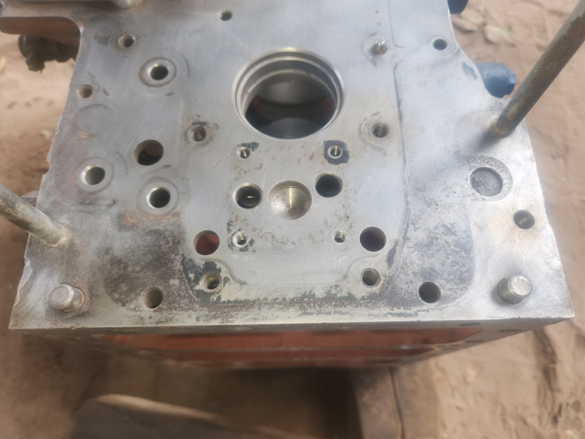

Showing you up close the milling required on two cylinders
