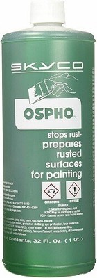

After getting all loose rust off of everything use something like this. Spray it on with a spritz bottle, let is set for a couple of days and you can paint right over it. It stops rust!! I buy it by the gallon. Ospho was designed to protect metal on ships.

Yes, I'll take some today or tomorrow! Thanks to all for the tips. For the rust I have a bucket of corroseal around here somewhere, but I'm interested in this Ospho stuff. On the starter, there's a bunch on amazon for $80-100 and I wasn't sure if I should try it. Worst case scenario I just use that casting from the new one and the guts of the old one I guess.
