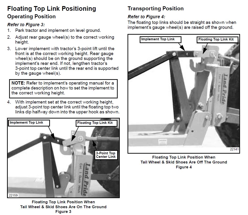

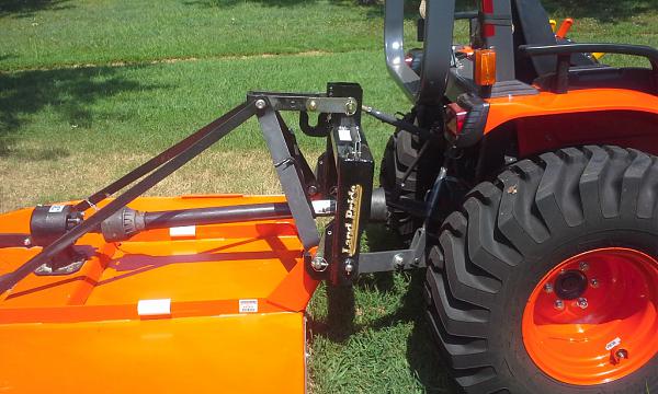

Here is the optional floating top link for the QH15. It, along with the floating Tilt cylinder keep me from scalping the pasture or even killing the engine by the blade digging into the dirt. I can go through dips both directions and the cutter floats right along.

the Land Pride cutters come with a floating top link already on the mower. We looked a long time at the adding hydraulics, and determined $3,000 was not worth it for our use to occasionally change an implement angle. I think they are great if you are using a grader blade
