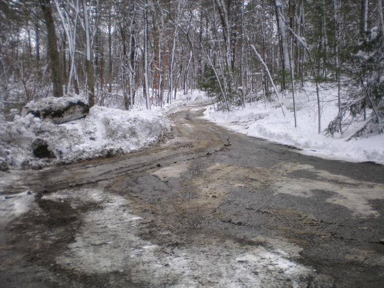

I've got a 1000' gravel drive with a steep hill and no matter how much you try to plow with the front plow you will dig up the gravel if it isn't frozen. I always say the two worst snow storms are the first and the last because the driveway is not frozen yet or thawed out for spring. I use my rear blade backwards as it can be angled and the mold board will push the snow away but smooth out the gravel in the drive.
